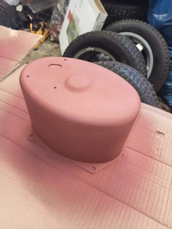

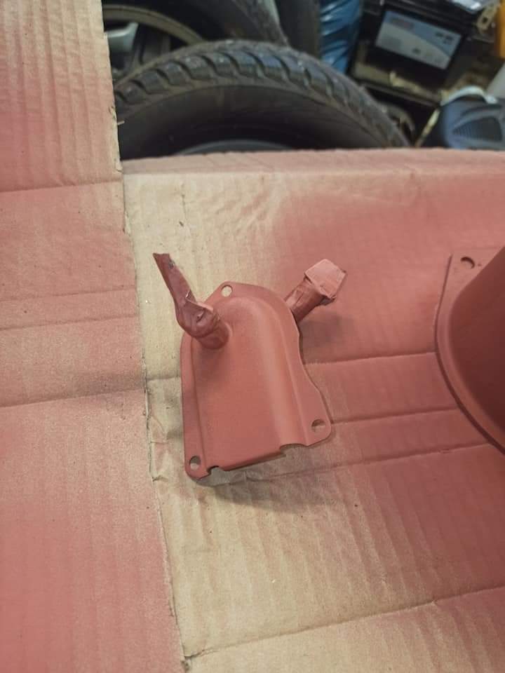

It was the hose on the inside that had jumped loose, pulled small hose clamps there .. all gaskets looked nice, then put on silicone grease again and put everything back in order.
Primer on and then black paint
