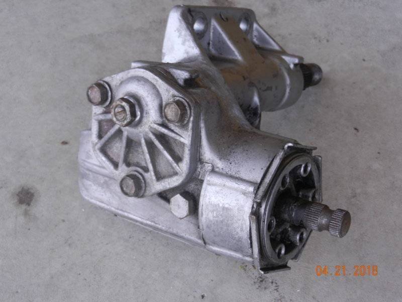

My 68 A body was a menace on the road when I first got it. The steering was so bad I was constantly correcting the wheel just to stay straight. Instead of rebuilding the steering box iI found an after-market one that cloned the original. I eliminated the steering coupler and replaced it with a universal joint connection. I worked on these cars when they were in everyone's driveway and recall the steering play. The universal joint made all the difference in handling. Fun to drive and handles great!!
Note: Not to mention the original couplers are known to pop out on hard turns. There's only a plastic pin holding the shaft from sliding up and down and they break usually within the first few years of production. The coupler locks it in place.

Ok...You have excessive play in the wheel. There's a nut on top of the steering box with a screw in the center. Loosen the nut and take a screwdriver and turn the screw clockwise until you start feeling it getting slightly tight. (Do not over tighten). On the road after making a right or left hard turn the wheel should return on its own towards the middle.
Its the nut and screw in the middle you want to tighten but not over tighten

If tightening didn't work the worm gear assembly is bad. You could take it apart and rebuild it or just buy another one. I did buy mine on Ebay for $295.95 manual steering. Its been working great since 2015.
