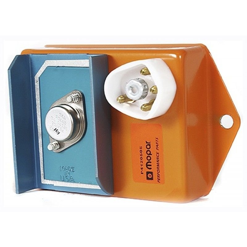

Question: Does it run one of these?
my fury wouldn't start and would die if this thing wasn't grounded/seated correctly. used to give me fits. i finally bared some steel and it never gave me an issue again.

It does and I have made sure that it's grounded as you suggested. Thanks for the tip!
Thank you all for your suggestions. I've made sure all grounds are tight and making good clean contact to bare metal. I've also tidied up a few questionable wires and their connections in the hopes that helps. So far so go, the car has been firing up every time since.
