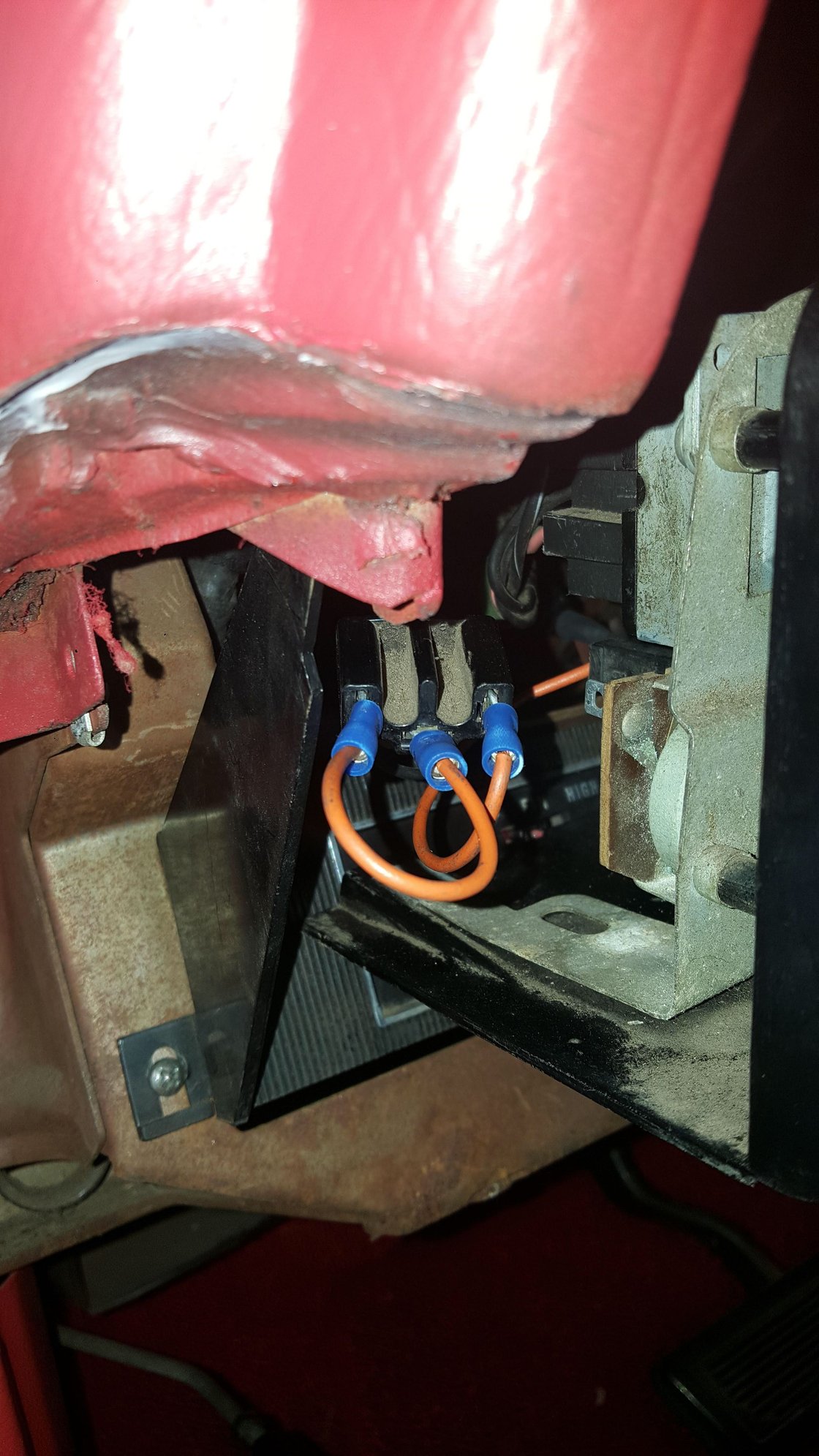

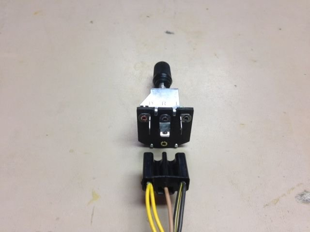

The dimmer switches are notorious for going bad. There is a tightly wound wire coil in there that gets corroded. You can buy a restored one but I don’t think they are reproduced. The best thing in my opinion is to just bypass the switch with a small jumper. The dash lights will remain in their brightest position when the headlights are on. Which is best anyway. I will try to attach a couple of pics.

Why would a faulty dimmer switch cause the front and rear running lights to stay on constantly? Even when the car is turned off? Also it's a brand new switch.
