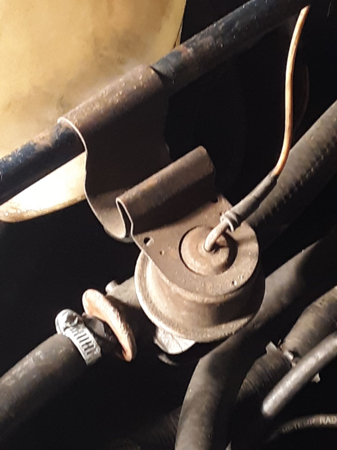

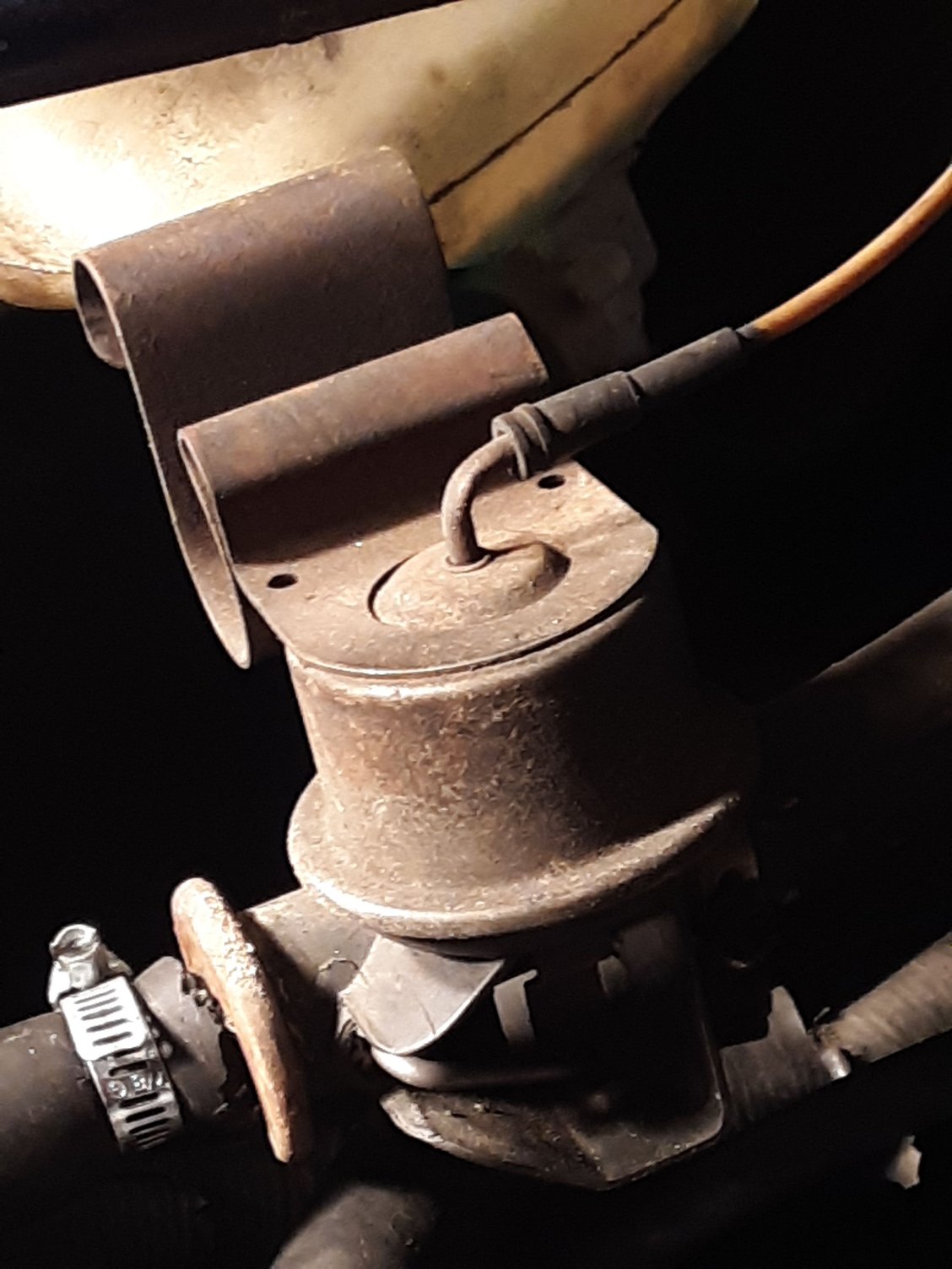

1977 Dodge Aspen 2 Door Coupe 225 3.7 Here it is looks like it is original equipment. I will find another one and just replace it I guess.

The entire housing including the control lever that the rod attaches to is rotted out I will just get another one and go from there. Rust is always the worst enemy on these old vehicles looks like. Thank You
