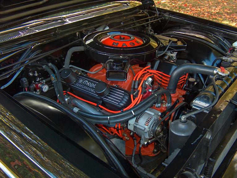

I installed a Denso on my 383 block. 95 amp, 3 wire although you don't have to use the charge light wire. Fit perfectly and very compact. Had no problems in the last 3 years. Make sure what ever you buy to keep the pulley in mind - I ordered mine with a v-groove but you can get serpentine as well.

Looks great, my unique concern is that if a GM case style alternator will fit on a stock mopar alternator bracket, does it fit?

No, not without mods. It's because of the mounting tabs which have to be a certain orientation for direct mounting ie: 180, 120 etc degrees apart. Also the depth of the unit may be an issue for fit and aligning the pulleys.
