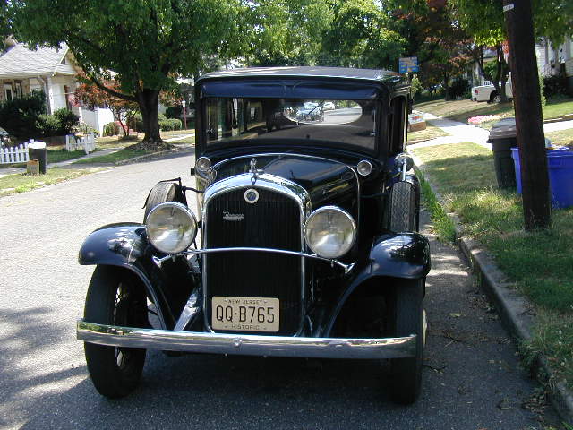

am restoring a 32 PA plymouth---my brake wheel cylinders are pitted,,,,Wagner used to make them new,,,,,doint think they still do,,,,considering resleveing----Apple charges $ 50.00 if you reasemble white post $80.00 would rather find NOS looking for sugestions----bobnroman@yahoo.com
