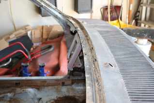

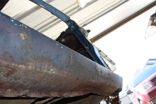

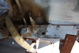

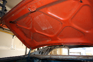

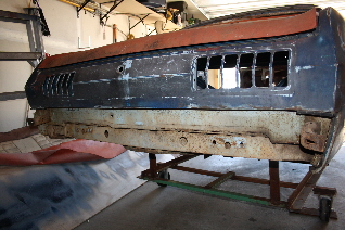

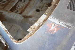

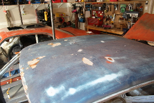

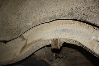

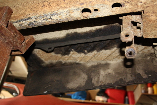

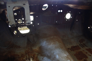

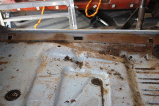

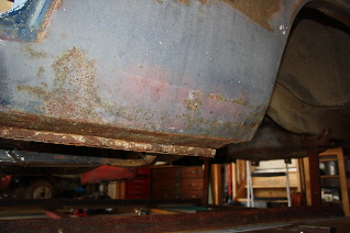

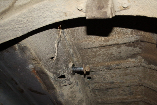

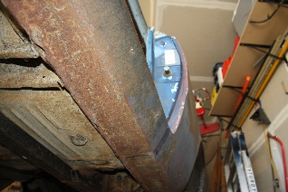

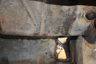

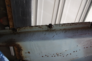

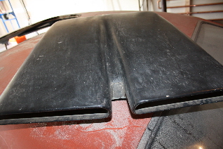

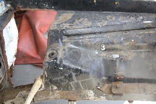

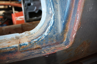

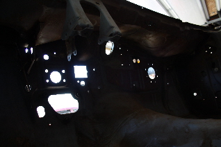

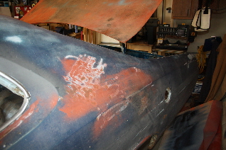

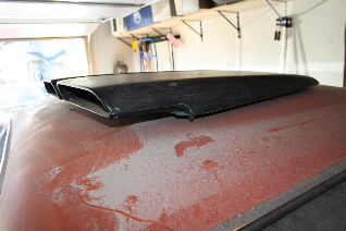

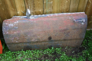

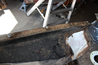

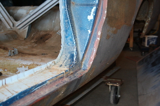

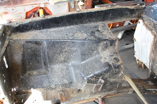

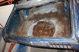

72 Demon Pics

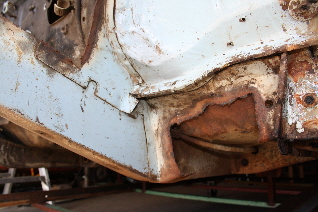

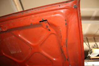

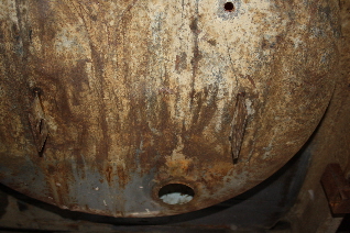

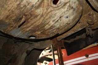

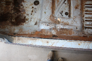

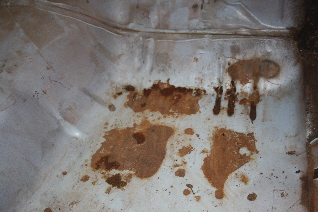

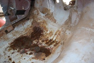

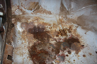

I took pics of most of the trouble spots, and I'll start by taking the windows out, putting the car on a rotiserrie I have borrowed, and removing the suspension. From there I will start with the stripping.
Because I am replacing so much of the metal(rear quarters, rocker, trunk exts. partial floors, front inners, and glue in patch on the ugly sunroof), I will not do a media blast. I have picked up a 5hp 18.5cfm@100psi compressor and I will sand, buff wire wheel and pressure pot blast the car in areas I can't reach. I will probably wish I sent it out for a media blast by the time I'm done but, I am in no rush and by saving the 2K on blasting I was able to get a decent compressor that I needed anyways and will go that route. I will post updates as I go. It will be a slow start as I am a maintenance welder for a large chemical manufacturing company and they are about to do their biggest shut down in their history $150Million. So I have just started working a 6/10's schedule from now until June. That should help with the build though. As this is my first resto I am open to any suggestions and welcome your thoughts. I have a Chassis and Body factory service manual that I was able to find on ebay so I think that is a good start for reference material
Not sure yet as to which motor I will put in it (still like the BB idea) but there is only one direction to go with the body and I'll start there.
Wish me Luck!

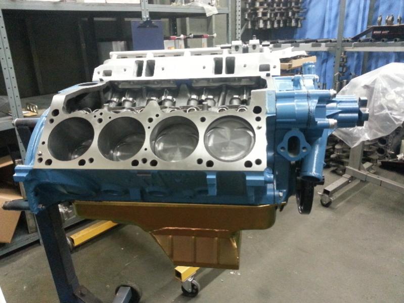

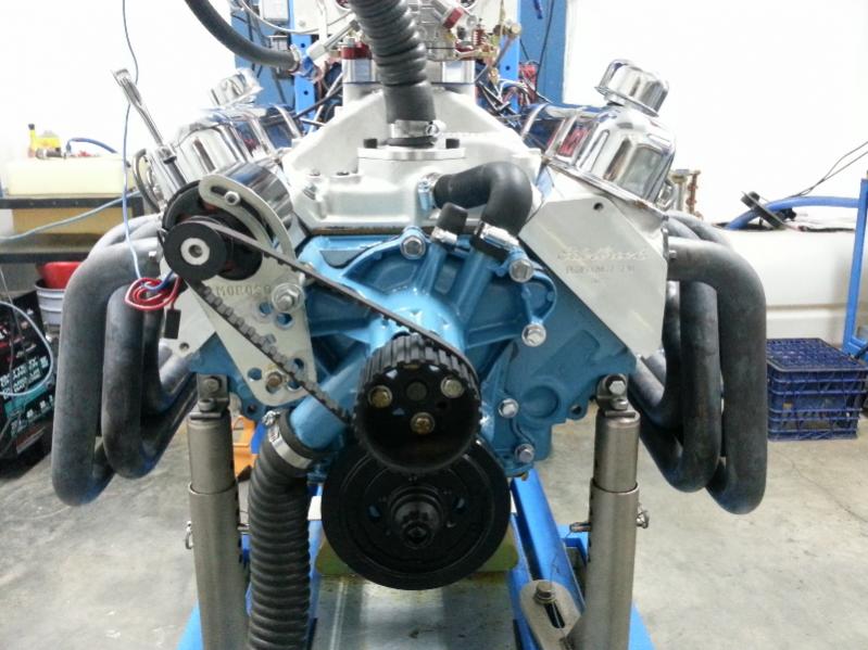

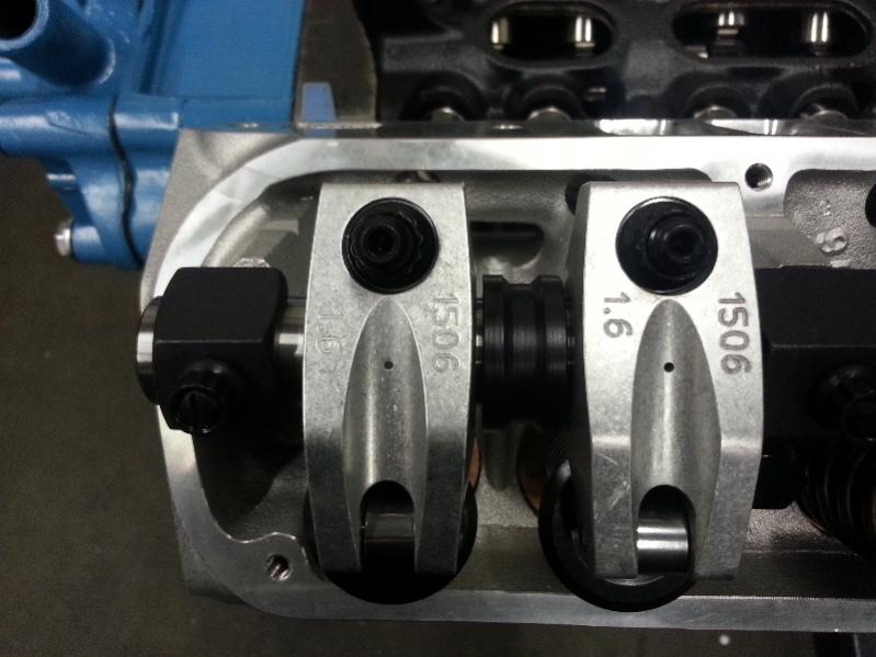

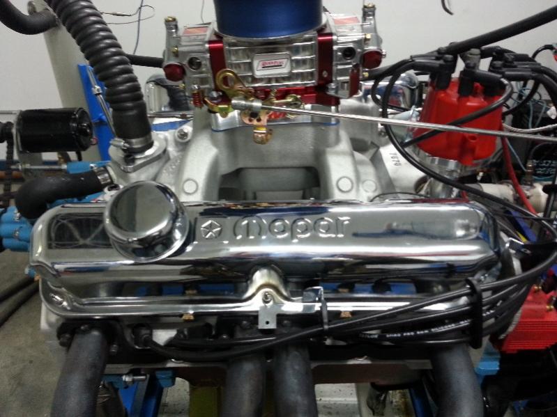

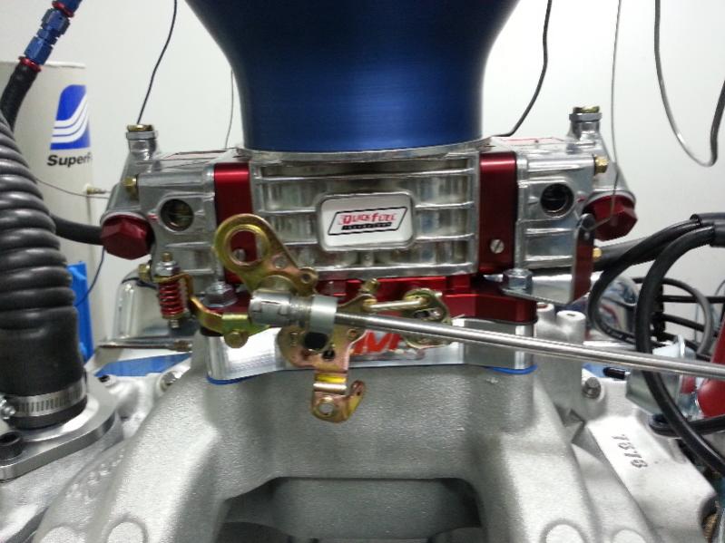

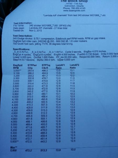

Hi all, Sorry for the big delay on the project, Lots has happened in my life in the past 6 months so I'll keep it short but sweet.

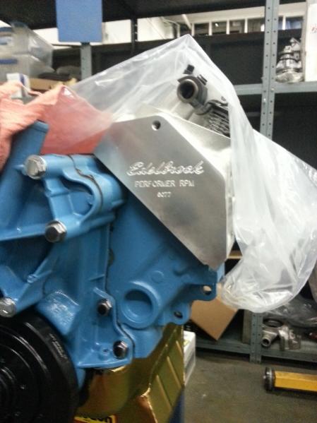

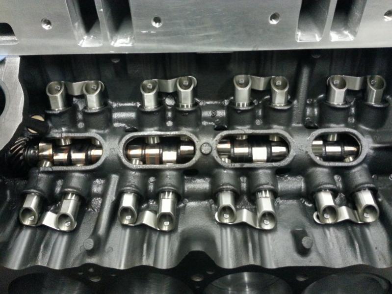

I moved and changed jobs which totally set me back on the restoration. I did however aquire a second 340 Demon body in the process which is lightyears better as far as the sheetmetal goes than my first one. I need both to make a complete car though so its all good.
I also located a 340 block and had a stroker built out of it in the past six months. Due to the overtime I've been working I had the whole thing farmed out to a reputable engine builder. They did a fantastic job for me and I'm very excited and motivated to get going on the body now that the engine is complete. In the Dyno it made 473Hp with 513tq at 4500 rpms.
I can get specs for anyone interested but off the top of my head I can tell you that it is a .030 over 72' 340 block, Milodon deep sump oil pan with Melling high vol oil pump, It has a completely forged bottom end stroker assembly with 9.75:1 compression, Roller Cam,Lifters and 1.6 roller rockers, Eddy heads, RPM intake, and a 750 quickfuel carb with a one inch spacer. Thats it in a nut shell. I'll try and post a few pics of it and the second Demon asap.
I'll be getting the car on the rotisserrie in the next few weeks and as I progress I'll keep you all updated.
Cheers
Last edited by Newf Wit a 440; Jan 26, 2013 at 06:20 AM. Reason: torque was at 4500 not 5600
Old Jan 25, 2013 | 09:34 PM
Alright
Old Jan 25, 2013 | 09:37 PM
Newf Wit a 440's Avatar
Joined: Nov 2011
Posts: 122
From: Great White North
here's a few engine pics
Attached Thumbnails 72 Demon Resurrection-20121012_095258.jpg   72 Demon Resurrection-20121012_095318.jpg   72 Demon Resurrection-20121102_072220.jpg   72 Demon Resurrection-engine-pic-340.jpg   72 Demon Resurrection-engine-pic-341.jpg
72 Demon Resurrection-dyno-day.jpg   72 Demon Resurrection-quick-fuel-carb.jpg   72 Demon Resurrection-print-out-dyno.jpg

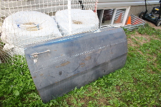

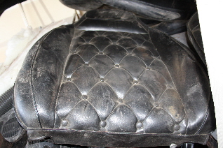

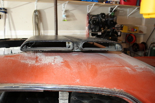

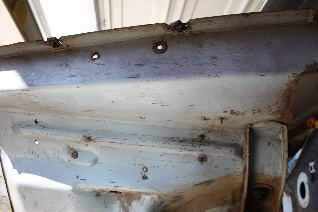

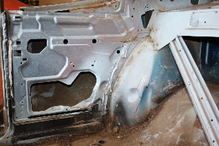

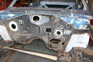

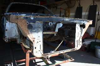

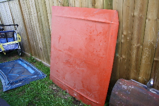

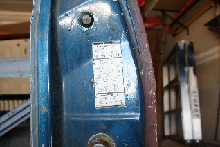

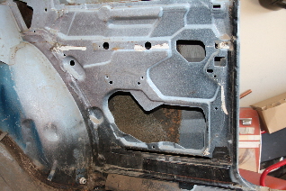

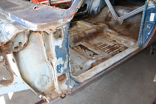

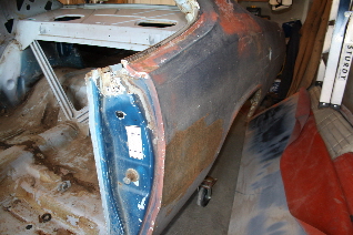

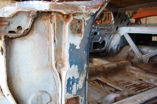

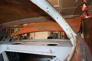

Here are some pics of the second Demon body, not perfect by any means but better than the first and for $1000. This was also a 340 original but column shift and not as good options as the first. It also came with an extra trunk lid. 71' I think as it has mounting holes for the wing and correct me if I'm wrong but I don't think the 72' had that option.
Attached Thumbnails 72 Demon Resurrection-ghj.jpg   72 Demon Resurrection-img_7003.jpg   72 Demon Resurrection-img_7005.jpg   72 Demon Resurrection-img_7006.jpg   72 Demon Resurrection-img_7009.jpg
72 Demon Resurrection-img_7010.jpg   72 Demon Resurrection-img_7011.jpg   72 Demon Resurrection-img_7012.jpg

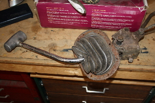

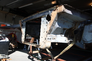

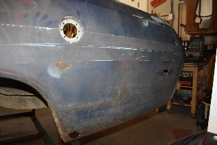

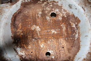

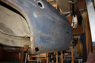

more pics of second car body
Attached Thumbnails 72 Demon Resurrection-img_7004.jpg   72 Demon Resurrection-img_7013.jpg   72 Demon Resurrection-img_7014.jpg   72 Demon Resurrection-img_7015.jpg   72 Demon Resurrection-img_7016.jpg
72 Demon Resurrection-img_7017.jpg   72 Demon Resurrection-img_7018.jpg   72 Demon Resurrection-img_7019.jpg   72 Demon Resurrection-img_7020.jpg   72 Demon Resurrection-img_7021.jpg

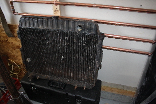

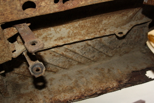

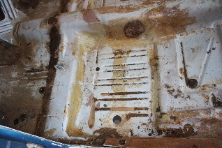

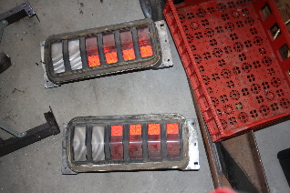

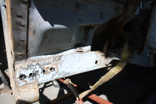

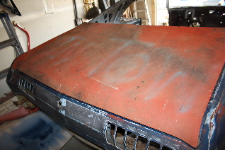

and some more pics
Attached Thumbnails 72 Demon Resurrection-img_7022.jpg   72 Demon Resurrection-img_7023.jpg   72 Demon Resurrection-img_7024.jpg   72 Demon Resurrection-img_7025.jpg   72 Demon Resurrection-img_7027.jpg
72 Demon Resurrection-img_7028.jpg   72 Demon Resurrection-img_7029.jpg   72 Demon Resurrection-img_7030.jpg   72 Demon Resurrection-img_7031.jpg   72 Demon Resurrection-img_7032.jpg

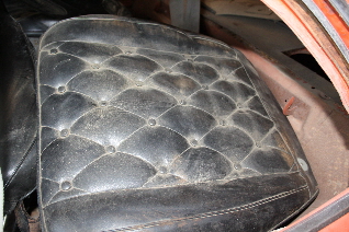

continued pics...
Attached Thumbnails 72 Demon Resurrection-img_7033.jpg   72 Demon Resurrection-img_7034.jpg   72 Demon Resurrection-img_7035.jpg   72 Demon Resurrection-img_7036.jpg   72 Demon Resurrection-img_7037.jpg
72 Demon Resurrection-img_7038.jpg   72 Demon Resurrection-img_7039.jpg   72 Demon Resurrection-img_7040.jpg   72 Demon Resurrection-img_7041.jpg   72 Demon Resurrection-img_7042.jpg

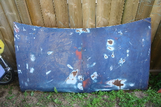

and a few more lol
Attached Thumbnails 72 Demon Resurrection-img_7043.jpg   72 Demon Resurrection-img_7044.jpg   72 Demon Resurrection-img_7045.jpg   72 Demon Resurrection-img_7046.jpg   72 Demon Resurrection-img_7047.jpg
72 Demon Resurrection-img_7048.jpg   72 Demon Resurrection-img_7049.jpg   72 Demon Resurrection-img_7050.jpg   72 Demon Resurrection-img_7051.jpg   72 Demon Resurrection-img_7052.jpg

and a few more
Attached Thumbnails 72 Demon Resurrection-img_7053.jpg   72 Demon Resurrection-img_7054.jpg   72 Demon Resurrection-img_7055.jpg   72 Demon Resurrection-img_7056.jpg   72 Demon Resurrection-img_7057.jpg
72 Demon Resurrection-img_7058.jpg   72 Demon Resurrection-img_7059.jpg   72 Demon Resurrection-img_7060.jpg   72 Demon Resurrection-img_7061.jpg   72 Demon Resurrection-img_7062.jpg

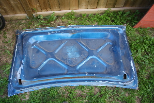

heres the last of the second Demon body
Attached Thumbnails 72 Demon Resurrection-img_7063.jpg   72 Demon Resurrection-img_7064.jpg   72 Demon Resurrection-img_7066.jpg   72 Demon Resurrection-img_7067.jpg   72 Demon Resurrection-img_7068.jpg
