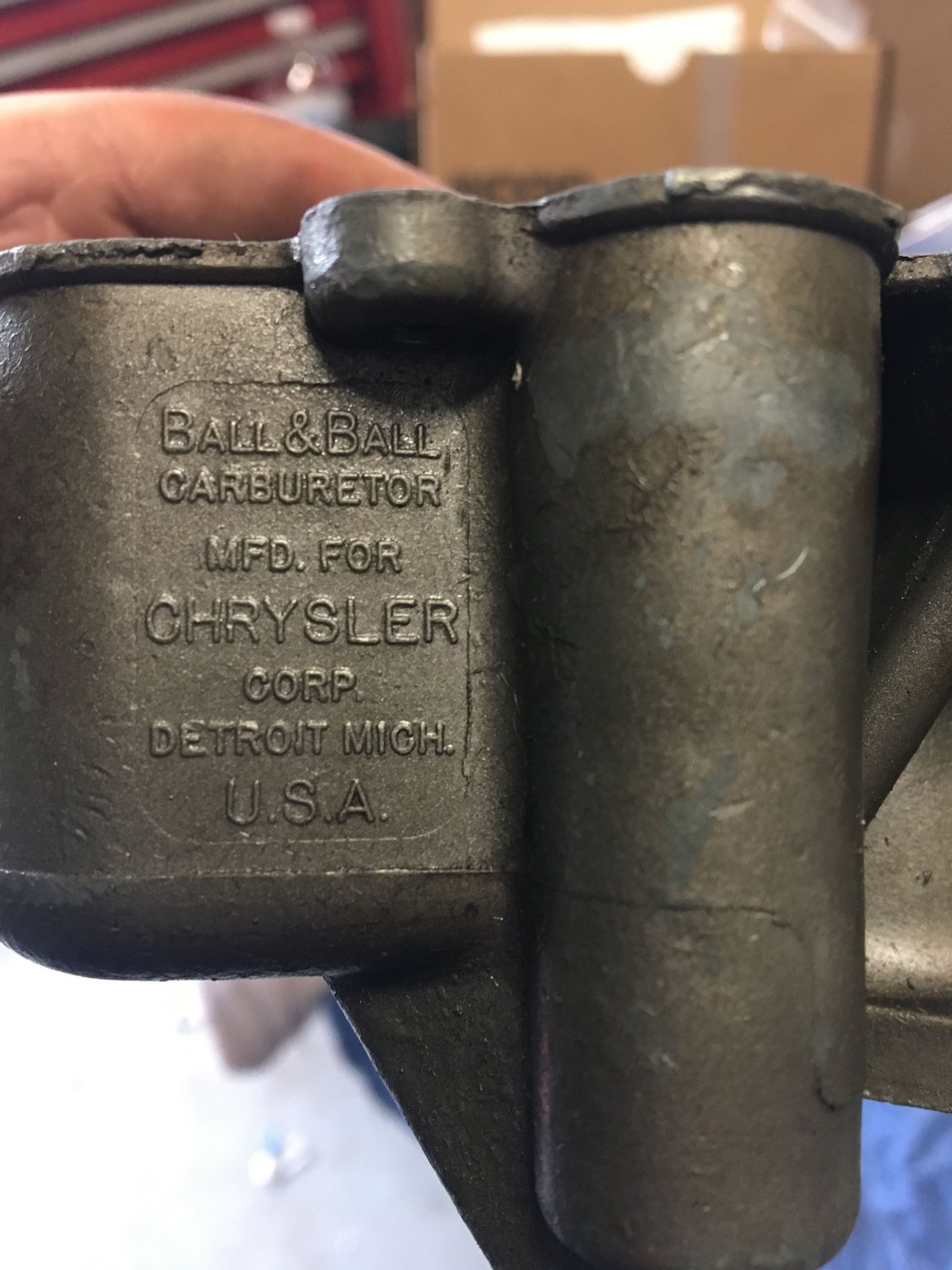

Hey guys, haven’t been on here in a while, so my carburetor is leaking from the bottom from the silver circle rivot looking thing in the picture. Anyone have any ideas as to why. Thanks in advance

What carb is it?

Posts: 15
B&B

See if this helps, scroll down and look at the videos.
http://p15-d24.com/topic/42269-carb-rebuild-kit/
Old Mar 31, 2019 | 07:37 AM
Fuel fines its way out if it can.... Carb shop might have a replacement plug. If you cant find one, Check with the Carb Doctor.com. If you have no luck, J.B. weld sealer of epoxy will seal it.
