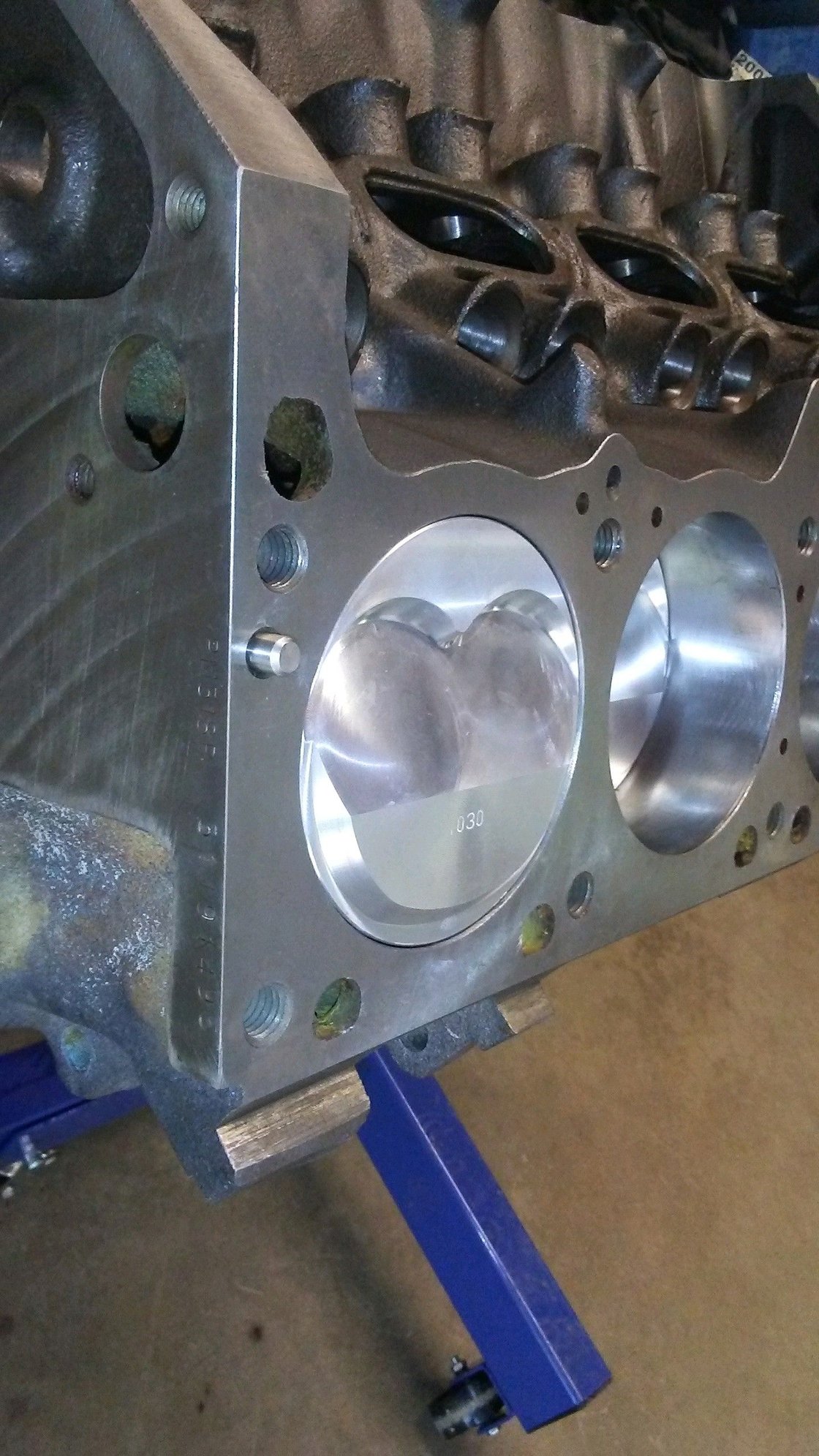

Hey everyone. Im new to the forum and as a result this is my first post on the site.
I wanted to share my current engine build that is a work in progress. It is a LA 318 with some high performance components.
74 318 LA Block
Bored 30 thousandths over
Milled to zero deck height, closer to positive deck height after machining, pistons stick out of the bore
KB 399 hyperectic dome pistons
Cast crank, turned and machined
ARP Main studs
ARP Head studs
360 J heads
Milled 20 thousandths
New valves
New valves guides
New seats
Ported, polished, gasket matched, no radical porting
Comp Cams roller camshaft complete kit
Cam Specs, .513/.498 lift
Advertised duration 283/303
107 LSA
Roller Rockers
Edelbrock performer intake
Summit Holley style 4 barrel, 600cfm, vacuum secondaries
Flowtech headers
This is essentially the entirety of build itself. Built to be an experiment to see how much power it puts out. Will be a street motor/highway driver in a 80s dodge halfton which has a worn 318 with core shift, dramatic cylinder taper and enough blowby that it could potentially turbo charge itself under the right circumstances. This will probably be the last high performance stock stroke small block I build.
Details on the truck
1984 Dodge w150 4x4 Shortbox
727 Auto Trans w/shift kit
~1600 stall torque converter
9.25 rear with 3.21 gears, 31inch tires
(Combo of trans, gears, and tires puts rpms at 70 in top gear around 2500 rpm)
Weight with driver ~5000-5200 lbs
Meant to be a highway driver/daily driver, don't need big block levels of low end torque with this particular truck. Any thoughts, or comments are welcome. Curious what it will put out for power, have a tentative dyno date set up at some point in the future after assembly.
