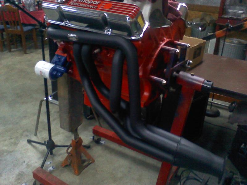

Got some parts in today,, the rest should be in tomorrow so I can put the engine in..

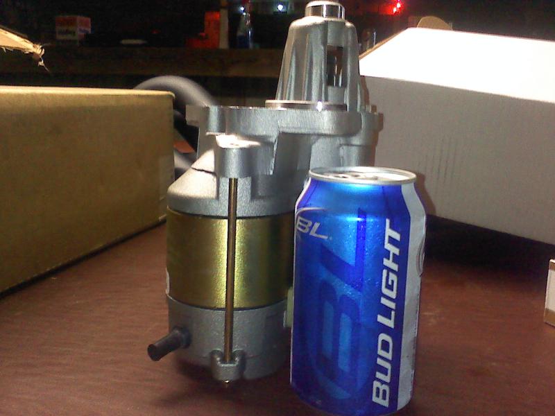

Hooker competetion headers 16 gauge 1 7/8 tube,, Mini starter
Attached Thumbnails 67 Coronet R/T Prostreet/Ratrod-v3.jpg   67 Coronet R/T Prostreet/Ratrod-v2.jpg   67 Coronet R/T Prostreet/Ratrod-v6.jpg   67 Coronet R/T Prostreet/Ratrod-v5.jpg

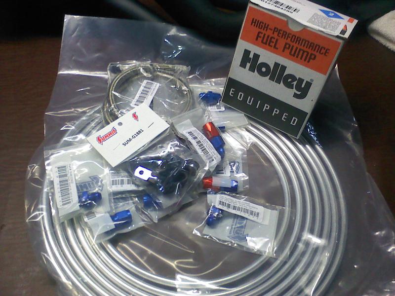

Tuff stuff one wire 100amp powder coated alt,, Holley pump and complete line kit from fuel cell to engine bay,, Also my favorite street fan with the best cooling and does not sound like a leaf blower going down the road like all non clutch fans. The Mopar performance Viscous fan.. I remember when I was younger, I always took the clutch fan off and stuck a flex fan on.. Dont know why, maybe I thought it was cool.. But the sound they make really sucks.. Just like those old s-10 blazers you here nothing but fan when they are going down the road.. LOL
Attached Thumbnails 67 Coronet R/T Prostreet/Ratrod-v7.jpg   67 Coronet R/T Prostreet/Ratrod-v1.jpg   67 Coronet R/T Prostreet/Ratrod-v4.jpg

Got the engine set in the car to night,, Not to fun.. First mistake buying 1 7/8 headers.. I only needed 1 3/4 but the 1 3/4 headers were 18 gauge thickness and I wanted the 16 gauge.. They are barley touching the torsion bar in 2 spots on the drivers side and one spot on the pass side.. It seems like if the engine was lifted 1 inch it would be perfect.. I guess tomorrow night will be rose bud on the torch and hammer time.. Atleast its on the bottom were nobody can see the handy work..
Attached Thumbnails 67 Coronet R/T Prostreet/Ratrod-v10.jpg

For anyone else out there considering headers for their RB 68-70 B-Body, I bought cheapy flowtech headers straight out of summit's catalogue and only had to clearance for the stock starter. Non-power steer, Non-power brakes, and column shift auto. Hope someone else finds this useful
Old Apr 24, 2013 | 03:40 PM
The only down fall is a shady flange and they are beer can thin..

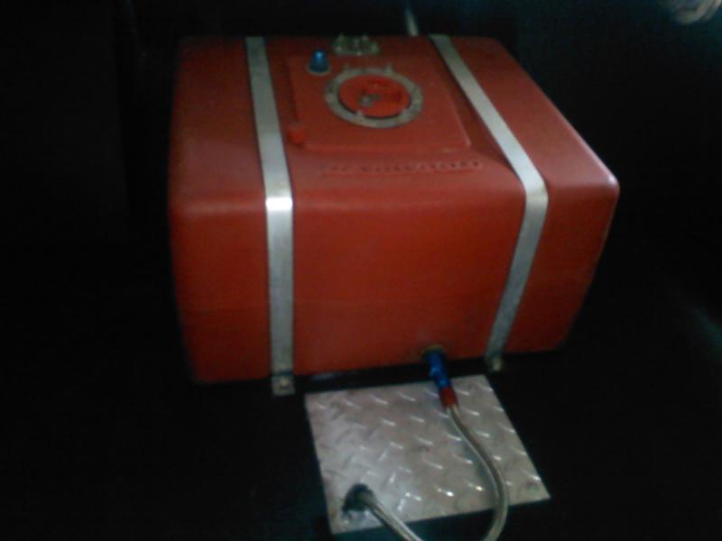

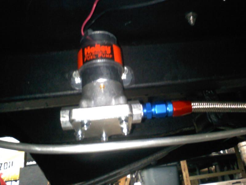

Started on the fuel system.. cleaned the fuel cell and got it mounted back in the trunk.. Ran new fuel line and mounted the pump, and mounted the fuel filter under the hood. I stuck it under the hood because thats were I am going to come off of for my carb supply. I went with the holley red pump because a regulator is not needed. It will supply enough fuel for my build.
Attached Thumbnails 67 Coronet R/T Prostreet/Ratrod-z6.jpg   67 Coronet R/T Prostreet/Ratrod-z4.jpg   67 Coronet R/T Prostreet/Ratrod-z8.jpg

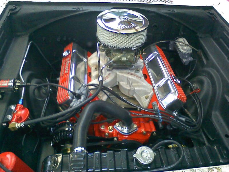

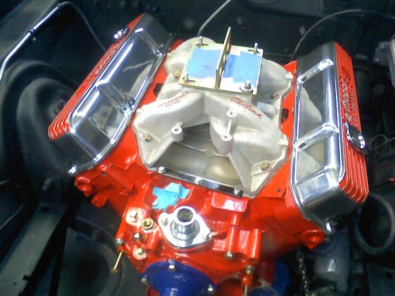

Got a few more things bolted on the engine, Gonna break the engine in on a single carb before I add the tunnel ram.. The last thing I want to do is to be screwing with carbs tring to start and break-in a new engine. Runnig a hyd. cam not roller..
Had my tunnel ram ceramic coated and got it back last week. Also I got a 2 quart bigger trans pan.
Attached Thumbnails 67 Coronet R/T Prostreet/Ratrod-z7.jpg   67 Coronet R/T Prostreet/Ratrod-z3.jpg   67 Coronet R/T Prostreet/Ratrod-z2.jpg

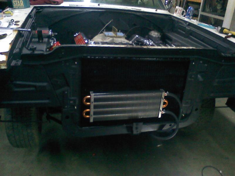

Few more things added tonight, finished the fuel system added the one wire alt. and power steering pump, mopar fan, new trans lines and installed the radiator. I also installed a big trans cooler. I run a big cooler so I do not need to run the fluid threw the rad.
Attached Thumbnails 67 Coronet R/T Prostreet/Ratrod-z10.jpg   67 Coronet R/T Prostreet/Ratrod-z11.jpg   67 Coronet R/T Prostreet/Ratrod-z9.jpg

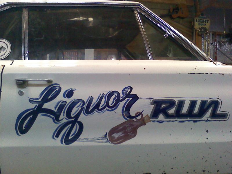

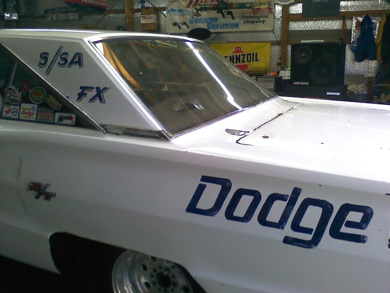

I had my car lettered up like a old drag car today,, I thought being I was going with that old shool look it would be cool. All hand painted
Attached Thumbnails 67 Coronet R/T Prostreet/Ratrod-z18.jpg   67 Coronet R/T Prostreet/Ratrod-z17.jpg   67 Coronet R/T Prostreet/Ratrod-z20.jpg   67 Coronet R/T Prostreet/Ratrod-z21.jpg   67 Coronet R/T Prostreet/Ratrod-z19.jpg

I HAD THE GUY PAINT IT LIKE IT WAS ON THEIR FOR 30 YEARS

I like them!!!!!!!! No I love them.... They belong on this ride!!!!!!!
