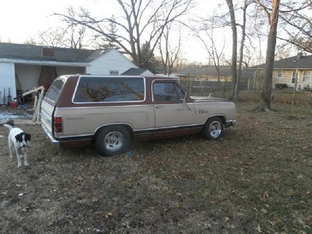

There weren't many 74-80 2WD made Here's my old 84 2WD I'd sit the early model on this frame You will gain a 35-6 gallon gas tank along with 2WD

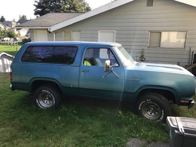

Old thread, I know, but adding in case someone in the future wants to know.
Yes, there were 2WD RC's made. I have a 77. The pic below is mine with a 3" body lift that will be removed.
Also, the Ramchargers were made with a D100 frame shortened 9"

I have no idea what brand lift is on it or how long its been on there. I just bought it a few months ago. I can say that it is a body lift of 2-3 inches. It is a 2WD that I plan on bringing back to stock height and then using B series van lower front control arms to drop the front 2-3 inches. Ramchargercentral.com doesn't have much information on 2WD front suspension, so I thought I would mosey over here and see what's what. lol
