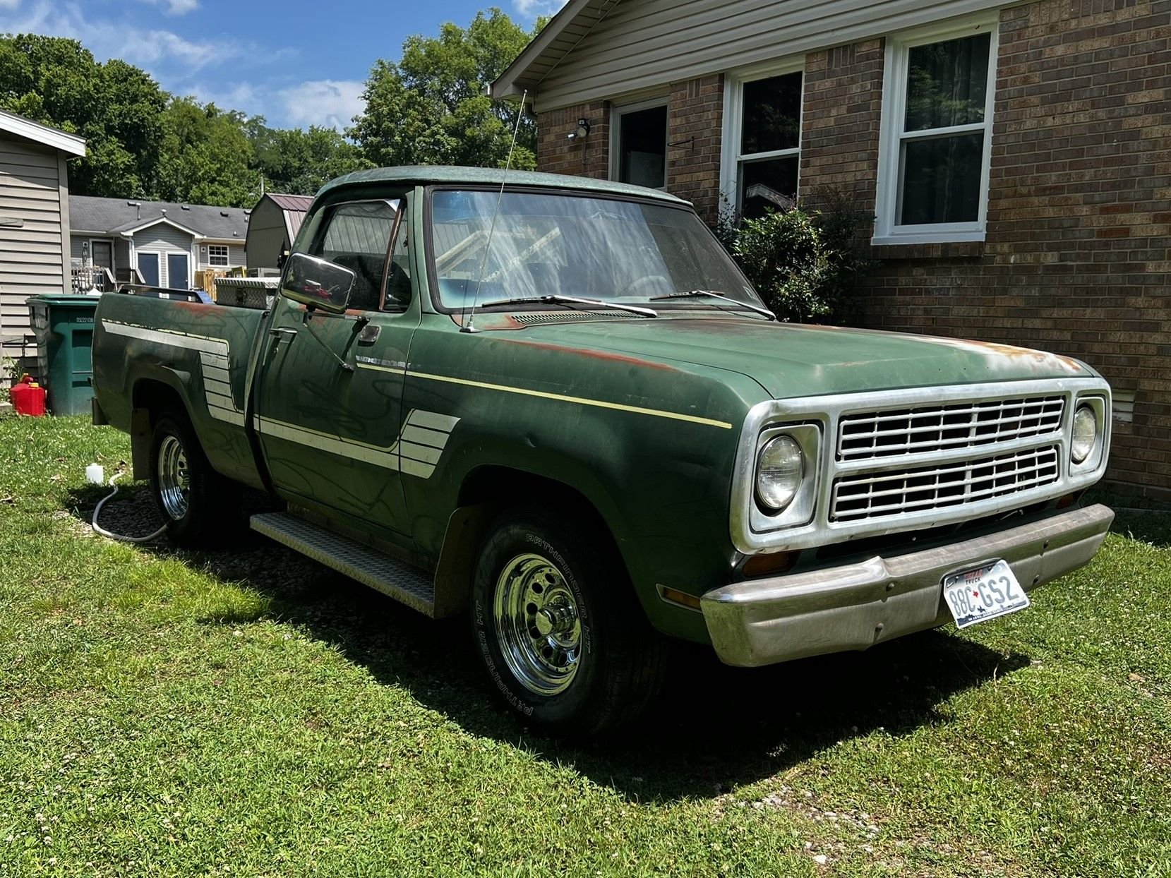

Howdy, I have been following the forum for a while and I just started on my project.
1979 D100 Custom. My father purchased the truck in September of 79 and was my daily driver from 1984 until I parked it in 2005.
I just put some tires and wheels on it so I could move it around. This will be an experience since I do not have a garage, and I am way too old and fat to be working in the dirt, but it is what it is.
I am starting on the Front driver's corner. Ball Joints, shocks, bearings. Using B100 lowers to drop the front 1.5 inches.
45 years of weather is making it tough.
I am sure I will be on for help and questions!
Thanx for reading.
How it sits right now!

Body looks pretty solid after all those years. Good luck!!
