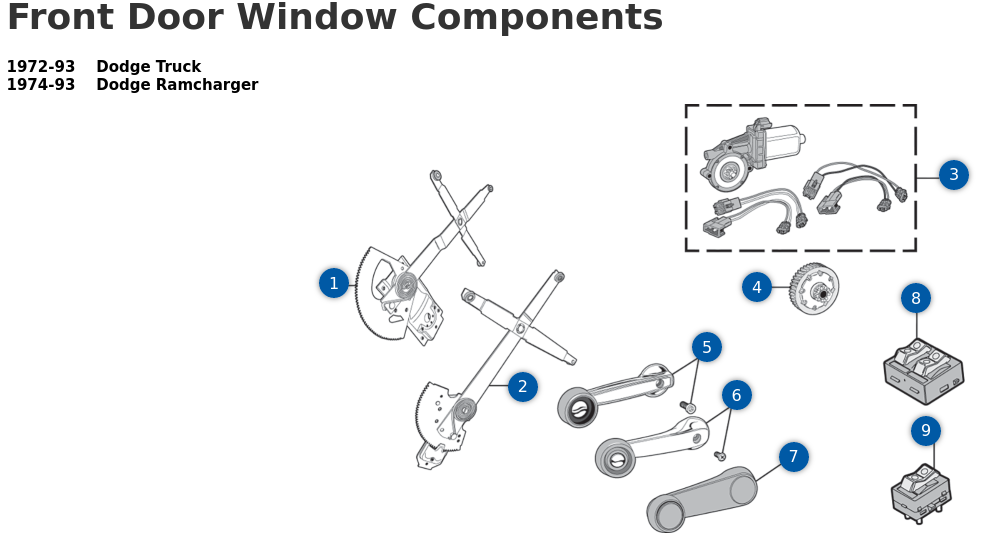

I have a 82 D150 and it currently has motorized windows that have bad motors, would rather have hand crank windows. Are the motor assemblies able to be swapped out with a hand crank?

The window regulators are different between Hand and Electric power windows.
According to LMCTruck anyway...

They are indeed difference, I have crank windows and needed to replace both regulators..... I could find electric ones all day long, finding manual ones.... yeah, that was a treasure hunt that eventually involved calling a dozen or more junk yards until I found a pair.
If making the swap to manual, you would also need a pair of new door panels I would think, I can't picture where the holes are for the electric switches, but would be surprised if they match the hole position and shape of the manual panels.
