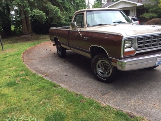

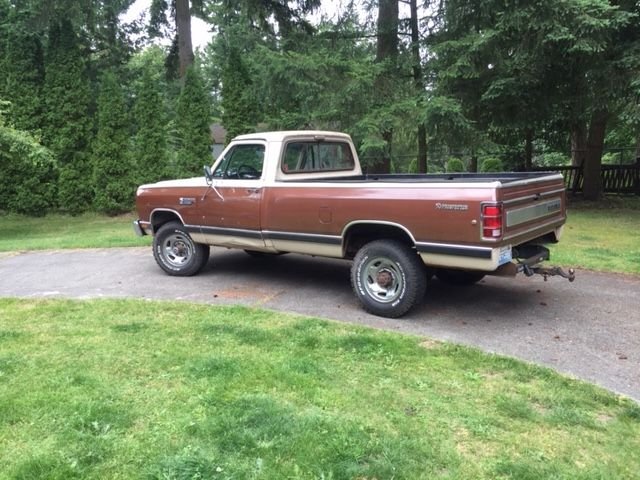

Now, I need to find the time to give it a good bath, inside and out. The speedo reads 89,000 miles and I think that is the first time around. The only body damage is under the drivers door. There are not even any door dings to speak of, just a few scratches here and there. The paint on the hood appears to have been just worn off. I will start looking for a rear bumper when I get a minute.

Old Jun 23, 2019 | 04:13 PM
That's a clean old truck!👍

Iowan,
Thanks, I think it will do all I need. It will be used for an occasional driver and light hauling when the weather permits. I have an enclosed trailer for those Seattle damp days. I might just clear that hood to keep the patina. I need to find the chrome for around the windshield, the ram hood ornament, and rear bumper. I haven't even looked for them yet.
