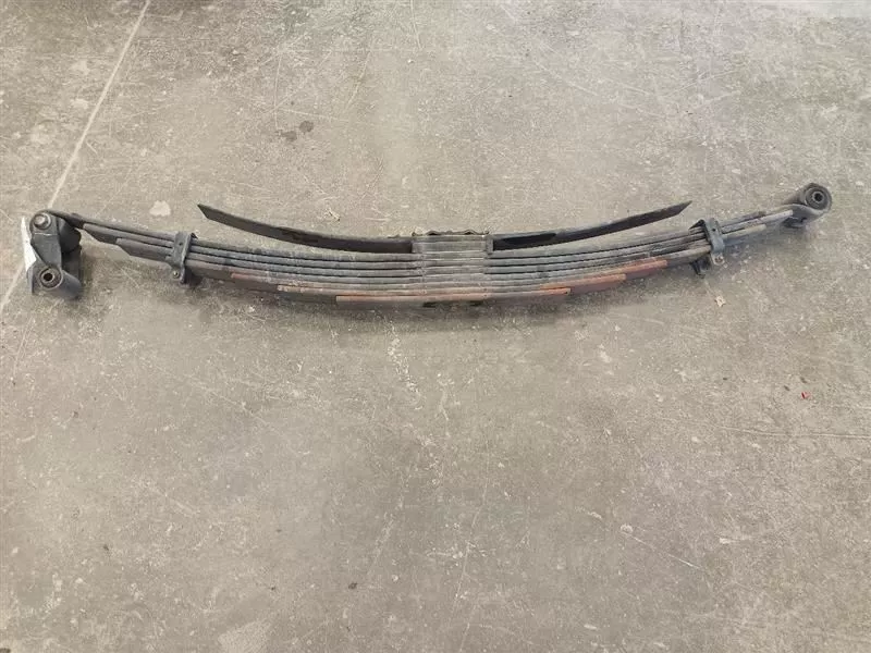

These are not my actual springs, they are just a reference so you can see the top overload spring I'm talking about.

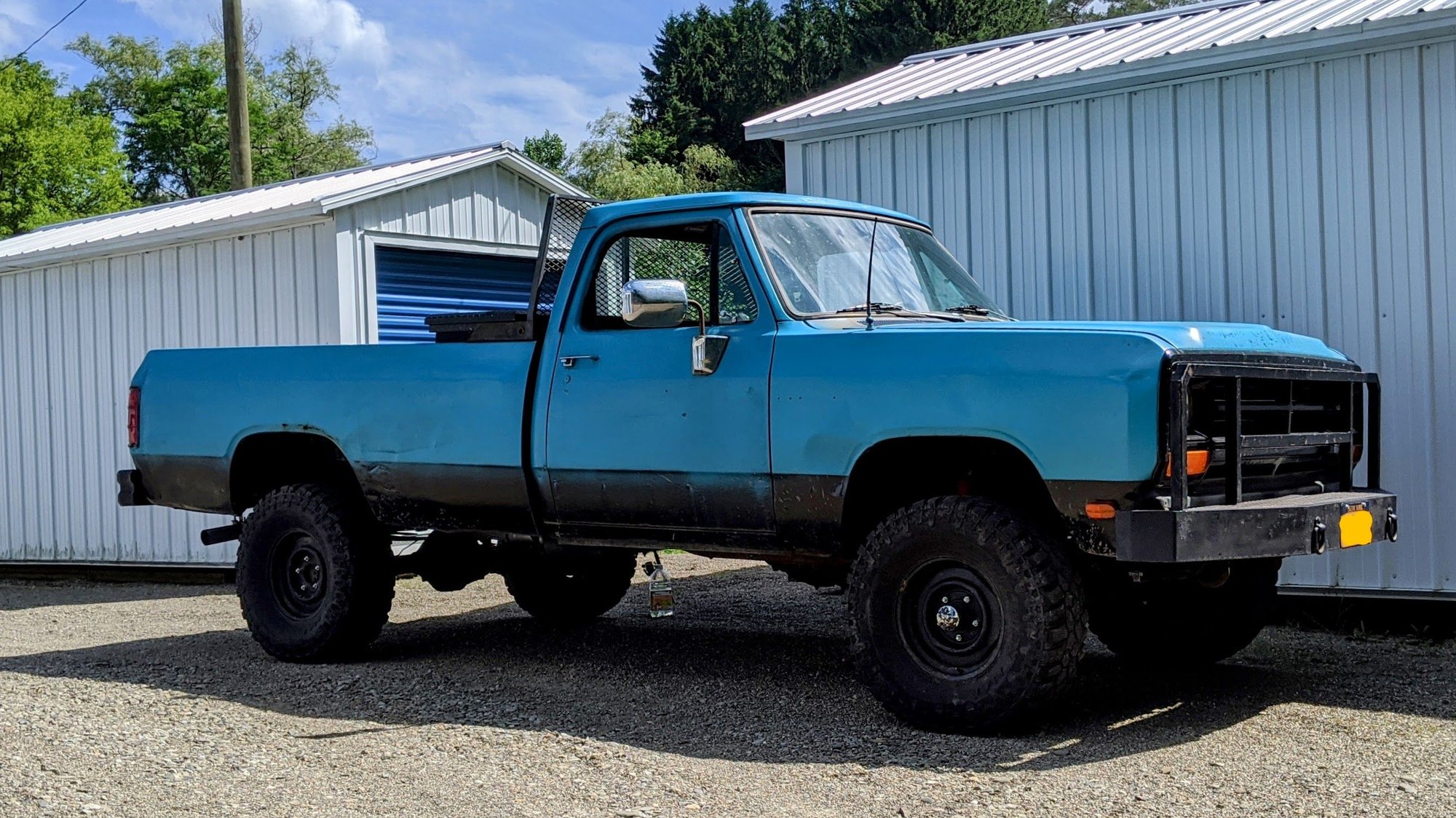

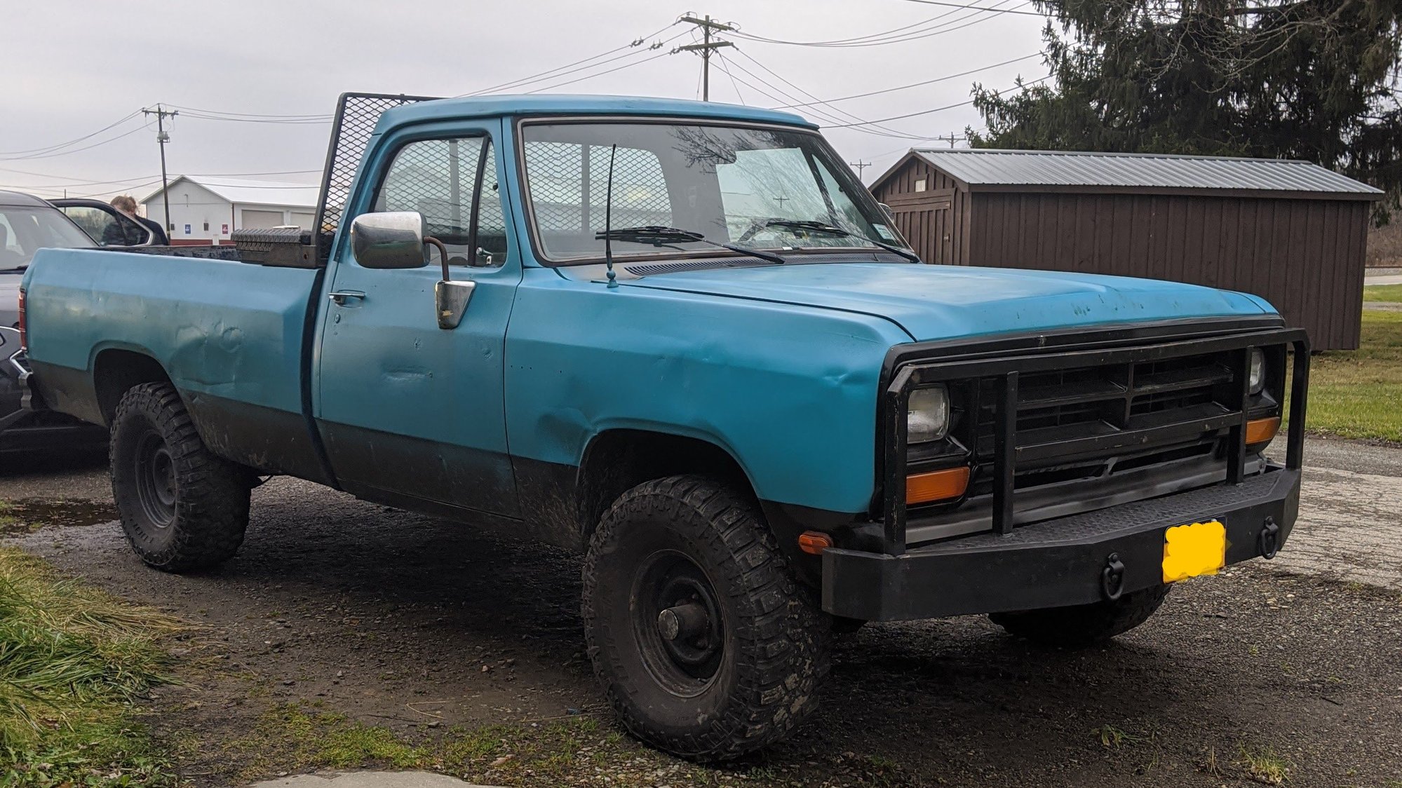

Before
Before
After
After
I know the paint is ugly, I bought it this way. I have bodywork and paint plans. It was a Forestry Service truck for the state of Georgia so I'm going to go green.
Anyway, I finally decided to upload some photos of the truck before and after my home brew leaf spring upgrade. It now has 8 leaf springs in the rear: four stock ones and four from an '89 K3500. The front has three springs: stock main, a shortened K3500 rear spring, stock shortest spring, and the overload spacer block from the K3500 as a lift block(I know, I know, but it's only about an inch tall)
