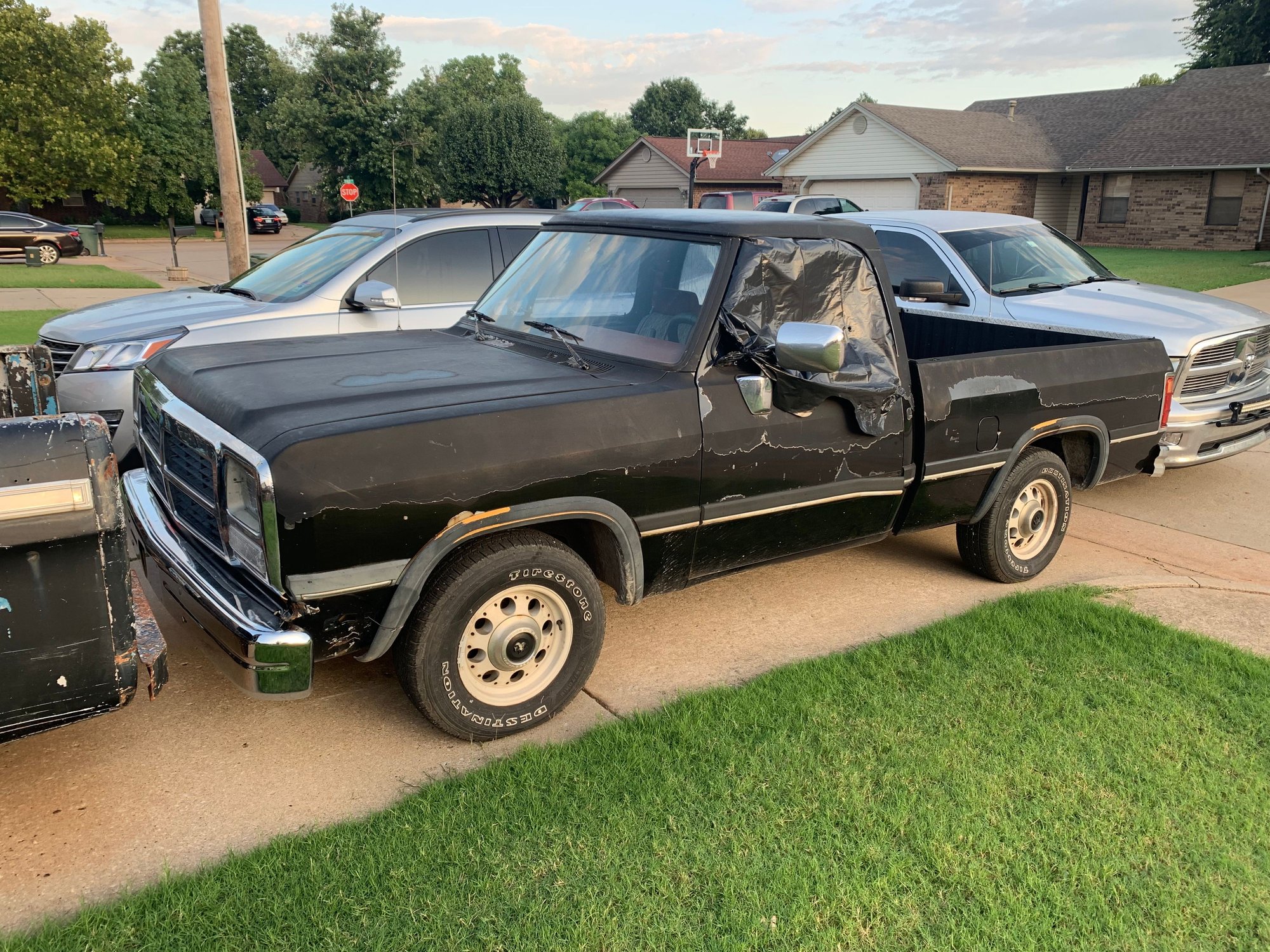

Hello all, I recently purchased a 93 D150. My plan is to build a drag truck with it. I need some recommendations for parts. The passenger side power door lock actuator is weak and needs to be replaced. Where can I get one because none of the local parts stores seem to stock them or be able to order them. Also besides finding a used one at a salvage yard, does anyone know if there are new door switch bezels being made? I have read the threads on lowering the truck and besides using the van lower control arms, does anything else need to be changed? As in like coil springs or shocks. Thank you in advance.

Like they say, pictures or your just passing wind!
What are you planning on doing for power and how quick are you looking to make it?
