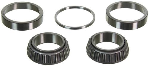

Oh, I have a additional concern about the bearings.
There is a difference between the napa set and the National A22 from O’Reillys.
The napa bearings I installed on my red truck have an inner and other cone spacer. The A22s only have a outer cone spacer and I’m not sure why this is.
One of the original bearings sets in my red truck only had a outer spacer. I just figured someone had been in it before and forgot the inner spacer but, after I purchased the A22s for the blue truck I just assumed some manufacturer include them and some don't. I don't’ know if that's the problem but, I wish I would have returned those bearings and got the napa ones but, I was limited on time.

I suppose the only thing I can do is replace the bearing with the napa set and check the retainer cap for damage. If that doesn't fix it my knuckle must be gone.
I don't think it could be the hub, those bearings pressed on pretty tight.
