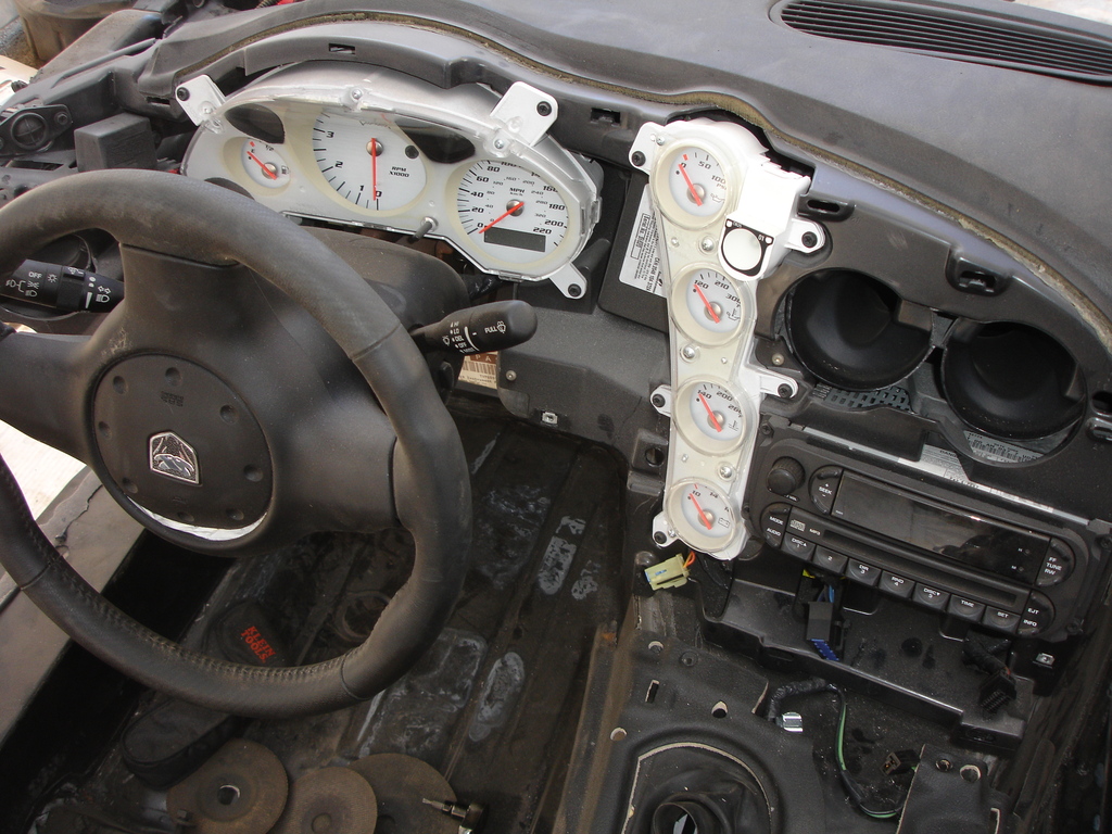

Removed cluster and radio so I could get the pad out.
It has a hole where the airbag blew out so I'm going to just go have it recovered sans airbag unit.

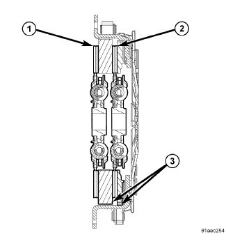

TR6060
Why have one clutch disc when you can have two?
From the manual:

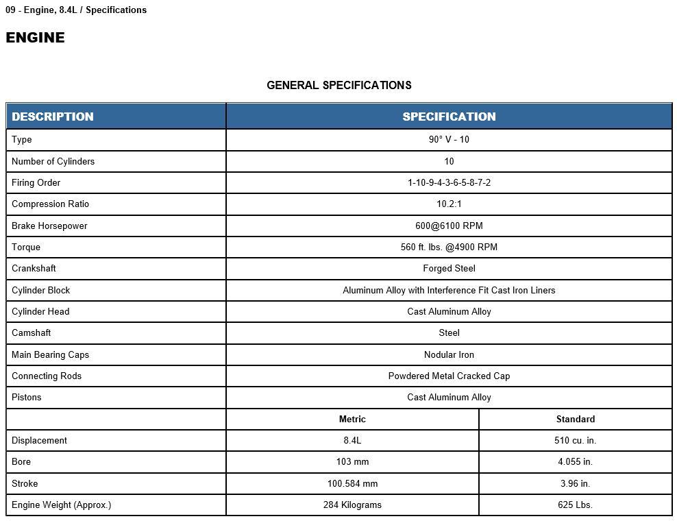

Some engine facts for ya from the manual:

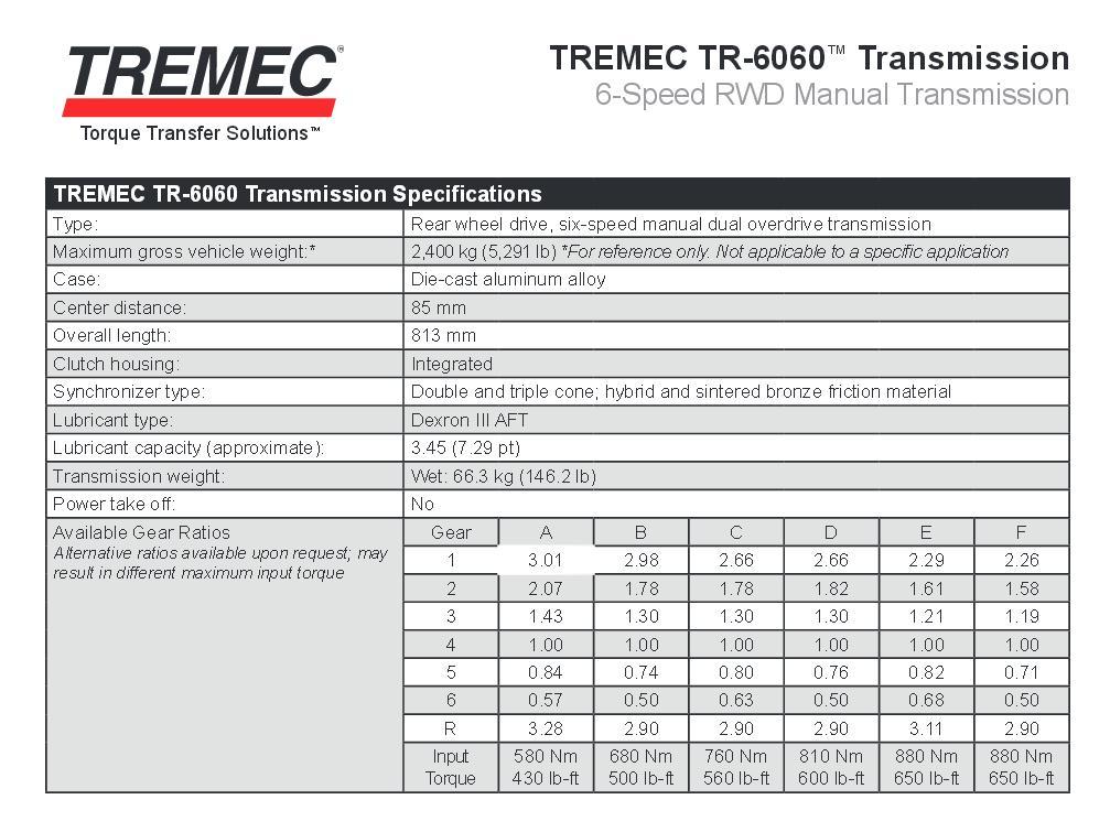

146 lbs

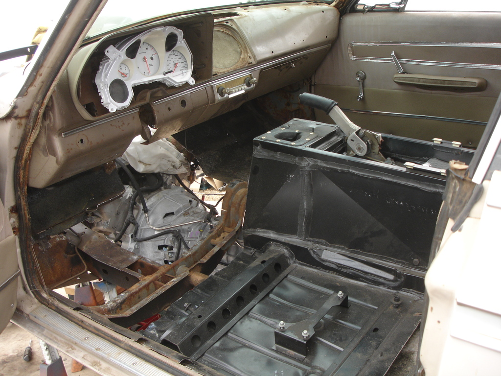

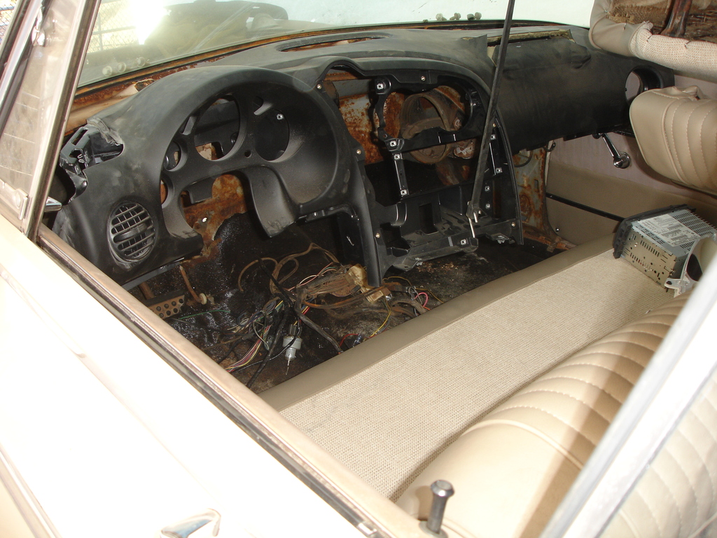

Since I am taking the dash apart I figured I'd get a quick idea of the fitment in the 63. Yeah - looks like crap, but ya gotta have vision

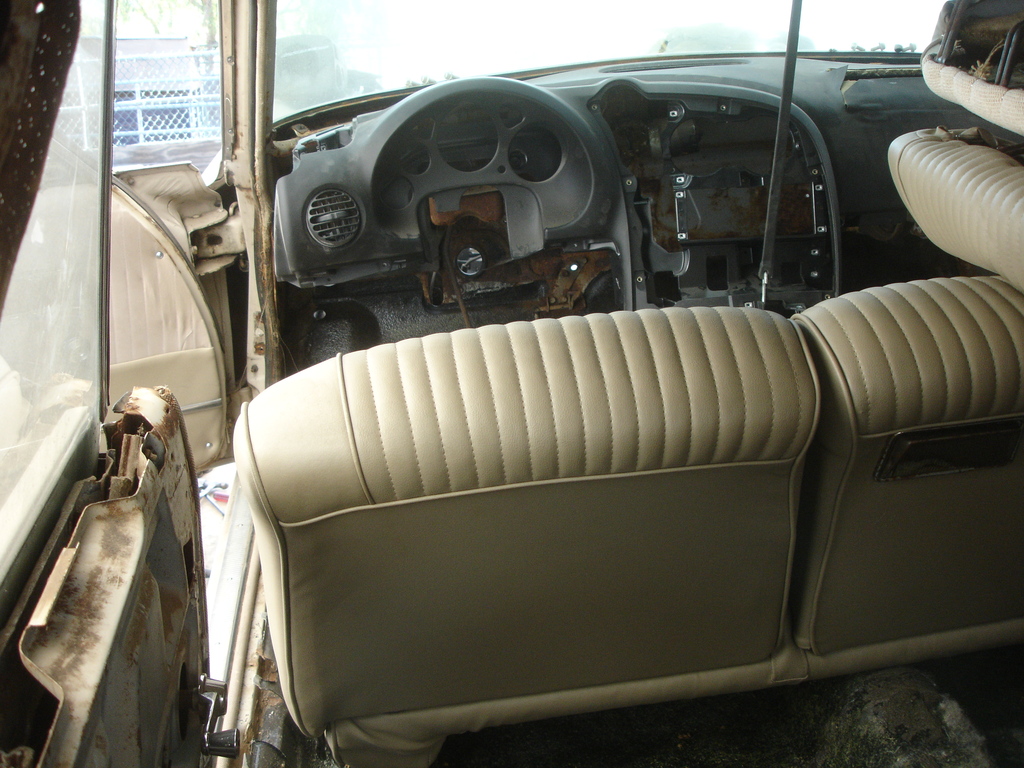

Since the Viper windshield is more curved I will have to mod the dash area for a good fit.

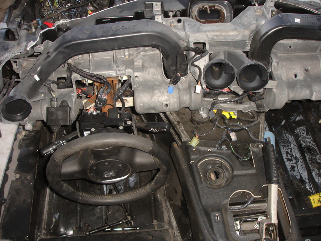

You can see how the dash looks before factory install. It is bolted and glued to the frame. I separated it at the glue line and pulled it off by hand.

The metal structure of the dash is aluminum so it cannot be welded to the steel. It will be attached with brackets and bolted to the parts of the Viper frame that will be included - they will be welded. I will preserve as much of the stock firewall as possible. I'm pretty sure the only part of it that I will cut will be the "hump" aka tunnel........and just a bit where the rear of the engine will be.......since it is further rear than normal.

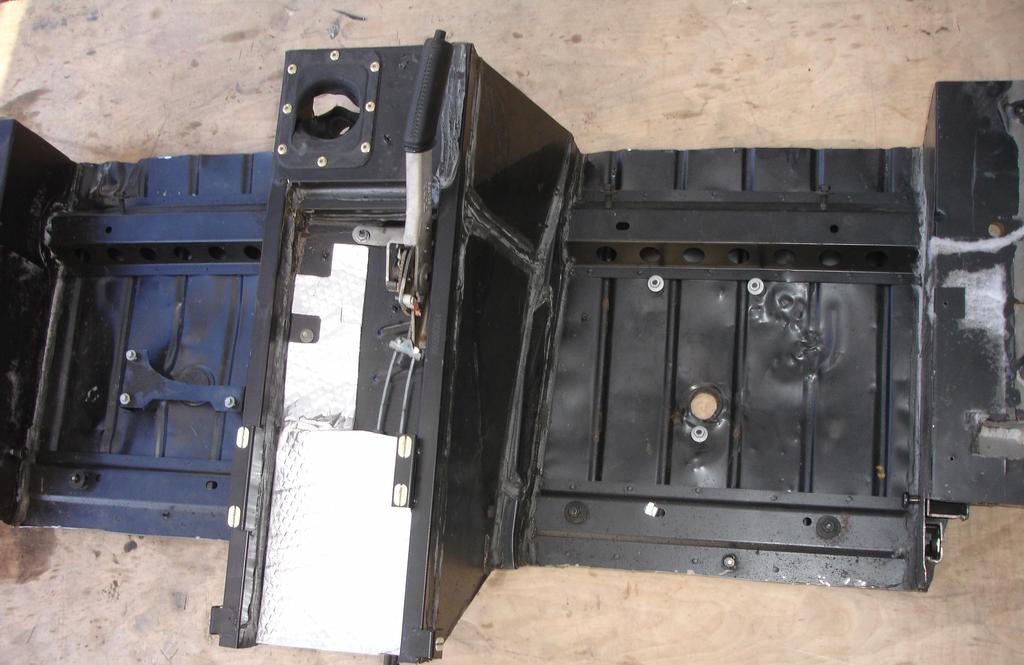

Here is the rear half of the Viper floor section I will use. You can see the thin floor has lots of damage - mostly from it being moved with forklifts and jacks w/o care. I will decide what to do when I am installing it.
Some places the floor will be two layers ......maybe three in other places. I have to increase the strength of the unibody as I go.

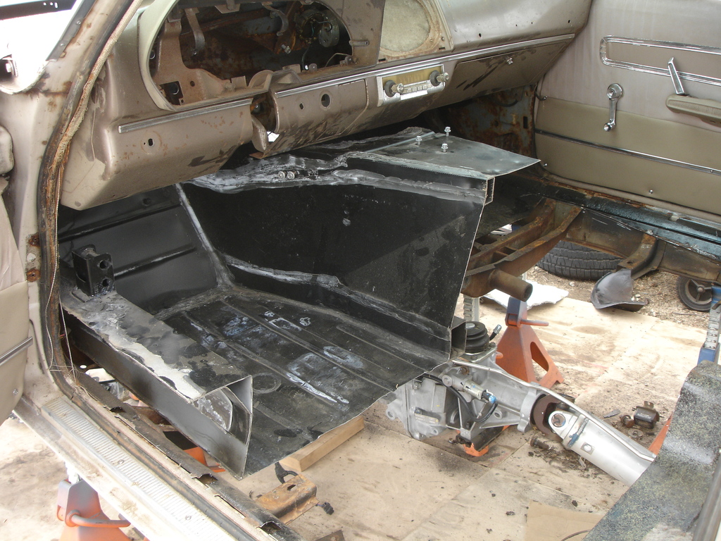

So....I trimmed down the forward part of the Viper firewall/floorpan and put it inside the 63. I got in there with my cutting wheel and am going at it.....feel like that Leepu guy
Once I get it pared down to what I like I'll go after the 63 metal......the scary part

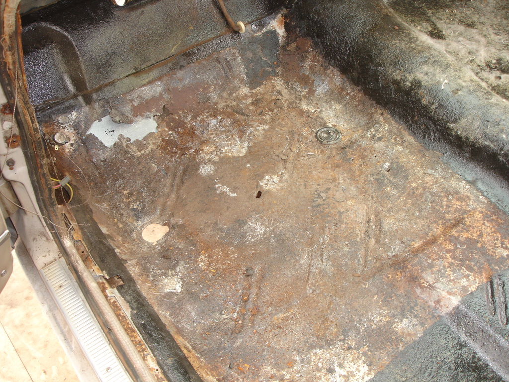

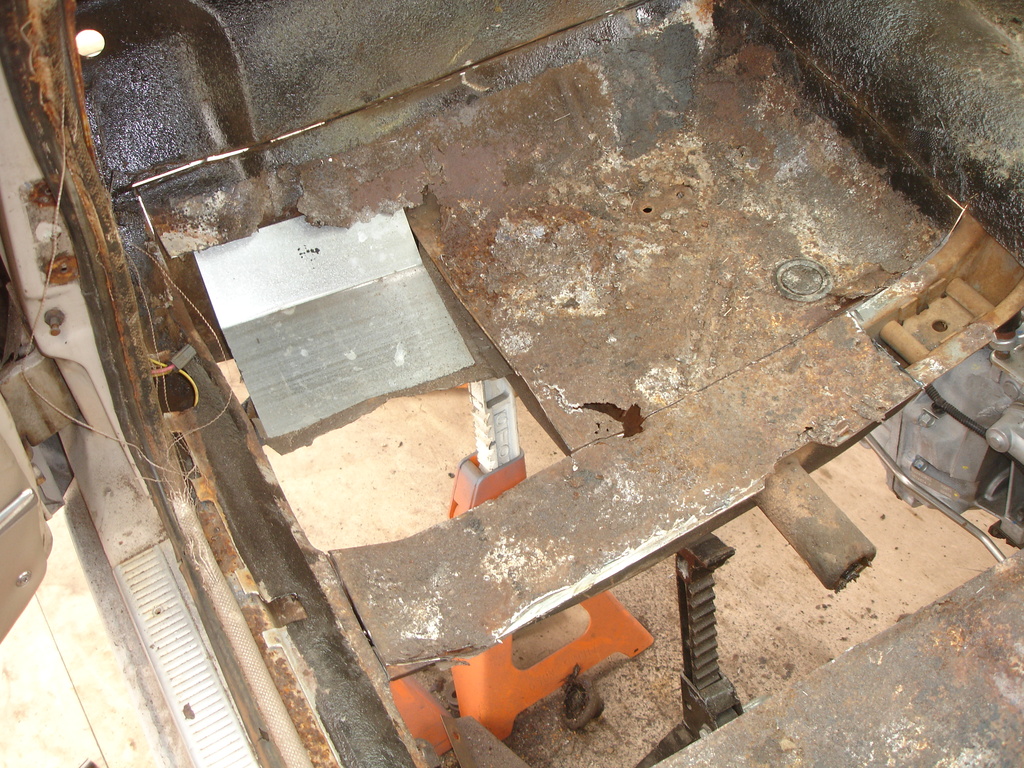

I knew that the floor had been repaired....if one could call it that.....in some fashion, but..........
The left front floor had a mesh repair and I was able to grab it with pliers at the edge and pull it off in one piece......obviously not bonding to rust.
You can see where he didn't even apply POR15 under it.

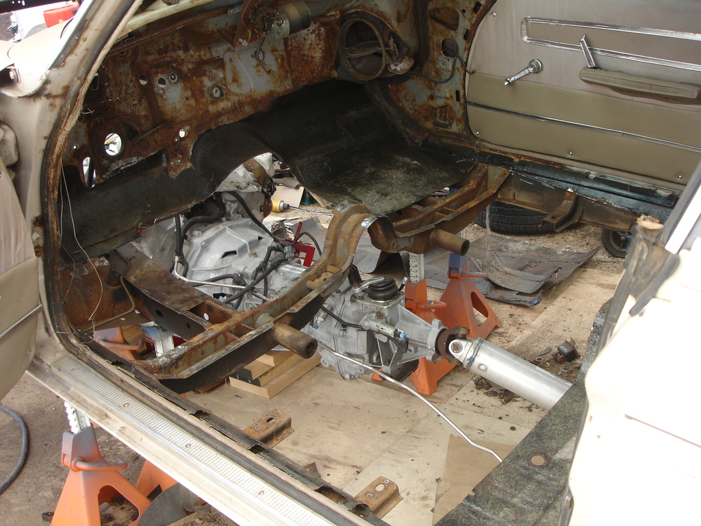

I removed a good portion of the floor and the steering bracket.
First to go was the rust and area that was not flat as the contours would be in the way. I measure.....measure....cut....measure..measure...c ut.....
Bit by bit.
I knew from the start that the wipers and cowl drain area would be a challenge........soon find out.

Looking at options
I would have to drop this pan down a few inches as well as move it forward, but not ready to cut until I figure out how I want it.
