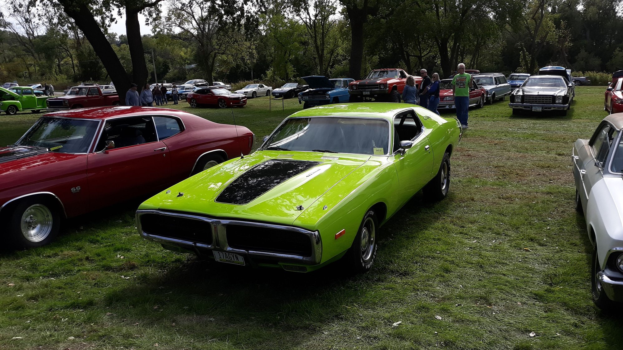

Welcome to the forum, I'm glad you were able to get it going. Do you have pictures of your mopar?

Super...... Very nice Ride....
