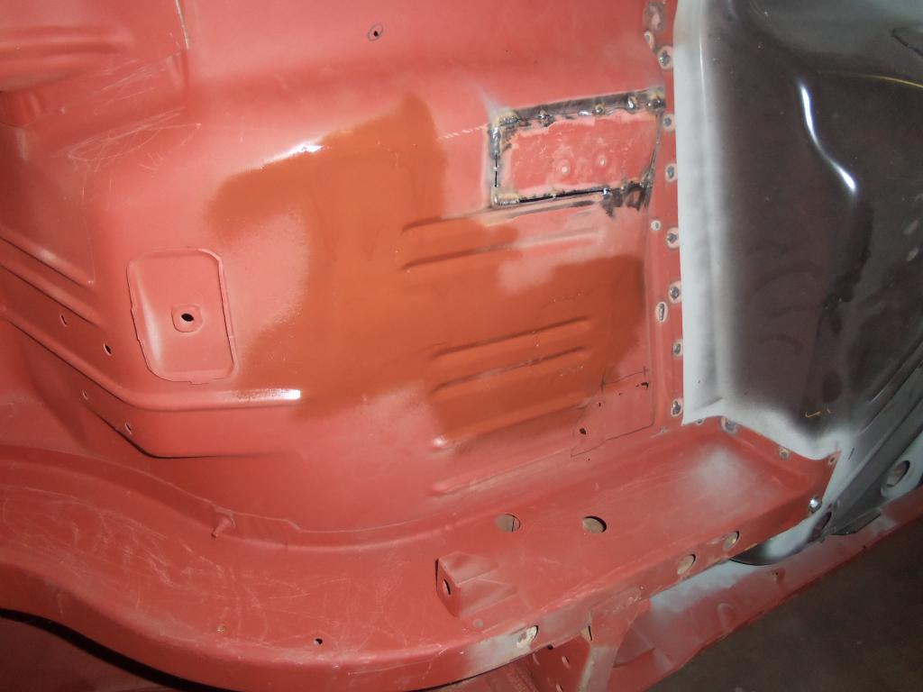

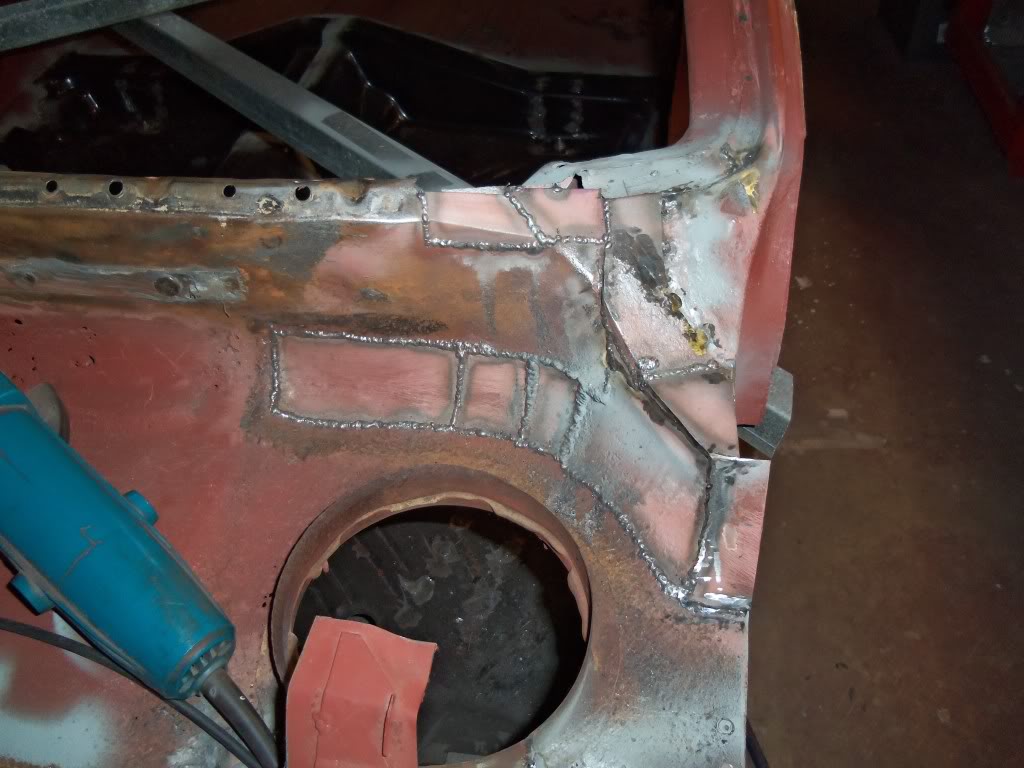

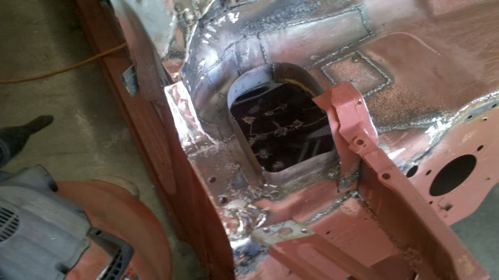

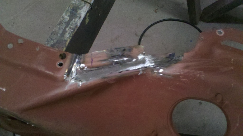

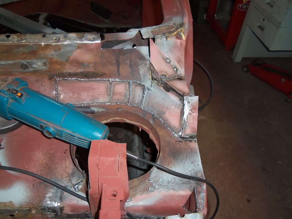

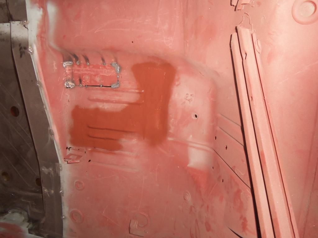

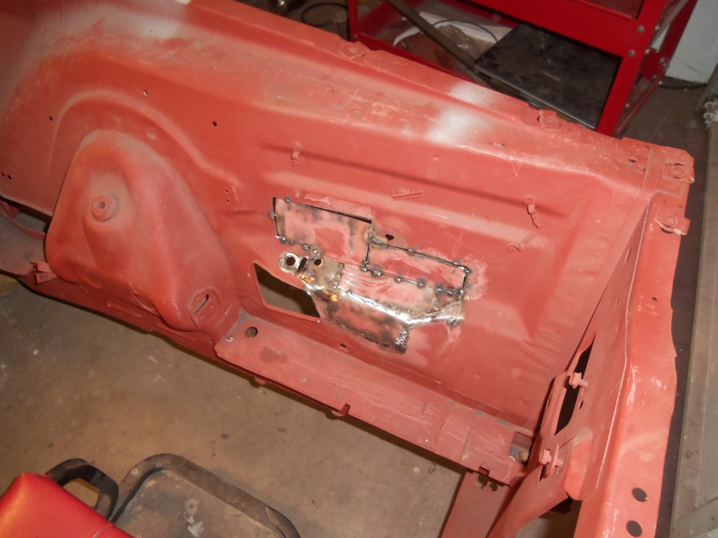

Rebuilt section of firewall

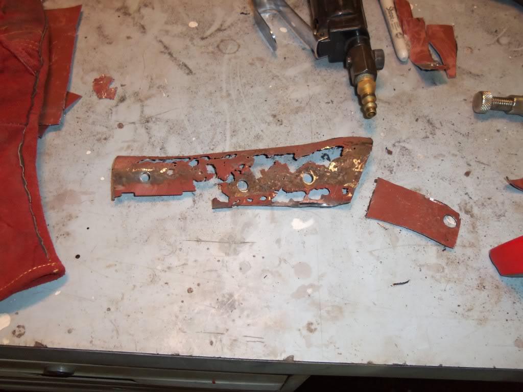

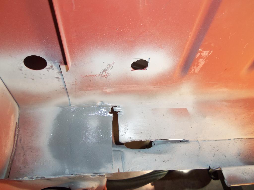

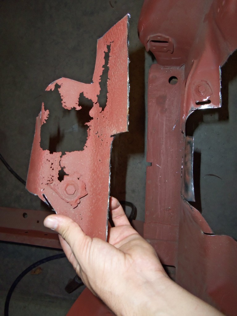

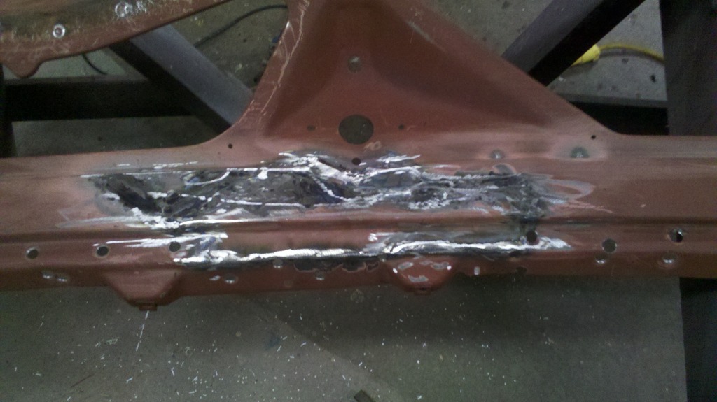

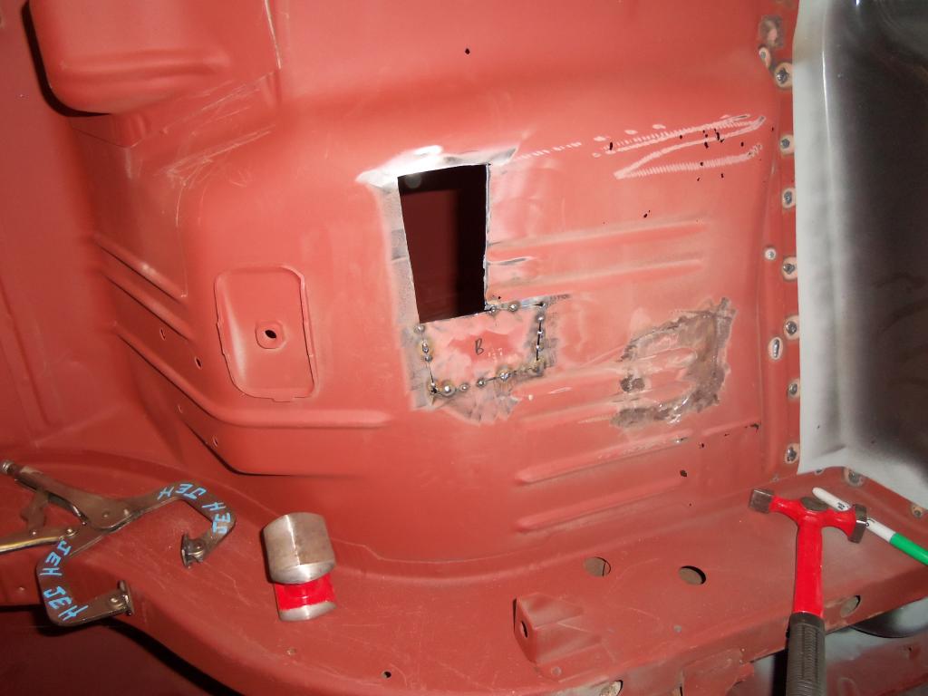

Removing more holy metal.

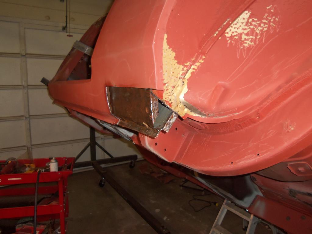

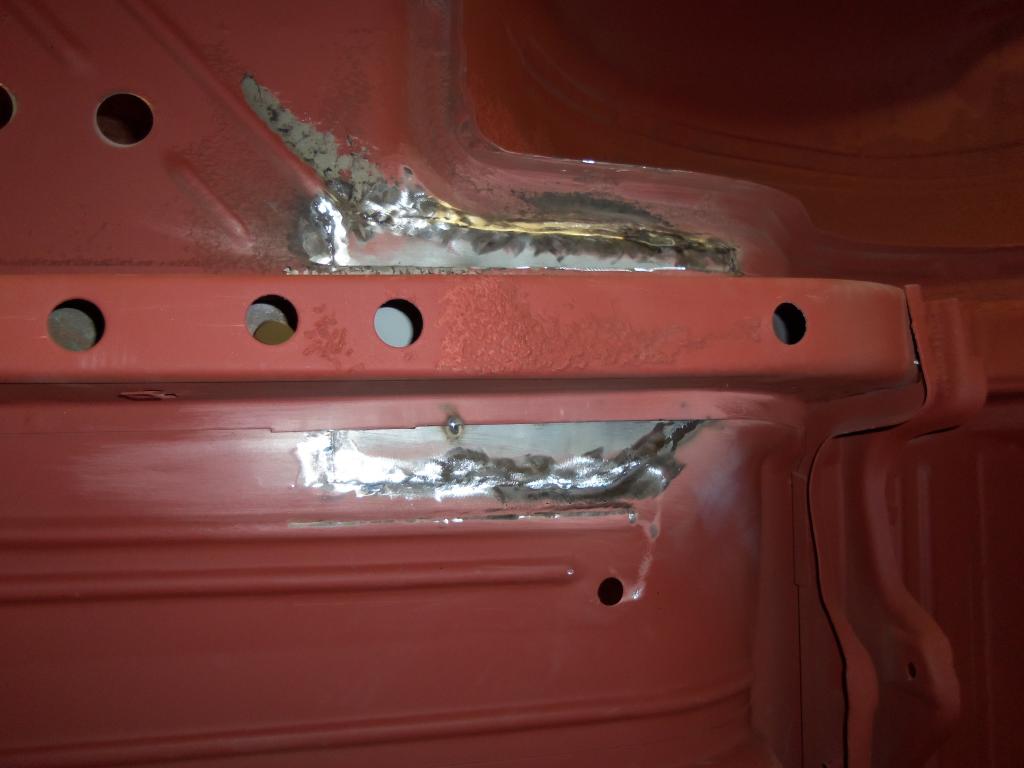

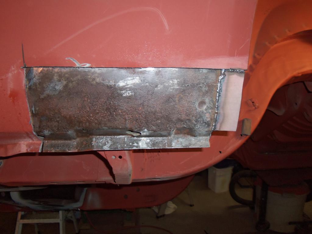

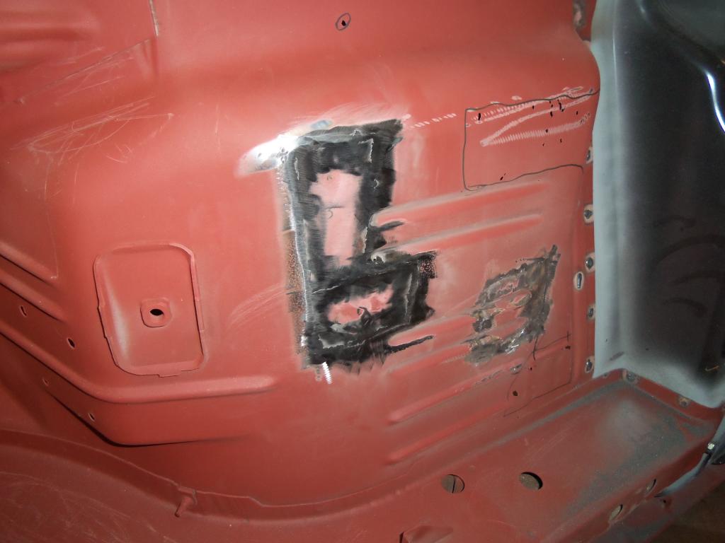

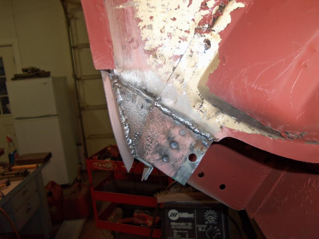

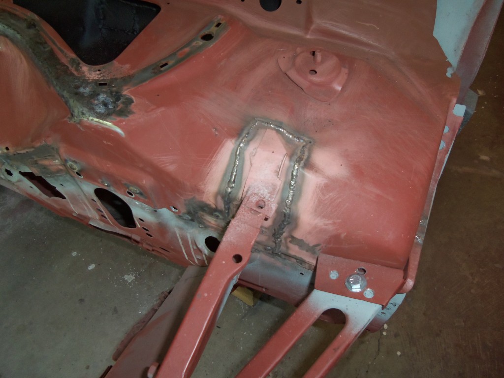

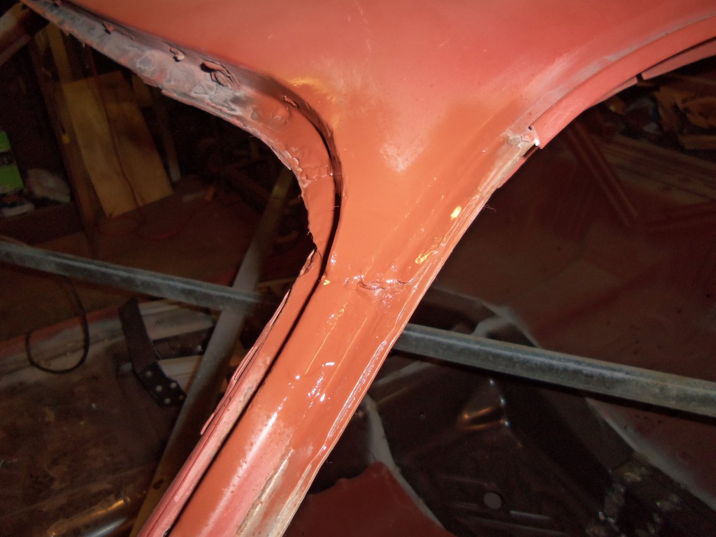

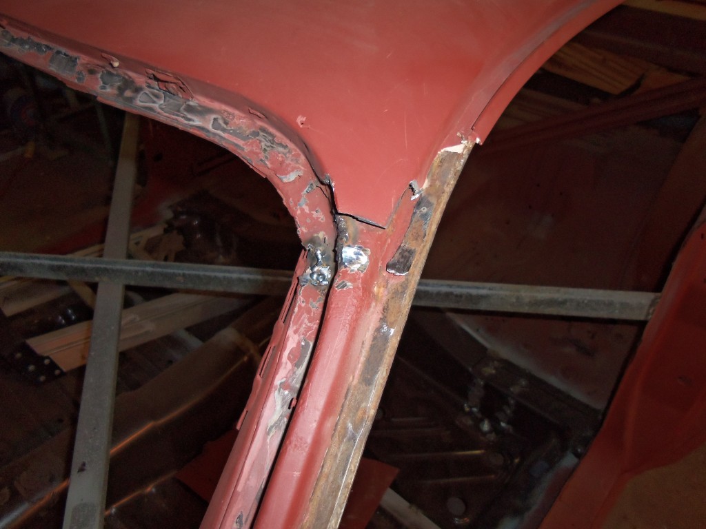

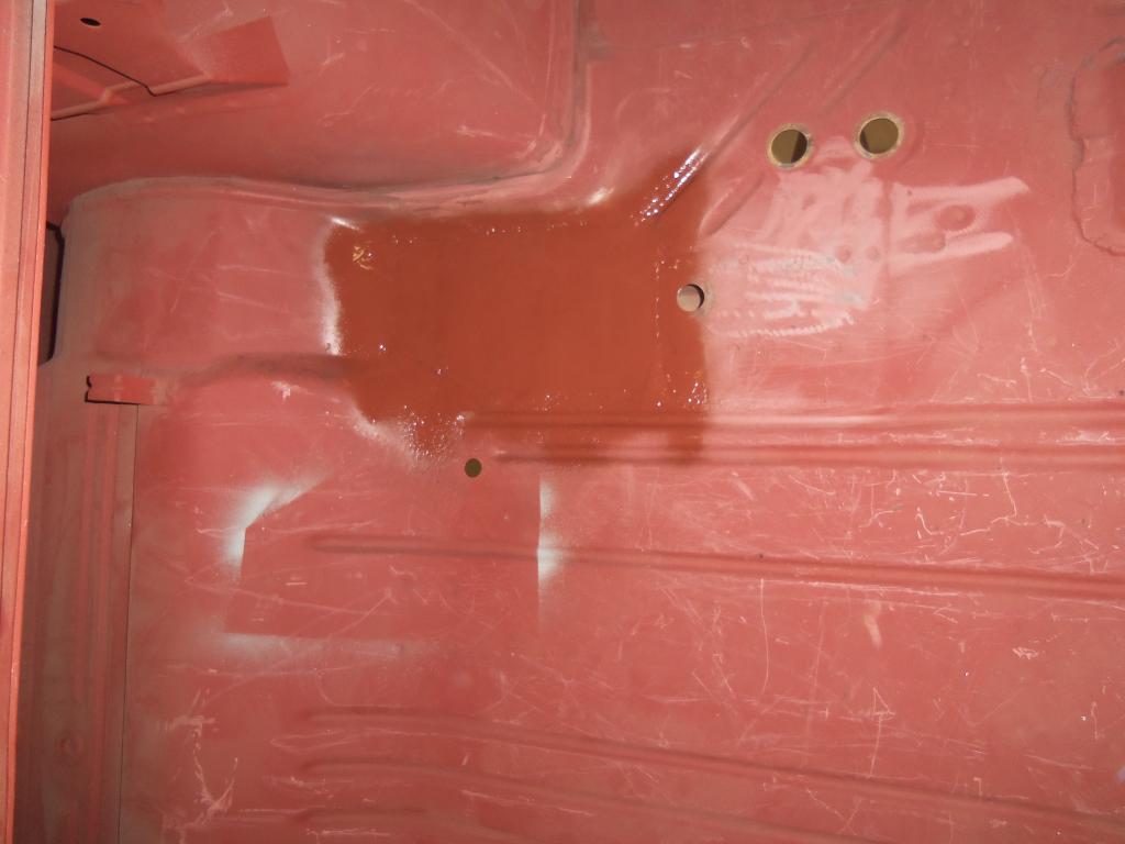

Still cutting out the bad, replacing it with good.

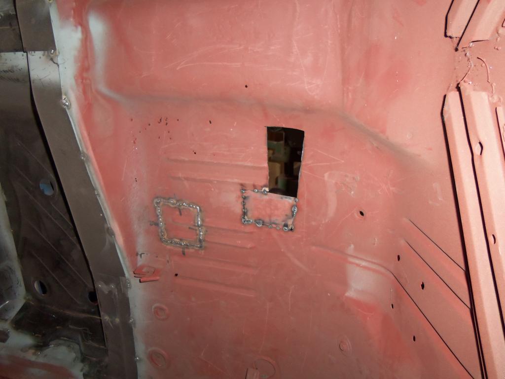

Likes: 20
From: Roxboro NC

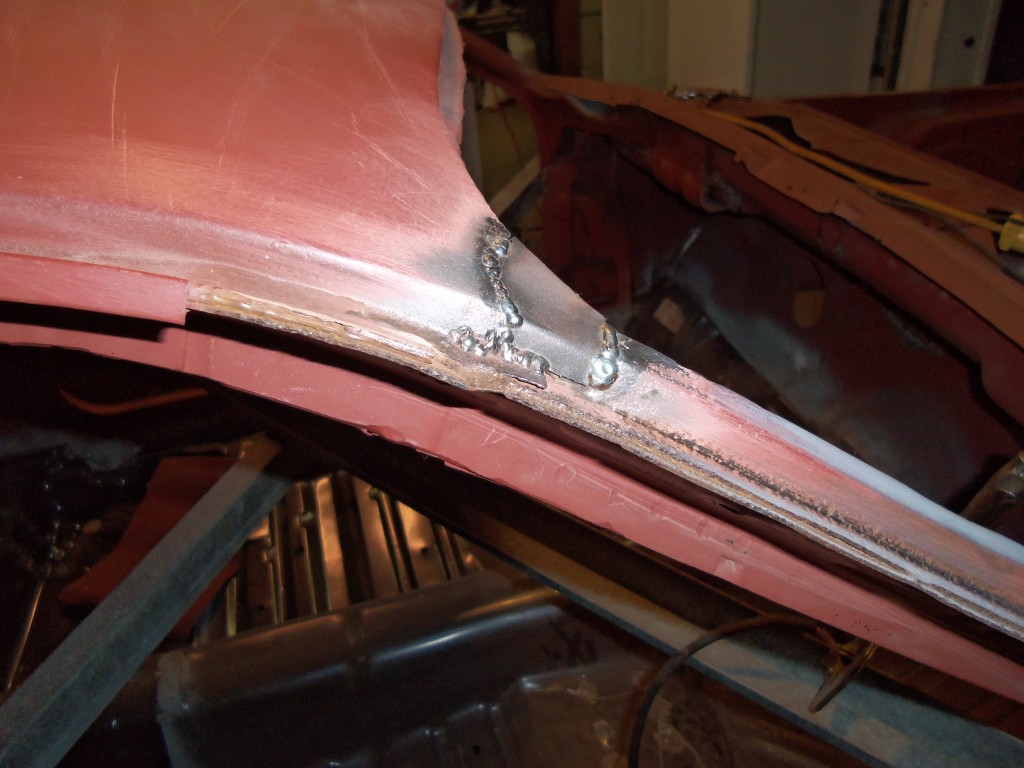

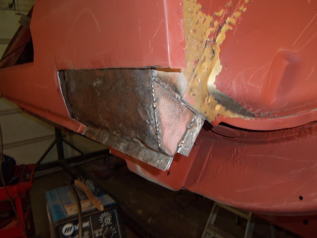

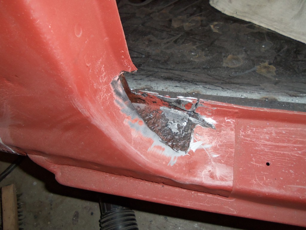

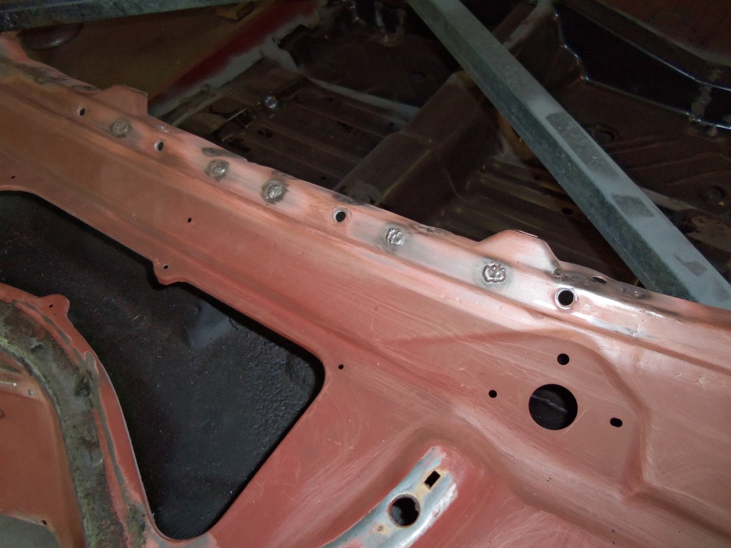

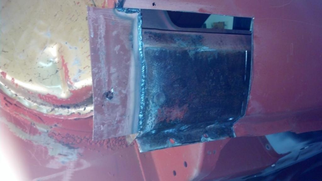

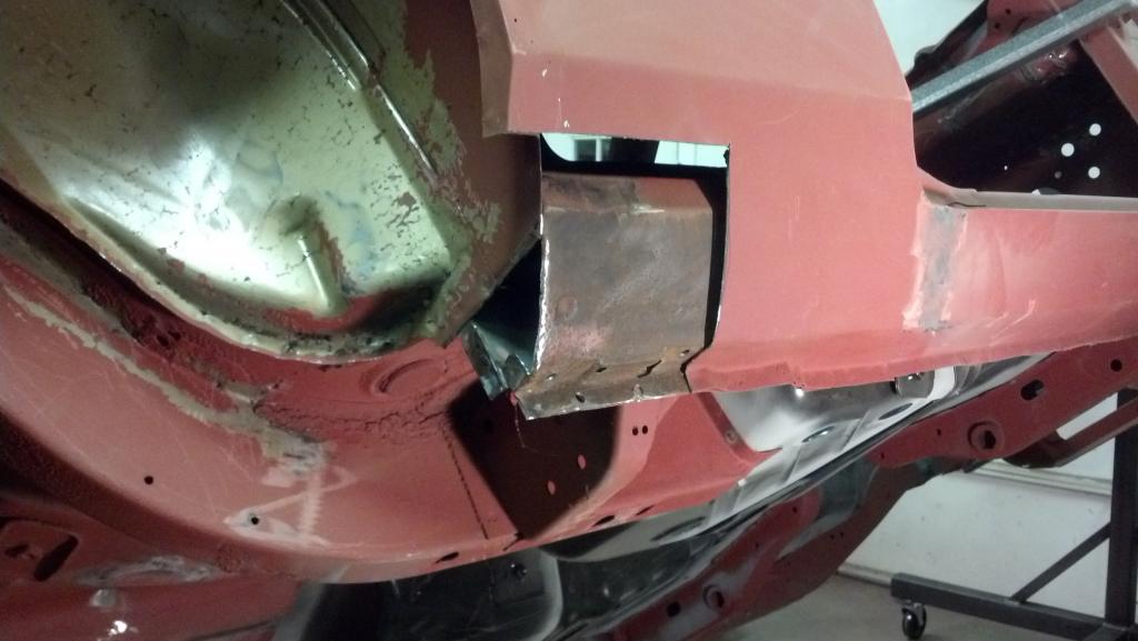

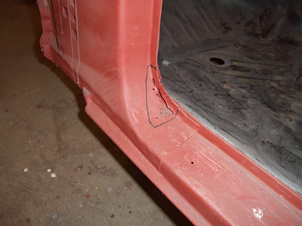

More patches! All wire-brushed up!

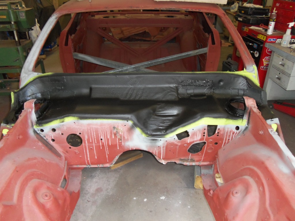

Old Jul 1, 2012 | 01:37 PM
  #40
Buffalojoe426's Avatar
Posts: 648
Likes: 20
From: Roxboro NC

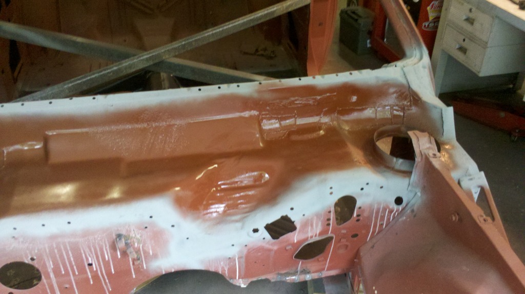

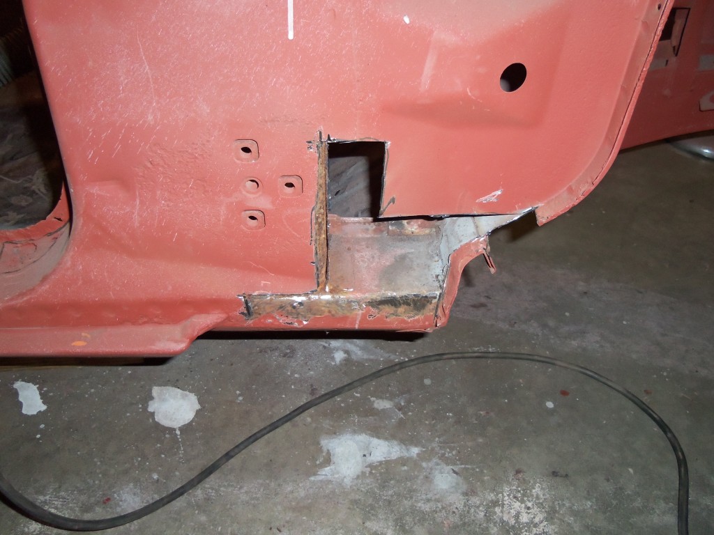

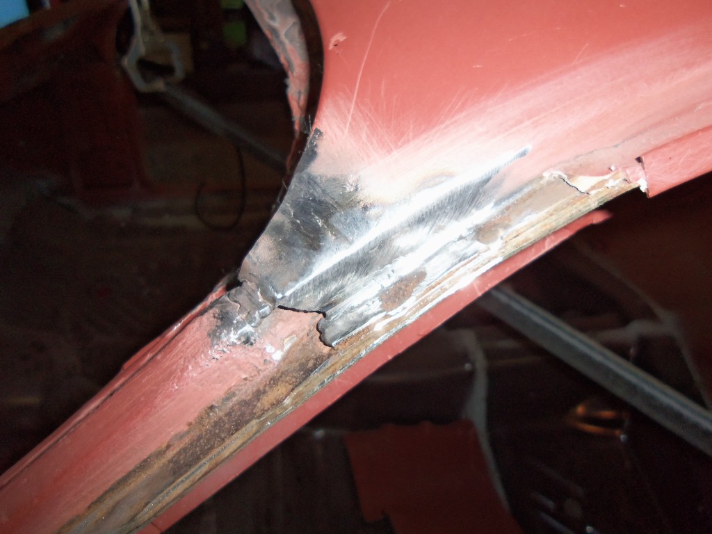

Now to start on this piece.

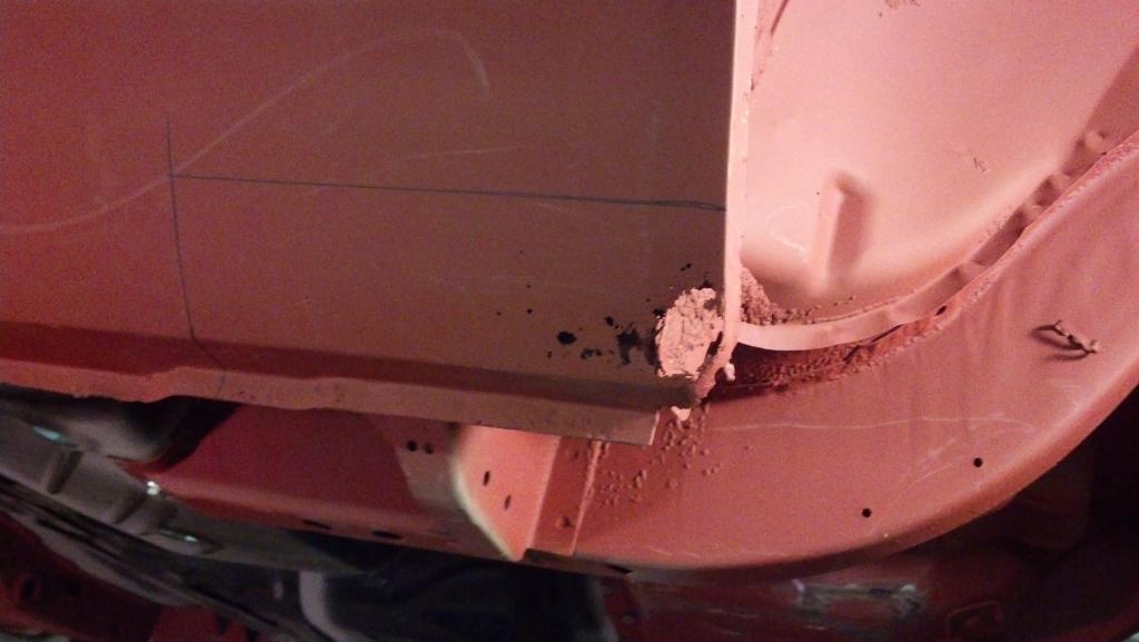

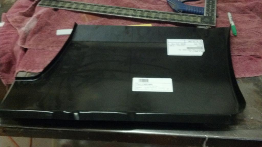

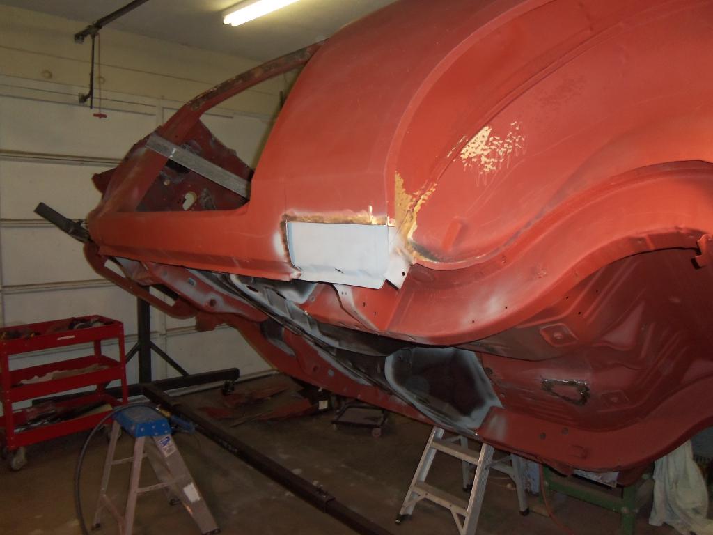

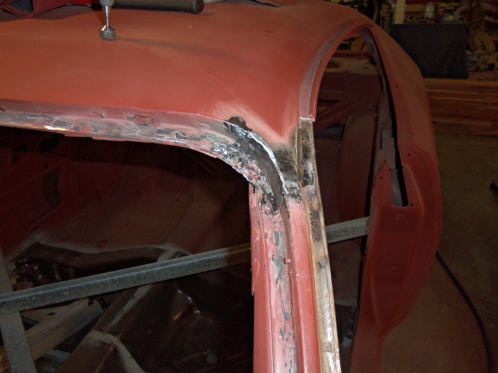

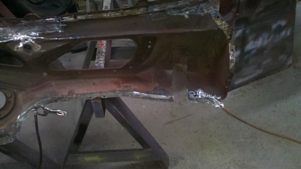

Sorry about the low quality pictures, they were taken with a phone.

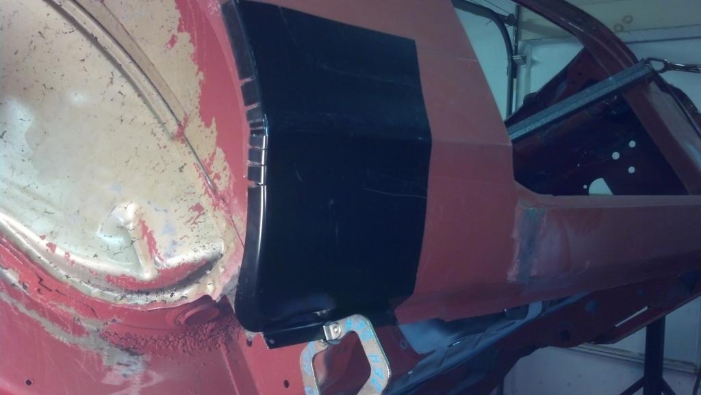

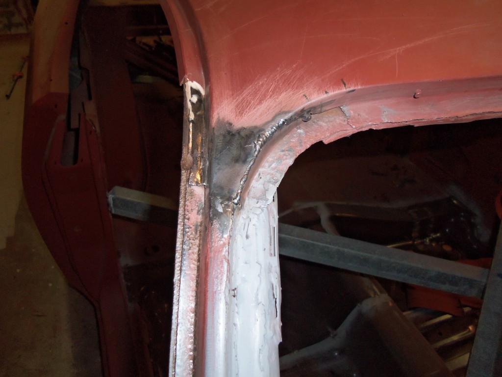

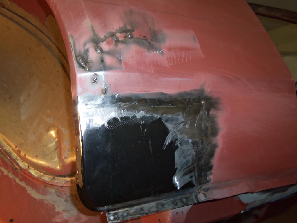

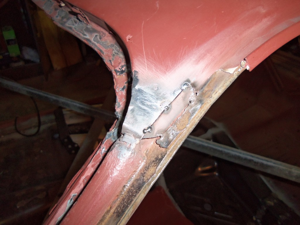

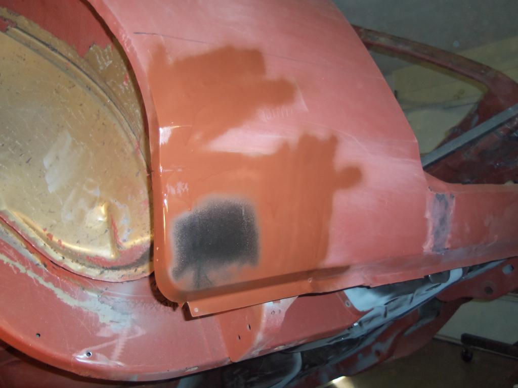

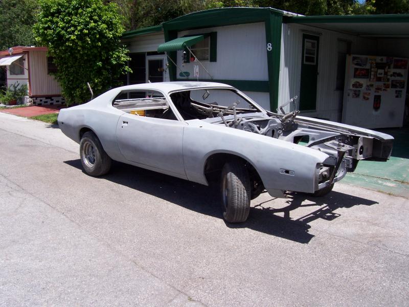

Old Sep 11, 2012 | 03:44 PM
  #45
old tired rebel's Avatar
Joined: Sep 2009
Posts: 502
Likes: 6
From: Stillwater Ok
Subscribed
Old Sep 11, 2012 | 05:00 PM
  #46
lou3500's Avatar
Posts: 283
Likes: 27
From: Palm Harbor Florida
She's coming right along very nice work that will be a very clean charger when done. Our's will hopefully be getting some love with in the next few weeks been busy with another important project while i'm on vacation. My dually was totaled and the red truck is it's replacement [my other project] gotta get it tuned up/detailed up before i return to work.
Attached Thumbnails 71 Charger rebuild-102_2558.jpg   71 Charger rebuild-photo-1.jpg   71 Charger rebuild-102_2557.jpg   71 Charger rebuild-102_2572.jpg

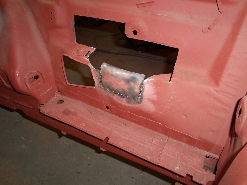

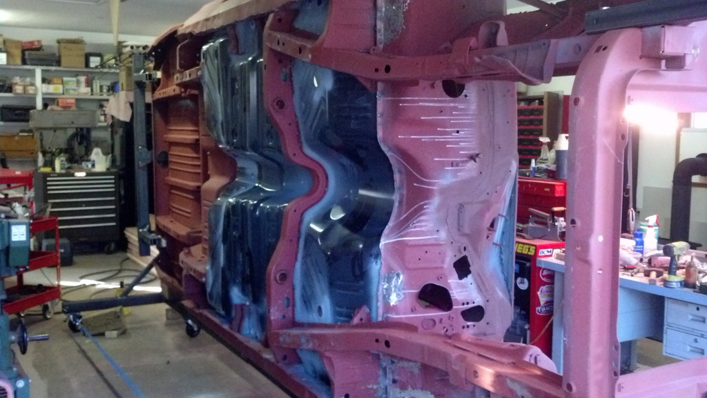

Haven't had much of a chance to work on her lately. Here is where I stand.

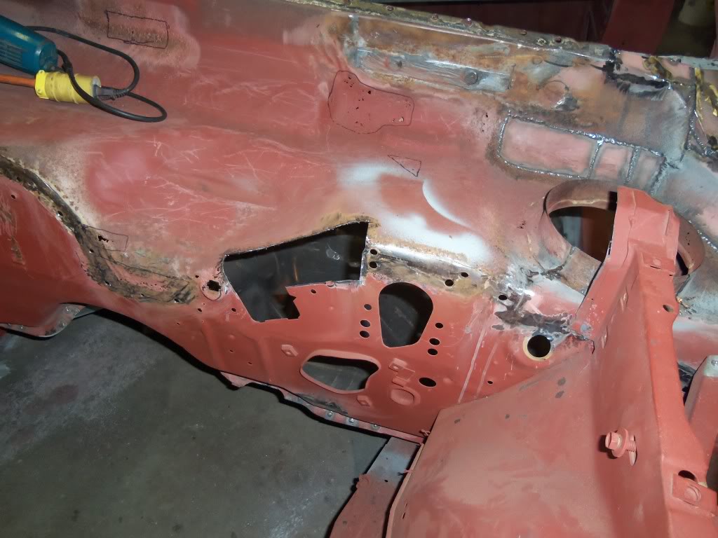

Update!

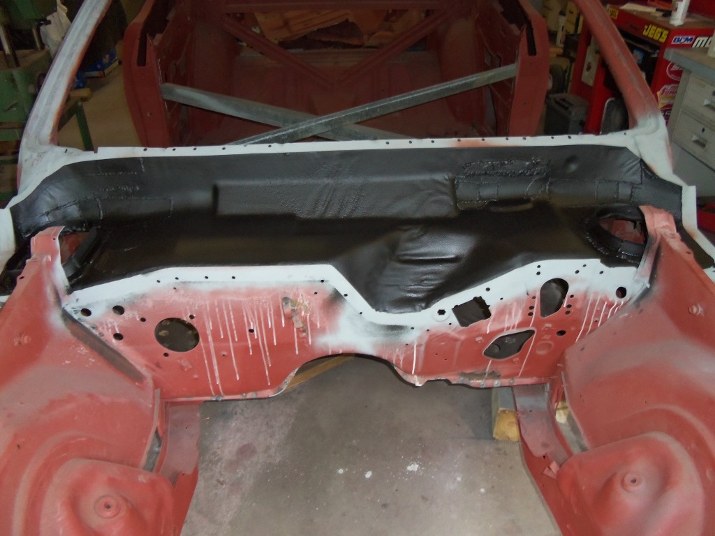

Finally got some more pictures.

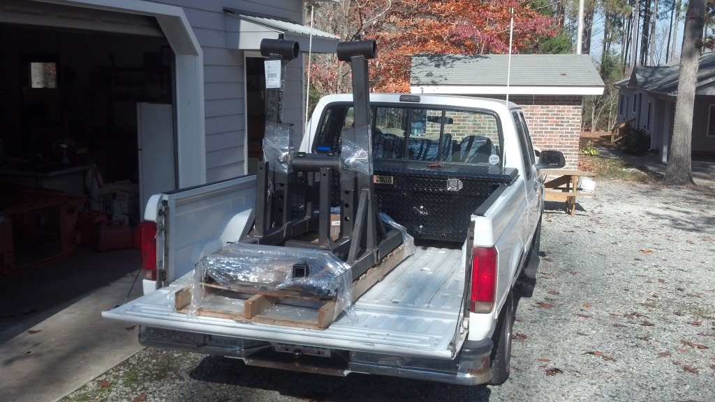

And a new Toy!!!

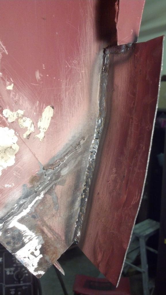

your patching is great!

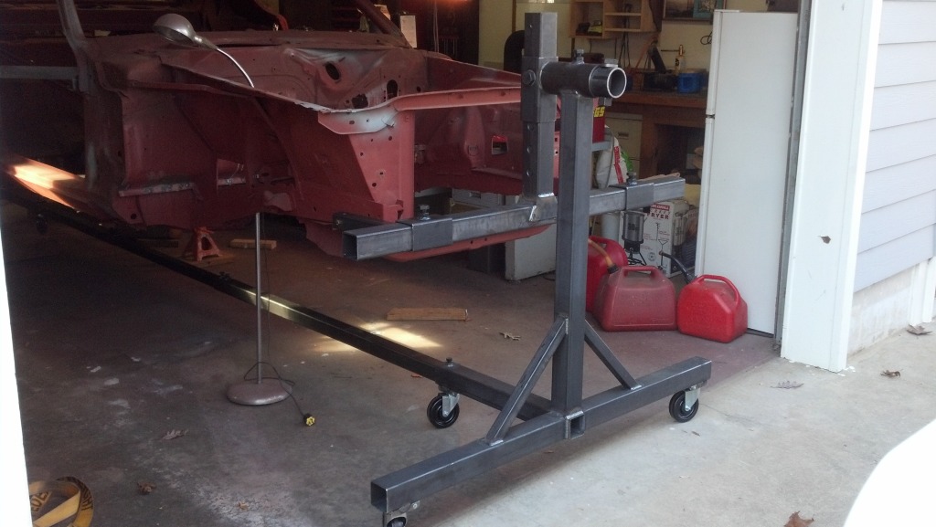

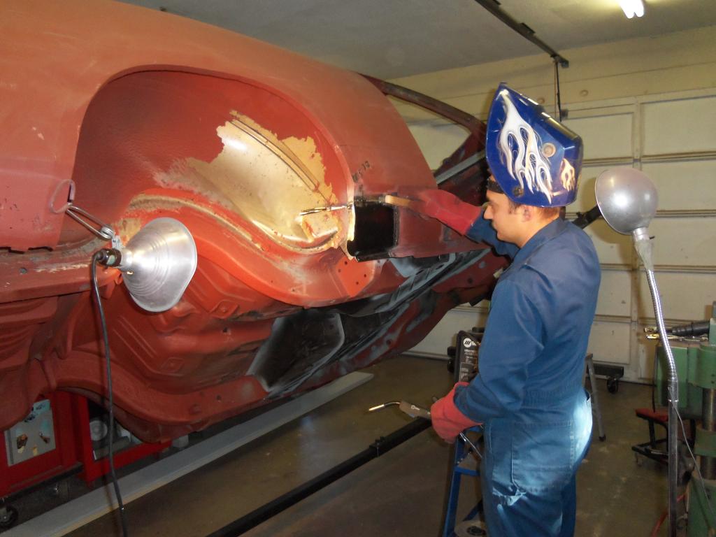

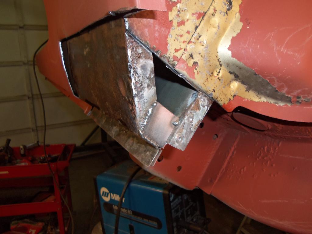

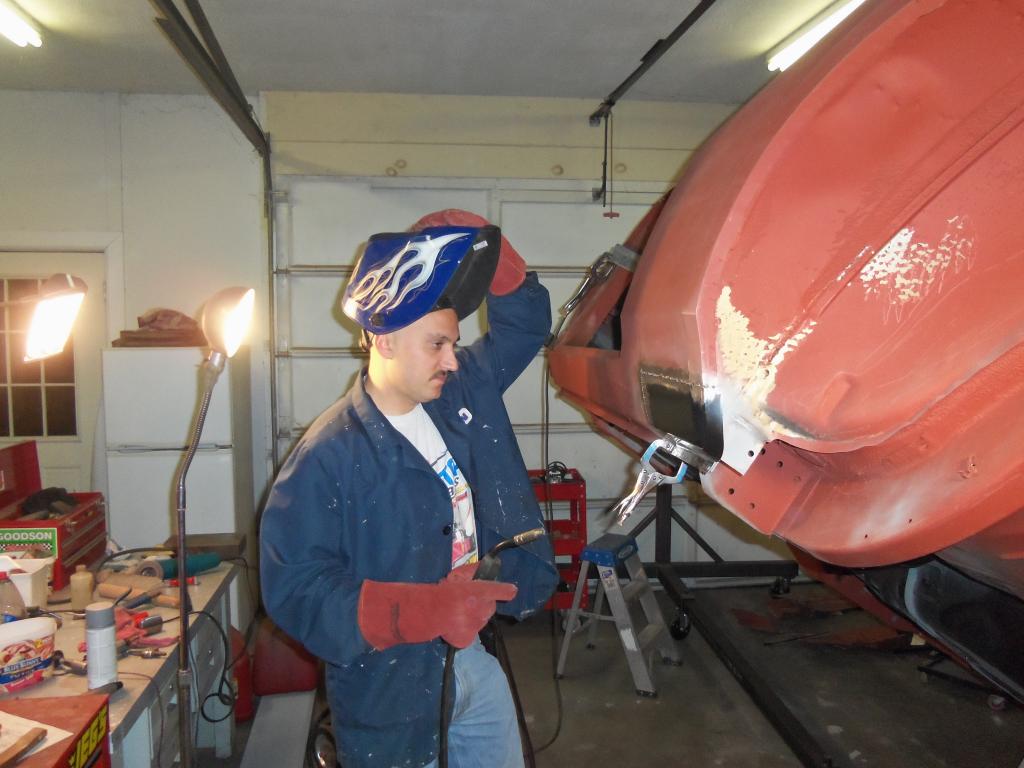

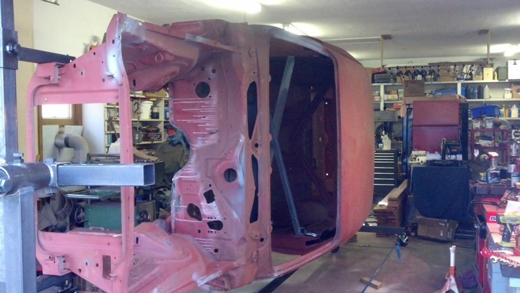

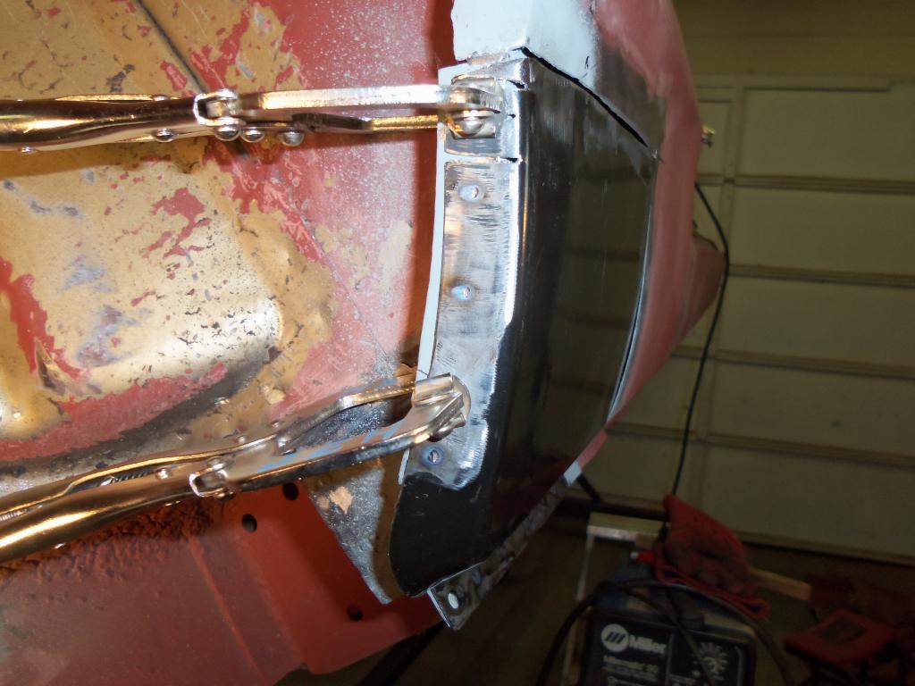

You can see your welds keep getting better, all that practice your getting eh.
It's tough welding in tight space's and around all the curves and angles.
Are you using a mig only or are you using a stick welder also?
What size/type wire/rod, what amp are you welding at?
What are you using to shape your patches?

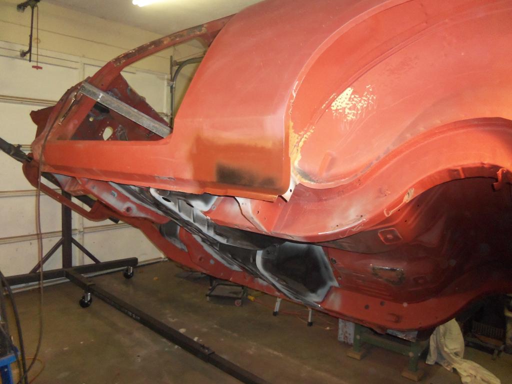

And how did you get the body on the carousel?
Old Dec 20, 2012 | 01:26 PM
  #52
Posts: 648
Likes: 20
From: Roxboro NC
Gorts 5th
Thanks for the complements. I am using a 110V miller mig welder with .023 wire and CO2 shielding gas. I have it set at the lowest setting, some times I bump it up to the second setting. I have the wire speed set at around 60. Some times it works well, other times not so good. I cut the patch panels out of sections of the floor pan that I removed that was rust free. I try and find a piece that matches the couture best. Then I flatten it on a large flat piece of steal and bend it with hammers, dollies, a break when needed, and good old fashion hands. I have a band saw with a metal blade that makes cutting sections a breeze. I am working on a patch panel for the quarter in front of the rear wheels. I am having to re shape it and it is taking some time. I need to see if I can get my hands on an English Wheel.
I got the car on the carousel by jacking it up and resting it on blocks until it was high enough to bolt on. That was an all day job, but it has really paid off.
Thanks for the encouragement every one! Hopefully soon I can move to mounting the front fenders, doors, hood, and trunk. Then I can start to line everything up for body filler.

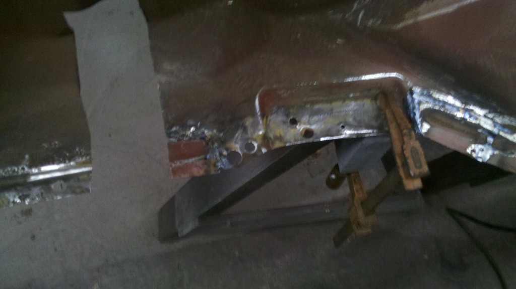

Some more pics!

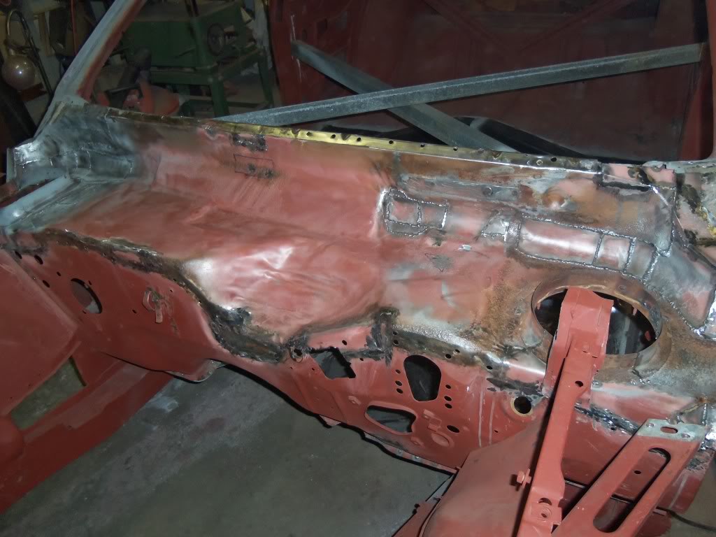

My brother giving me a hand.

Originally Posted by Buffalojoe426
Gorts 5th
i'm impressed use to work in a restoration body shop so i under stand what your up against your doing a great job keep up the good work.

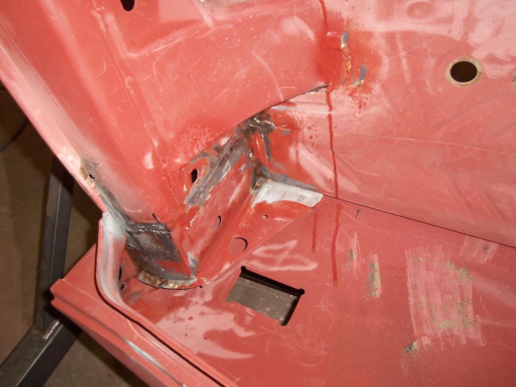

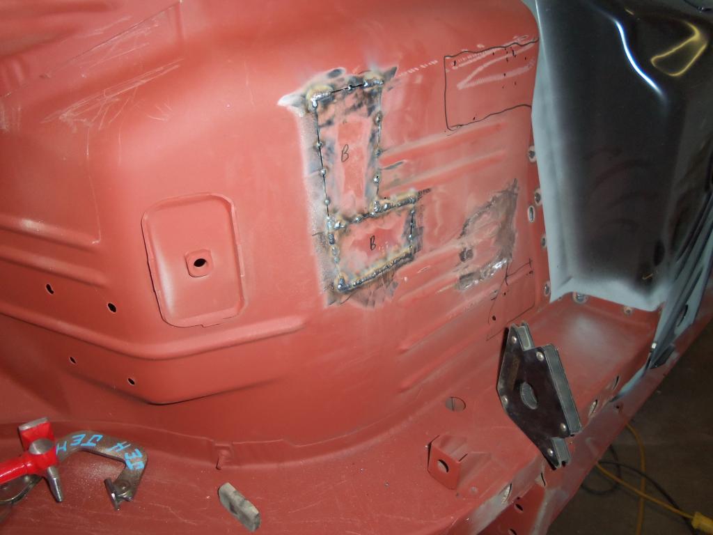

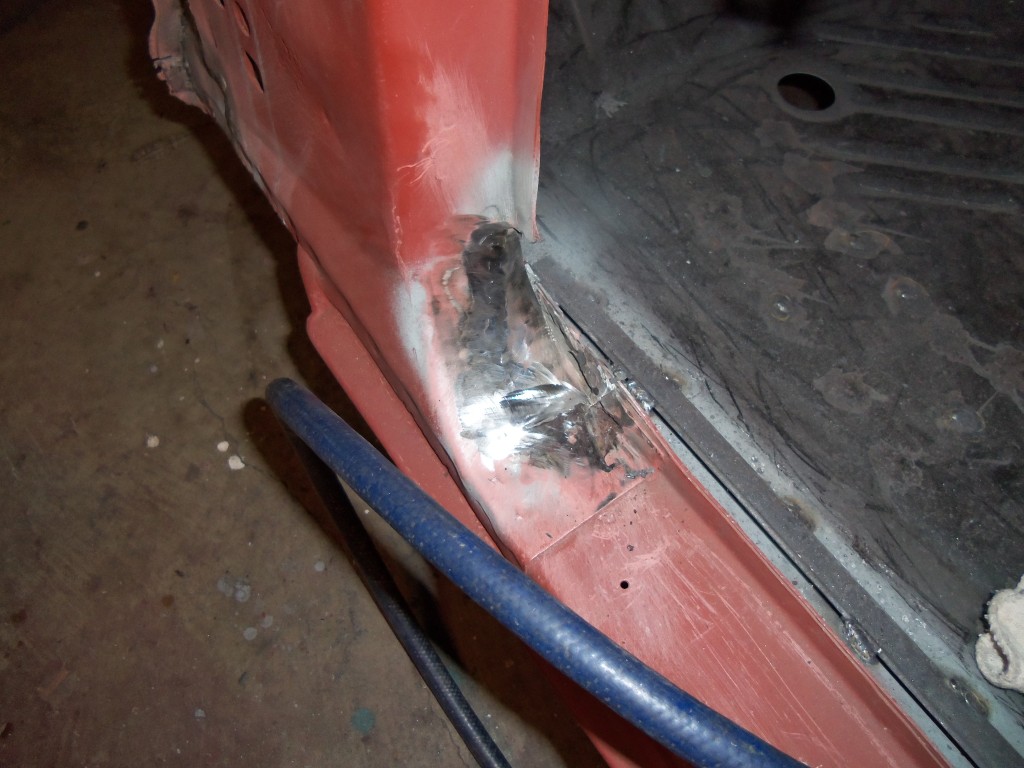

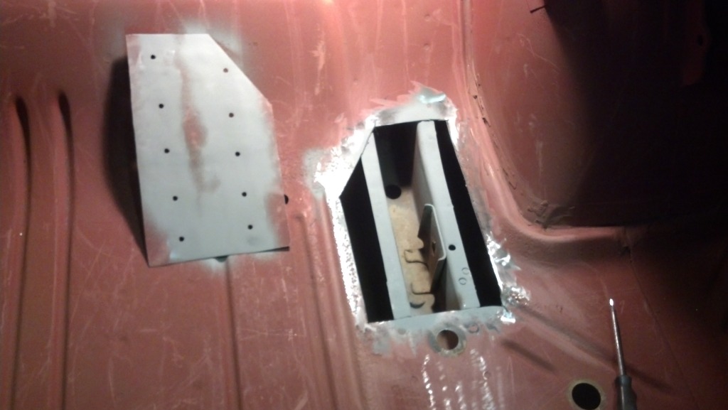

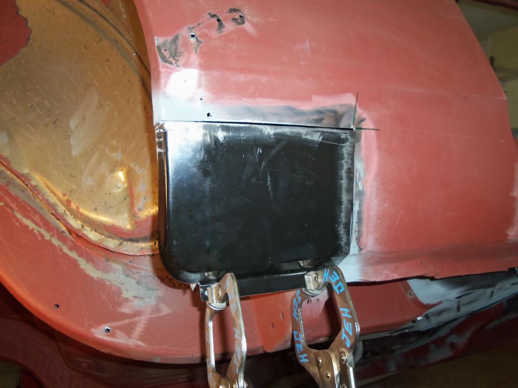

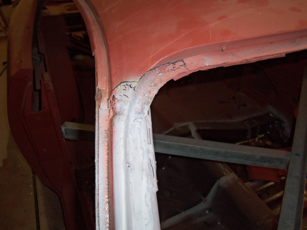

Hey All! Did some more work on the charger today!

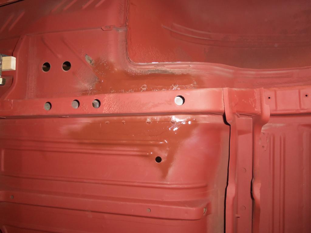

My spot welder comes in handy from time to time.

I had to stop here because I ran out of weld through primer. It sucks because I was in a good working mood.
On a separate note. I have been pondering what to do for sub frame connectors. I was about to make my own until I started browsing through the forum. I found a post about sub frame connectors. Some one posted a link to US Car Tool. I like what I saw on line. I was looking at the companies information and discovered they are based here in Durham. My apartment is just a short drive away, so I paid a visit to their shop and saw their operation. I was very pleased, although they said they were temporarily out of the sub frame connectors for the 71s. They said to contact them after new years. I also saw the torque boxes they make. I plan on buying a set of sub frame connectors and torque boxes with my next paycheck.

Got some primer, time to work!
I flipped it to get some sand out.
And I found this, more rust!
Save what you can, cut out the bad!
Rebuild it, piece by piece.
And clean it up on the back side.
