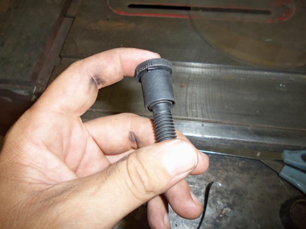

Disk break brackets for the front.
My dad bought some new media for the blast cabinet. This stuff works great!!!! It cuts fast and doesn't make much dust. I can even blast with out setting up the vacuum.
The door hing rebuild kit arrived today.
With a little bit of drilling and grinding I got everything together with no play.
I didn't take any pictures of the old pins, however they were worn pretty bad.

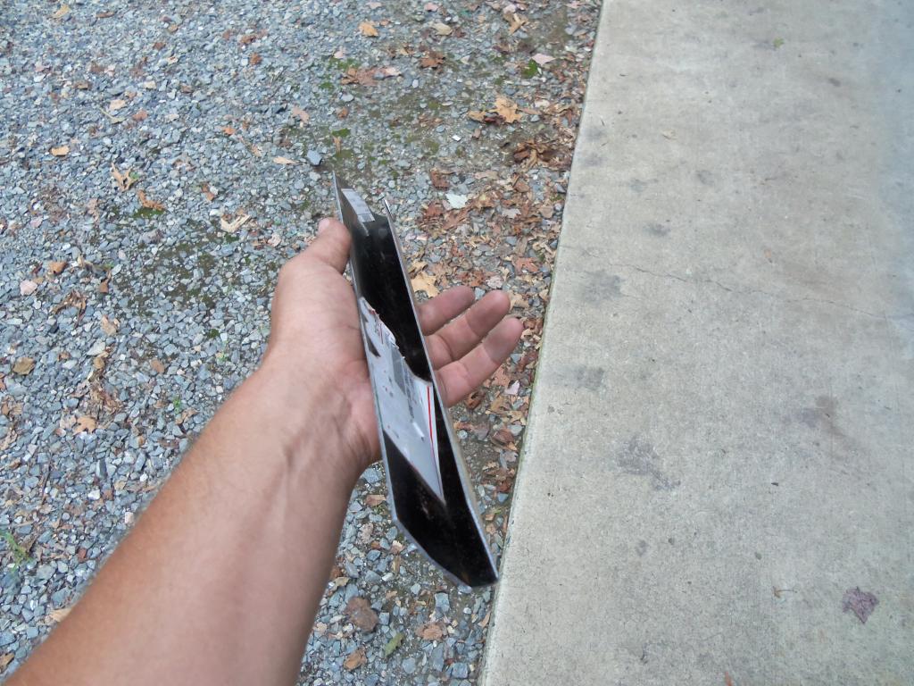

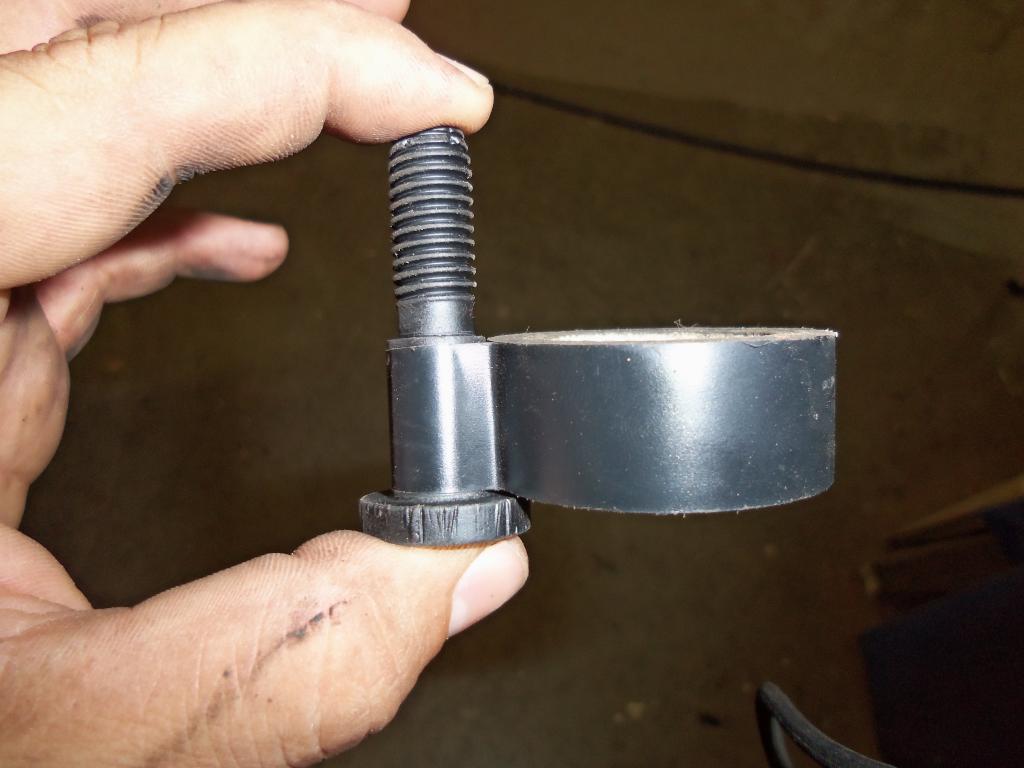

There was a piece of rubber on these strikers. Its gone now and I don't want to pay $20 apiece for new ones.

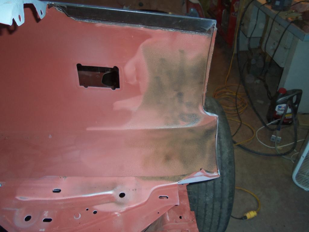

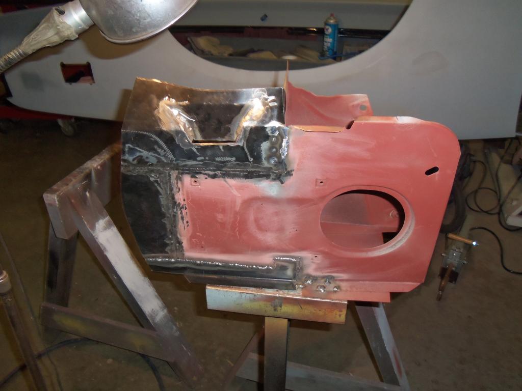

Ok time to get serious!
Lets keep those dents coming out!

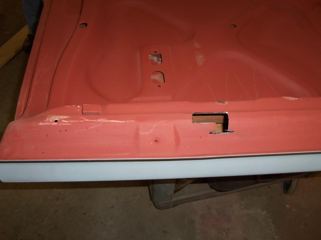

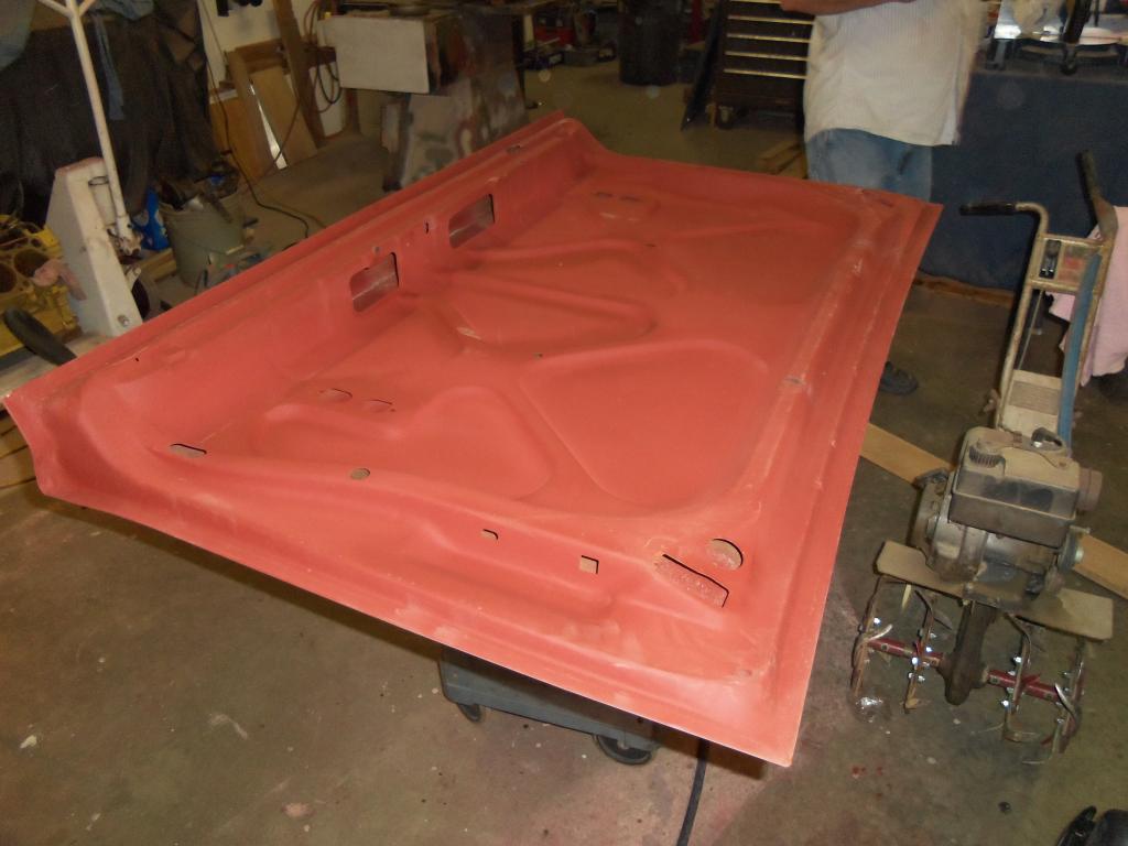

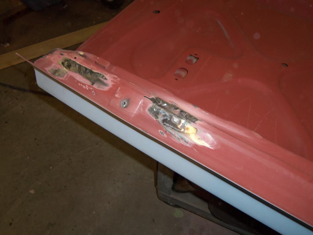

Trunk Lid!
Needs a little work.

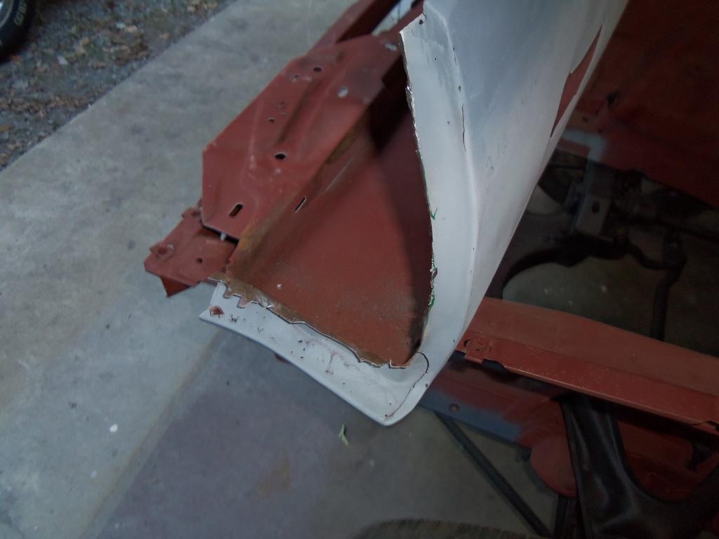

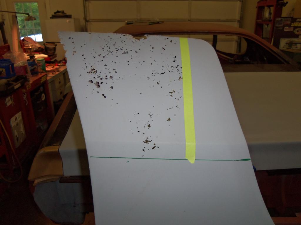

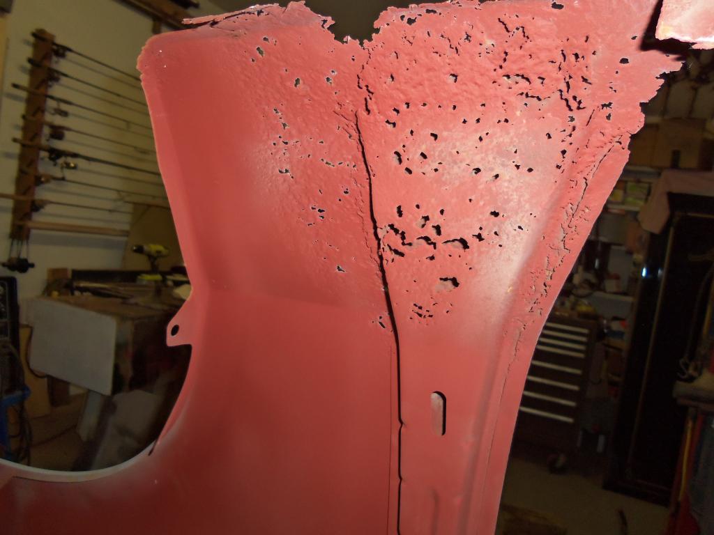

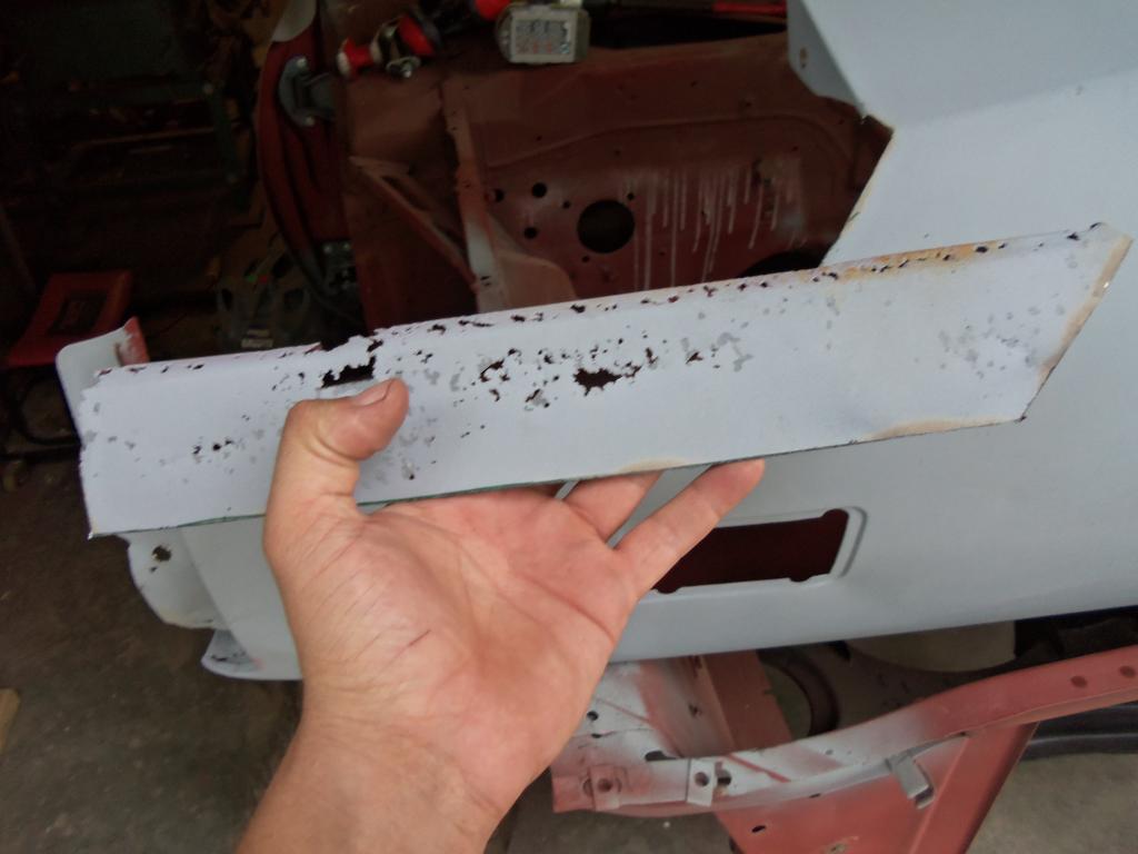

Front right fender looks like hell.
Take everything out of the way.

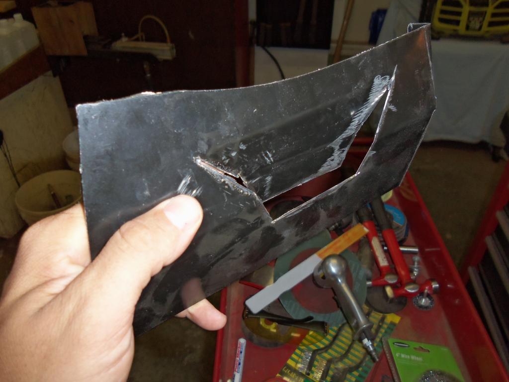

Cut out the bad.

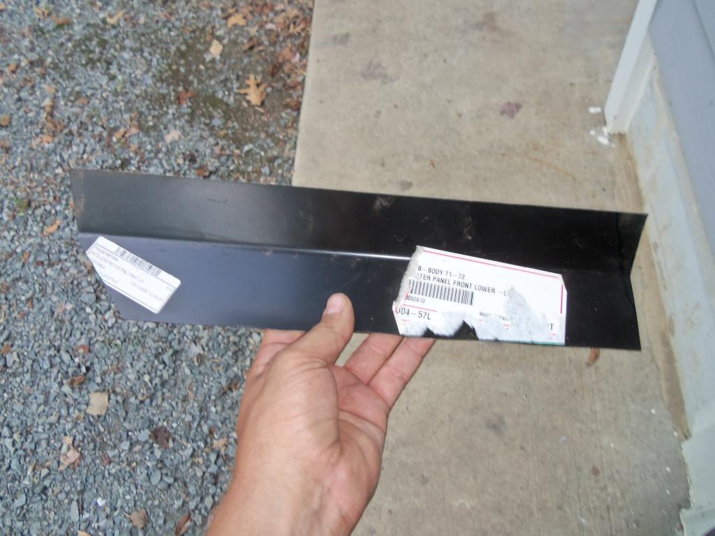

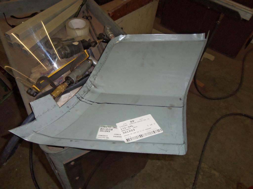

This should make a nice patch.

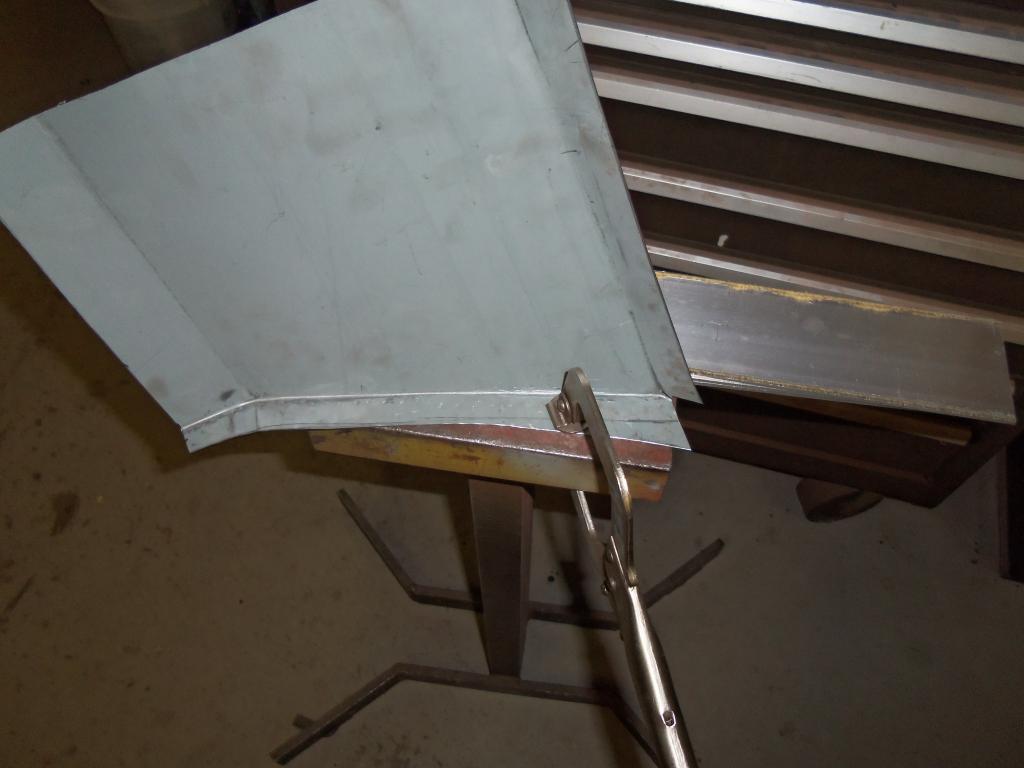

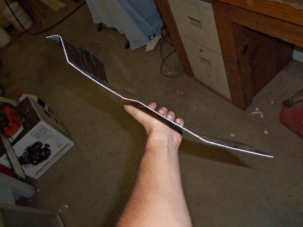

Cut it and bend it.

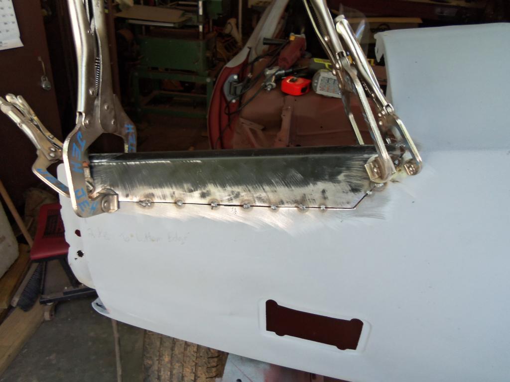

Fit it.

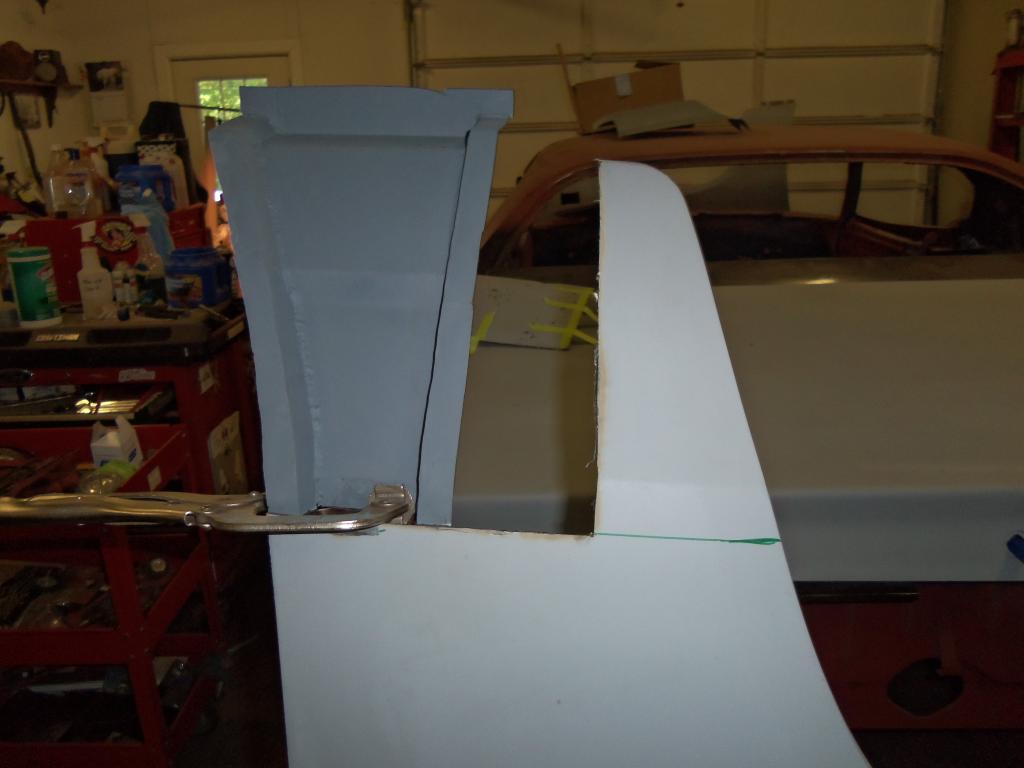

Bend it some more.
Fit it, mark it up, and clamp it in place.Name:  DodgeCharger439_zpsea2a6724.jpg
And this is as far as I got today.

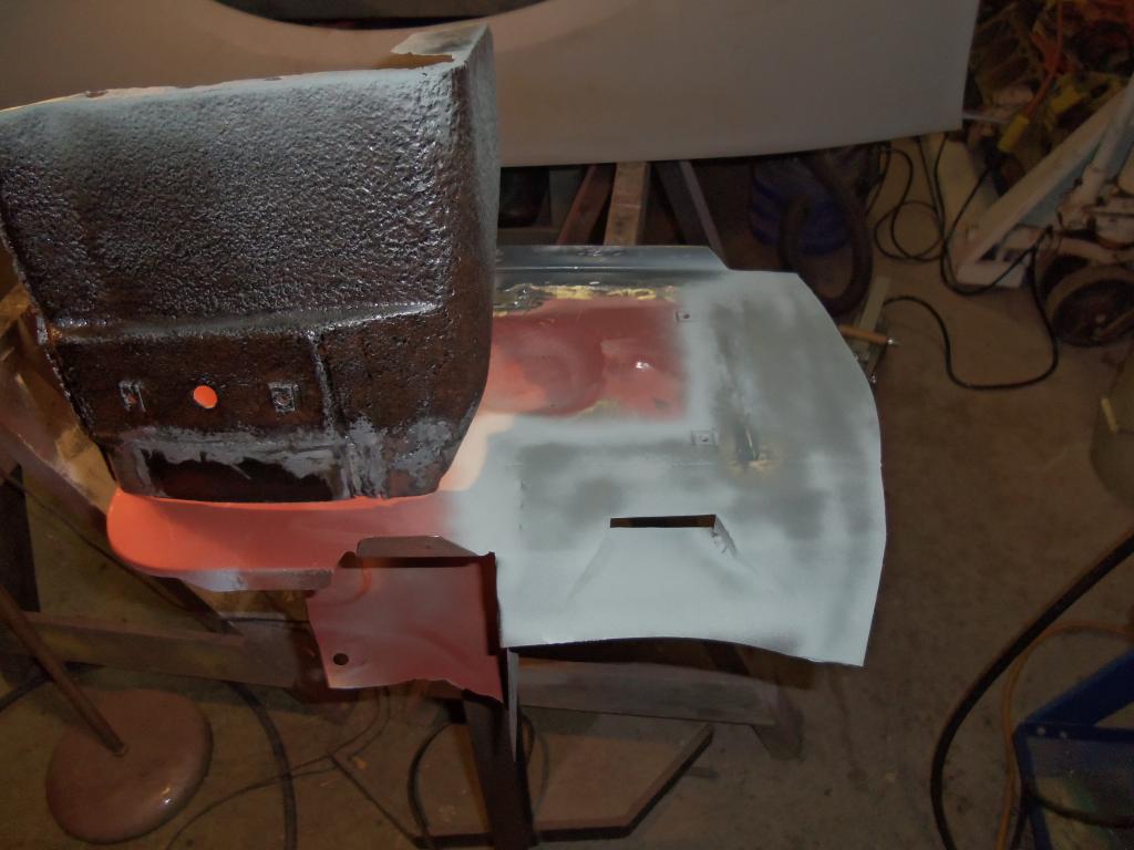

Lets start where we left off!

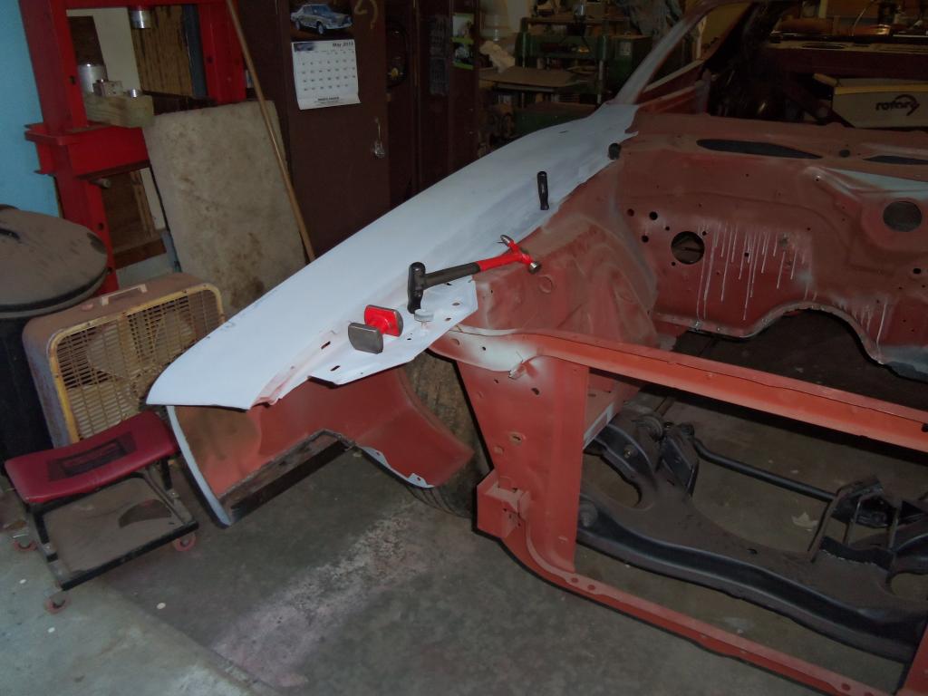

Really don't have a better place to hang it to knock out the dents.
But man does it look good on the side of the car!

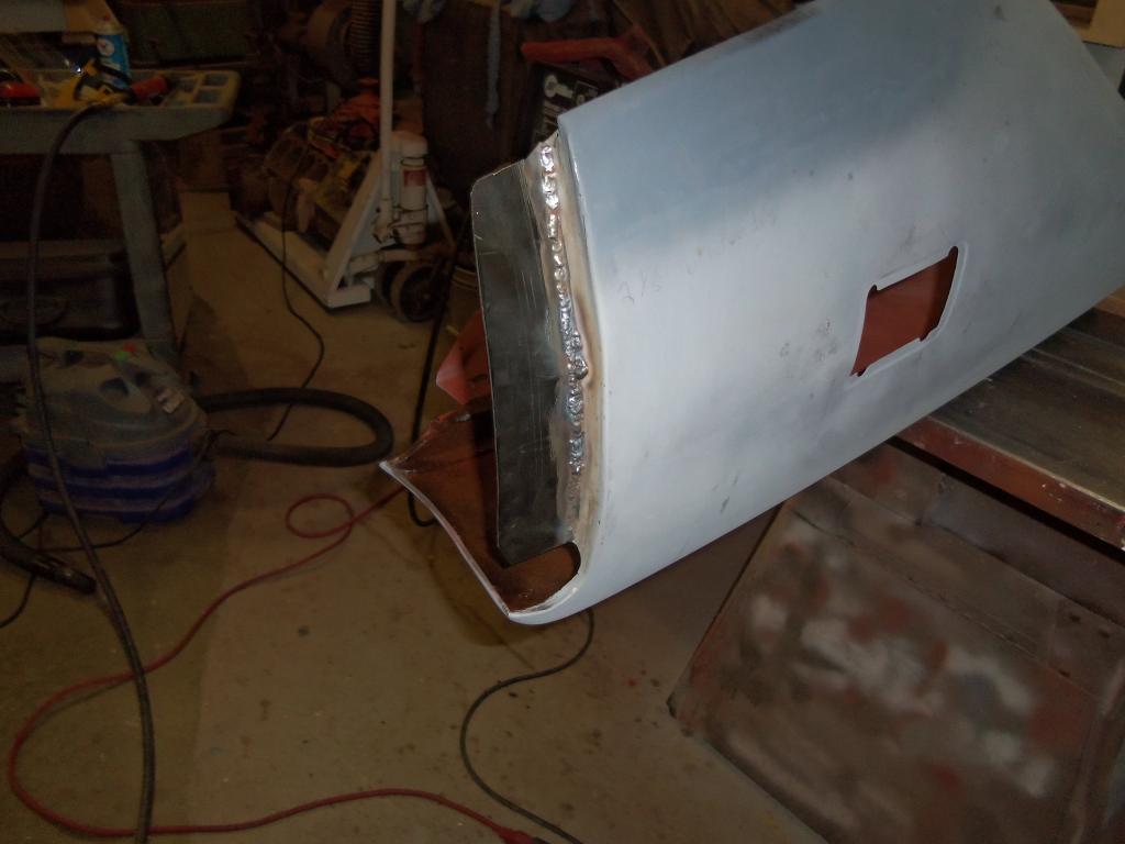

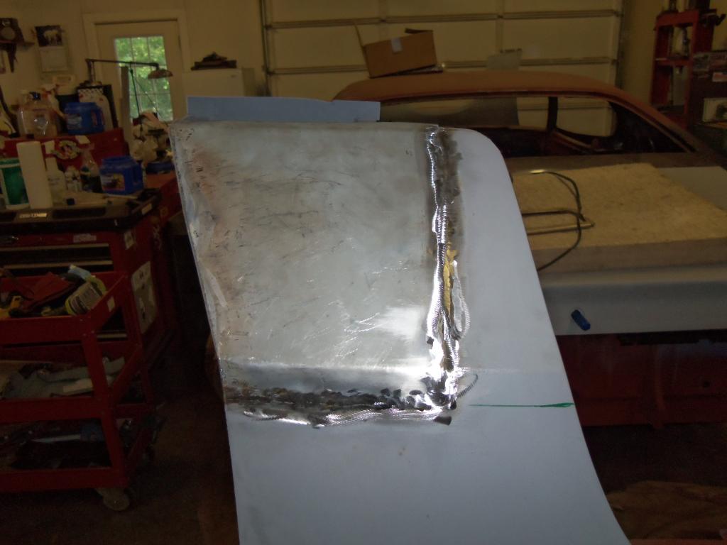

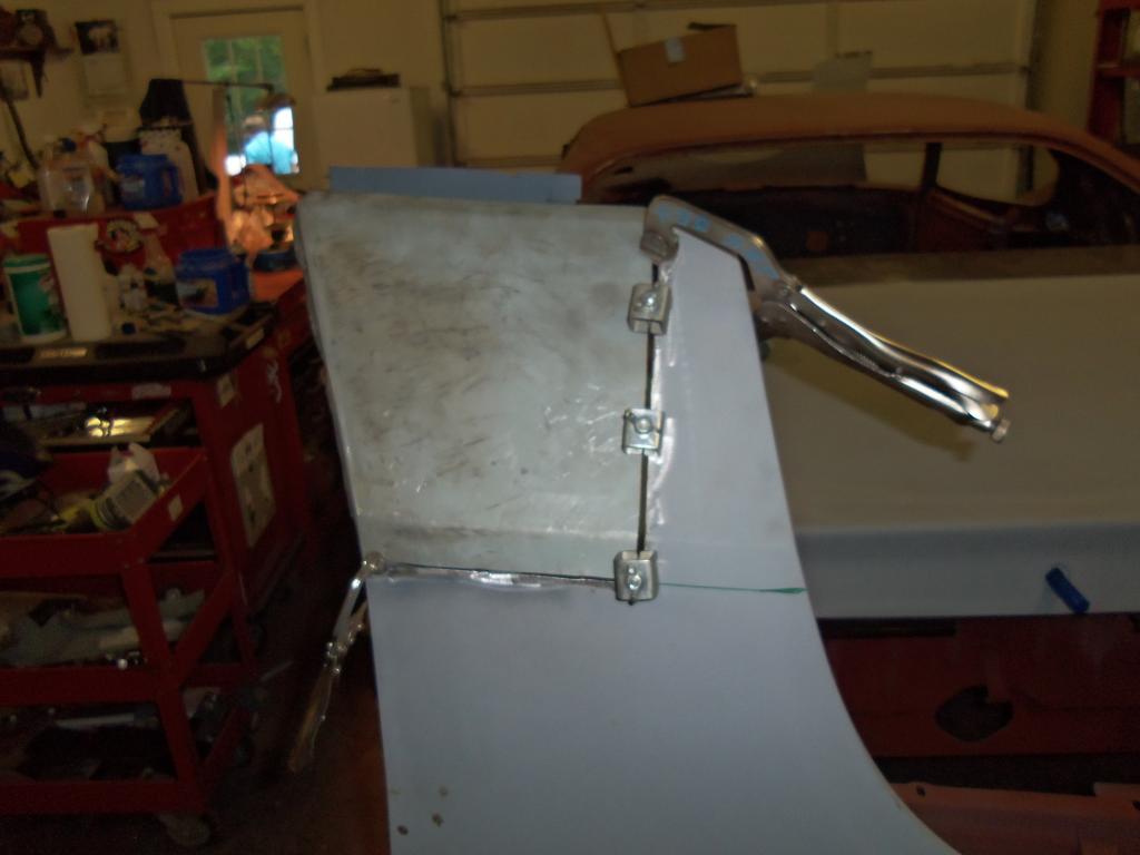

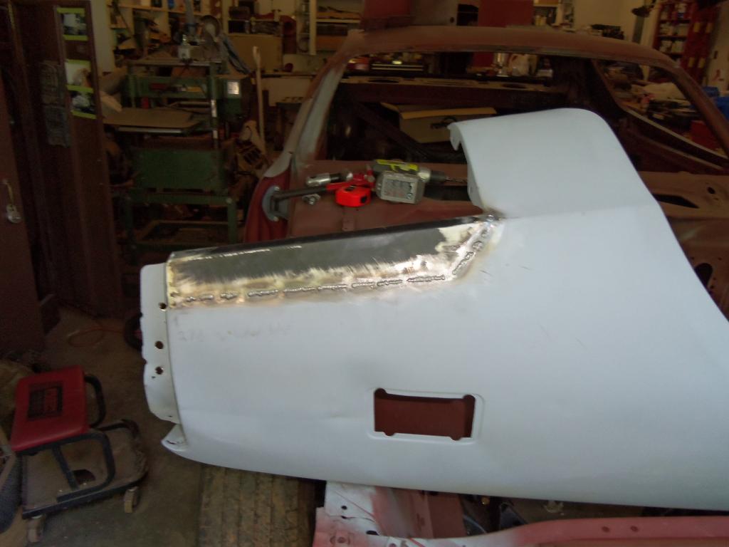

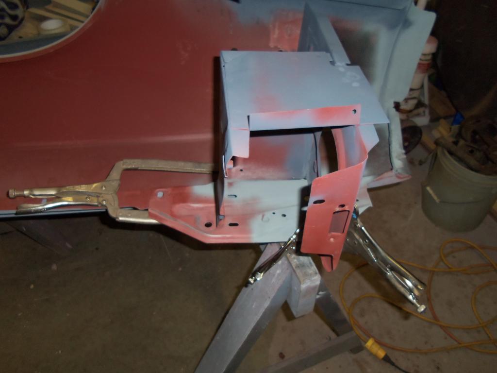

Back to welding!

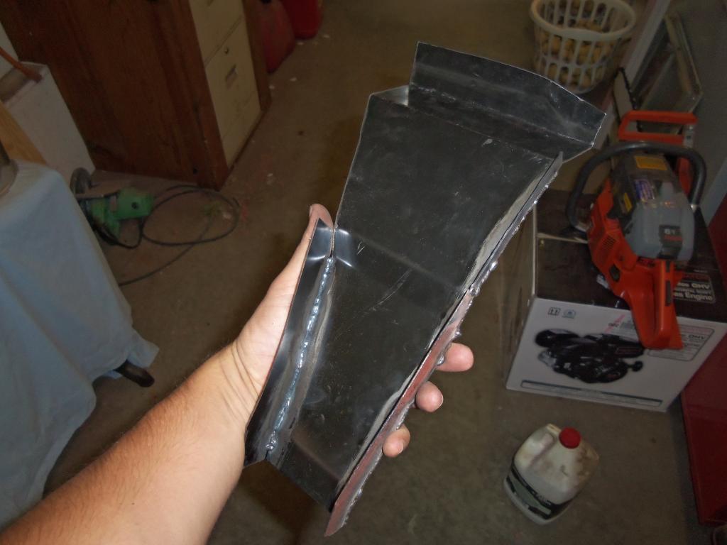

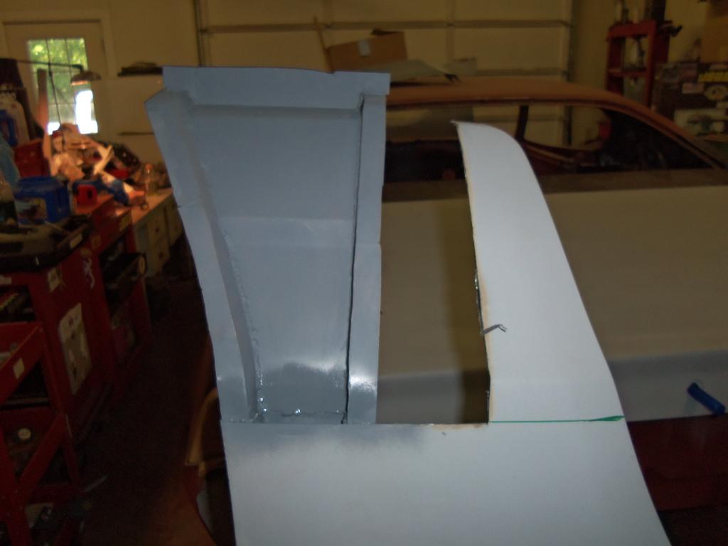

And for this piece.

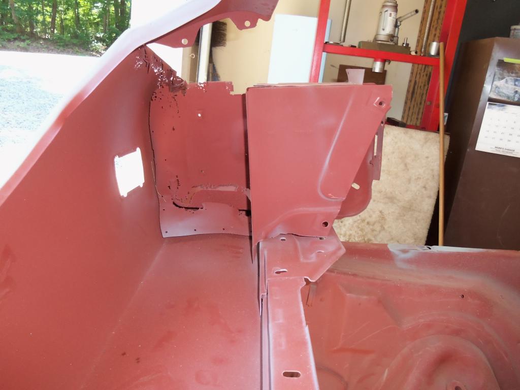

A little pin hole welding and priming!
More to follow soon!

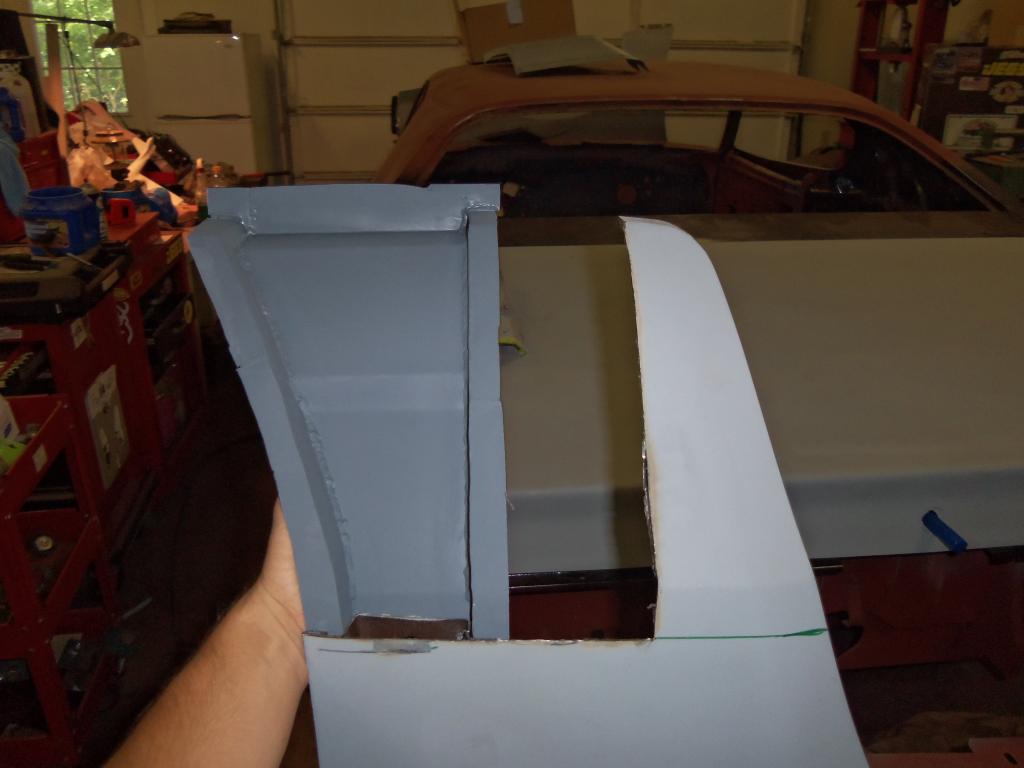

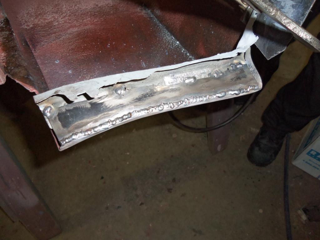

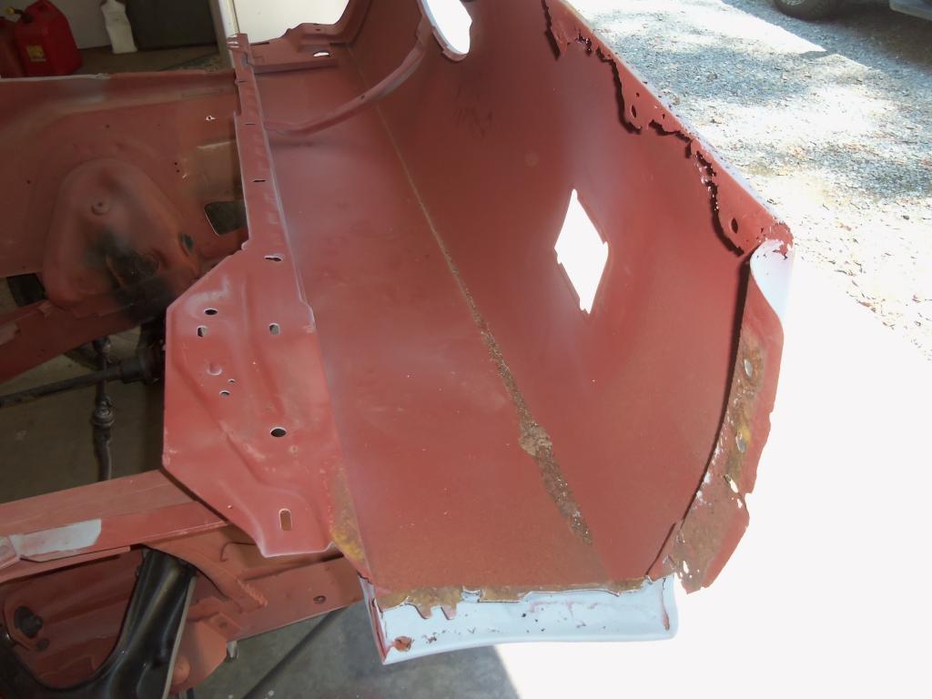

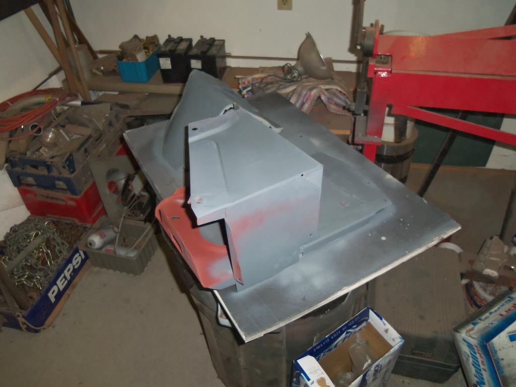

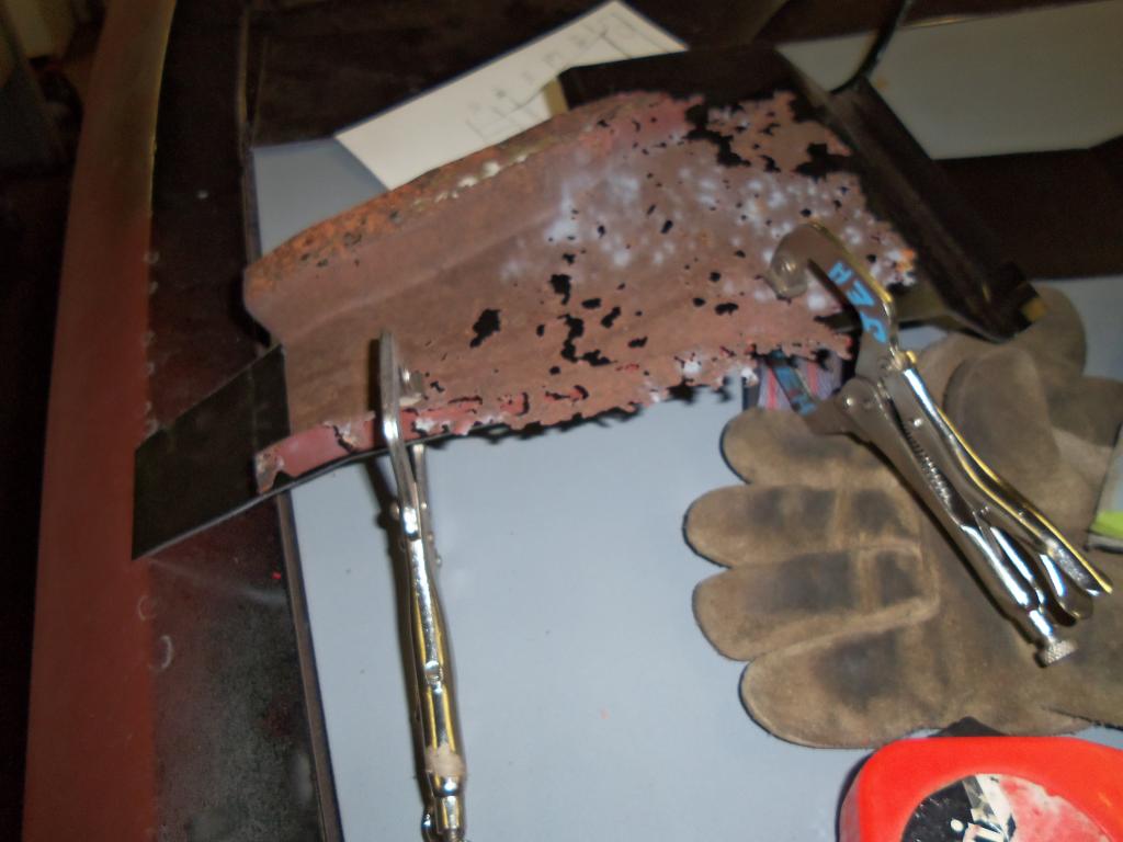

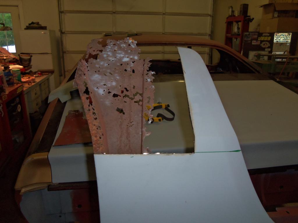

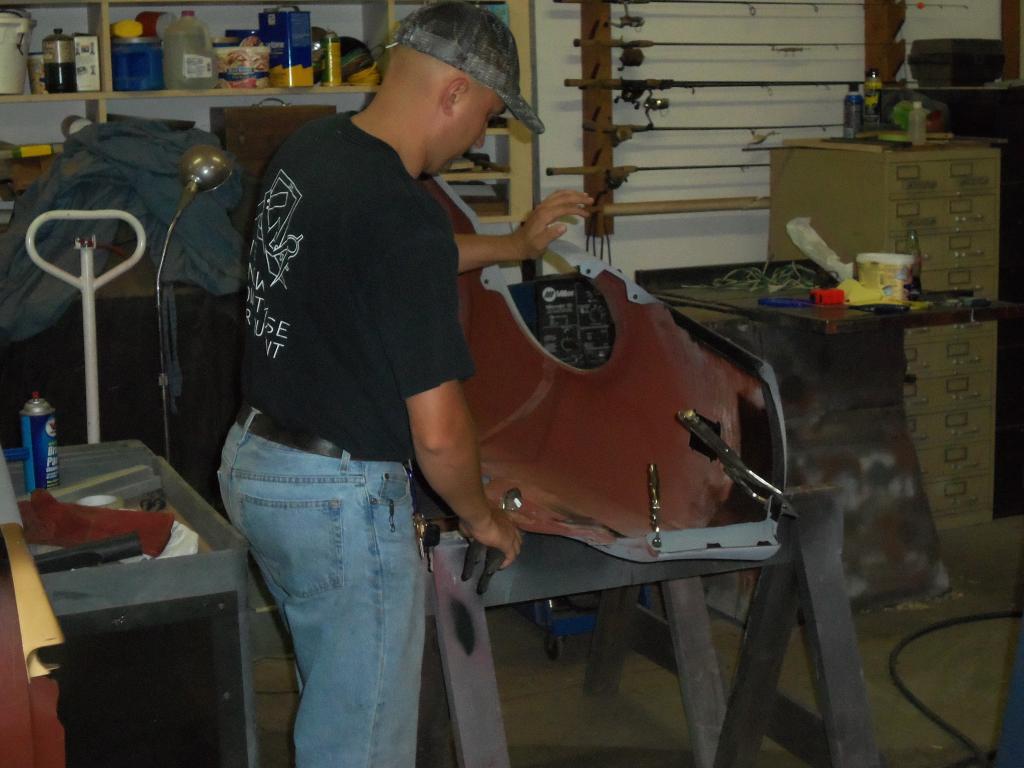

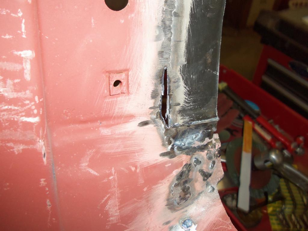

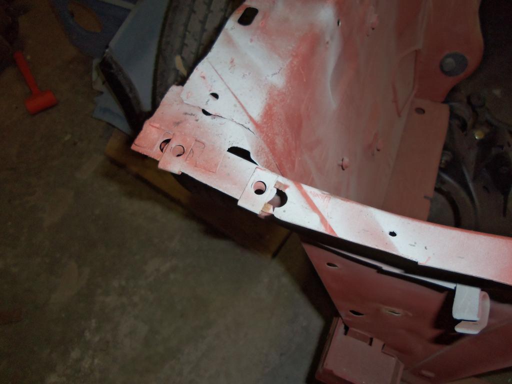

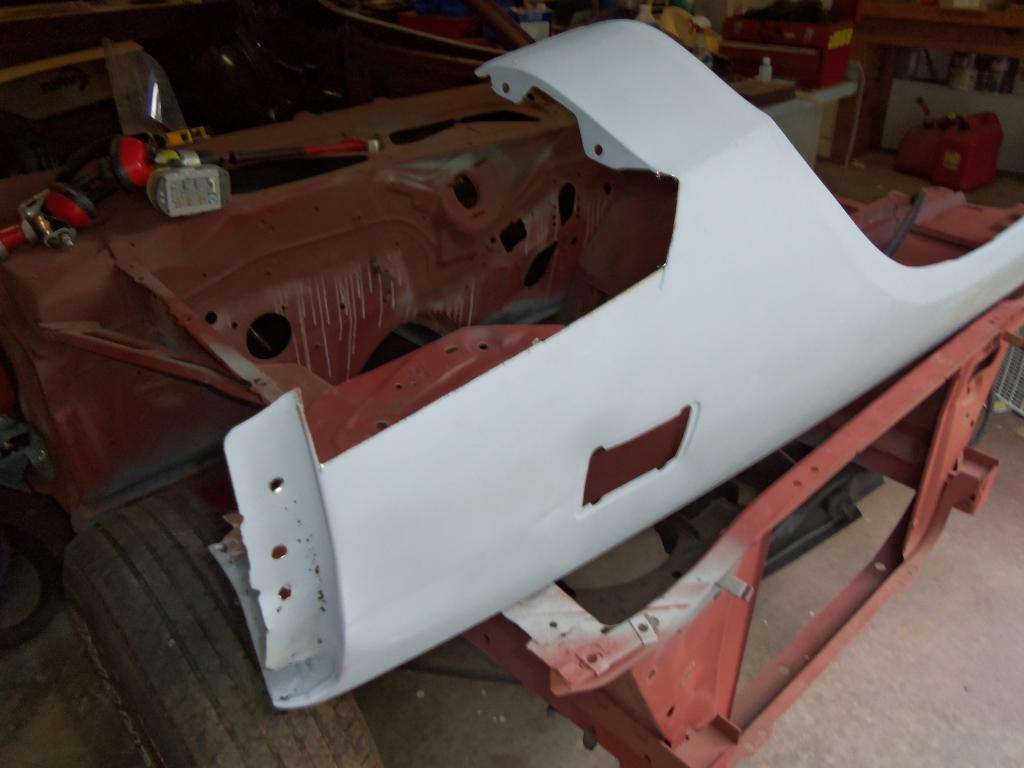

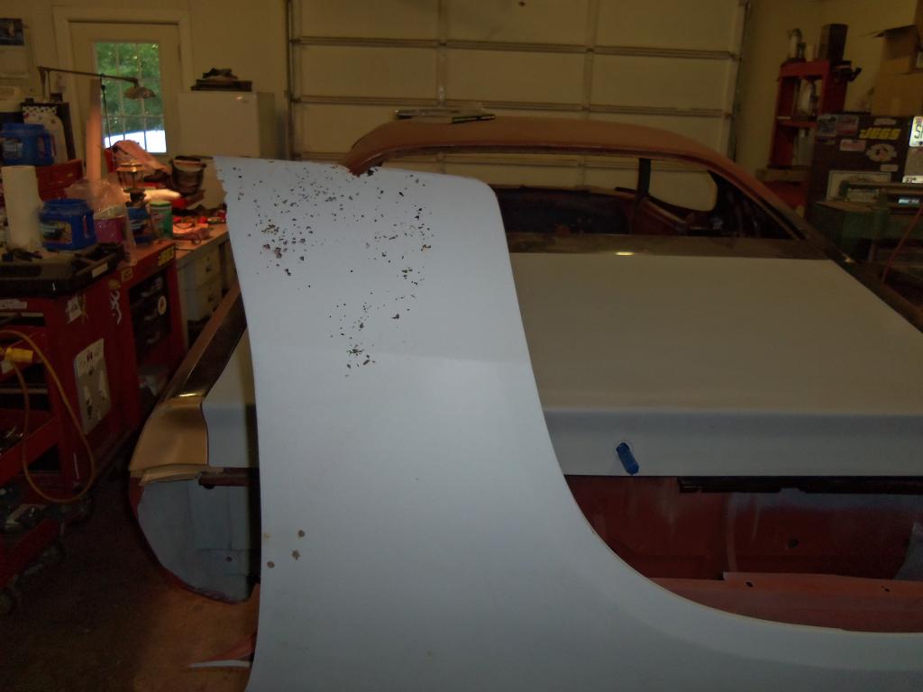

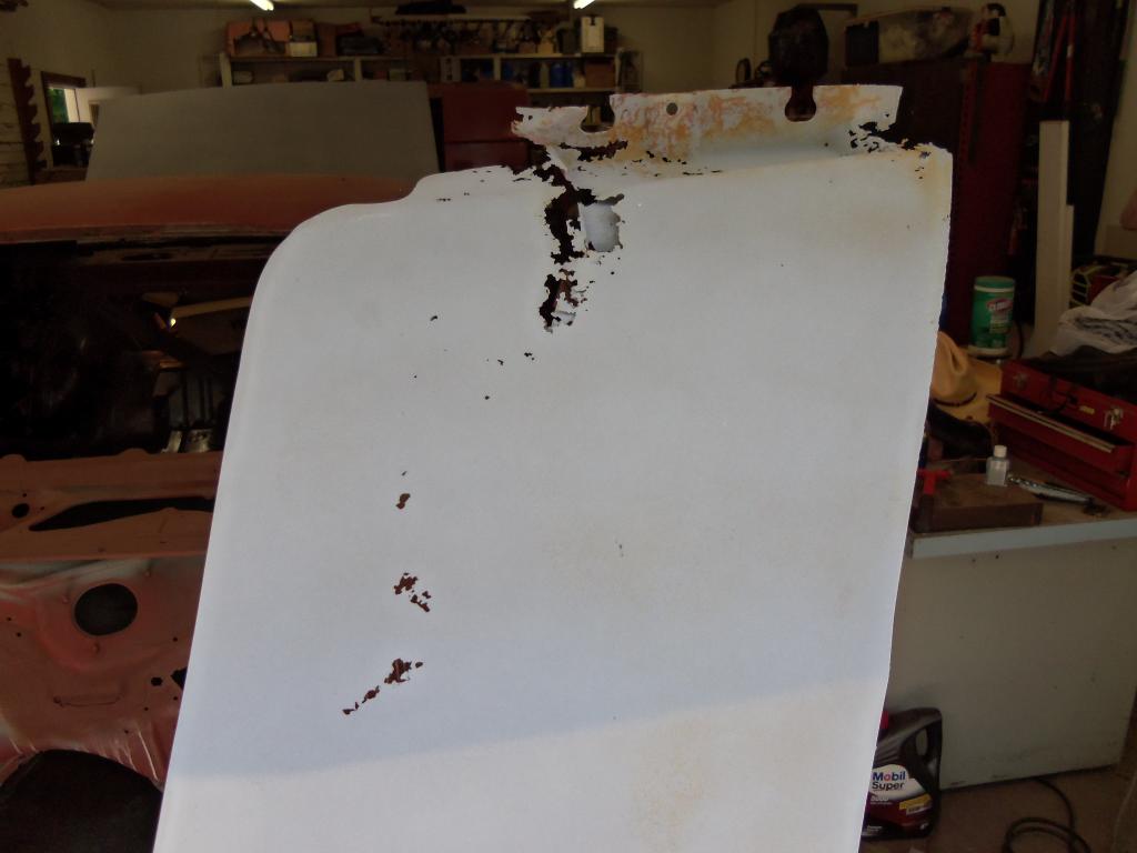

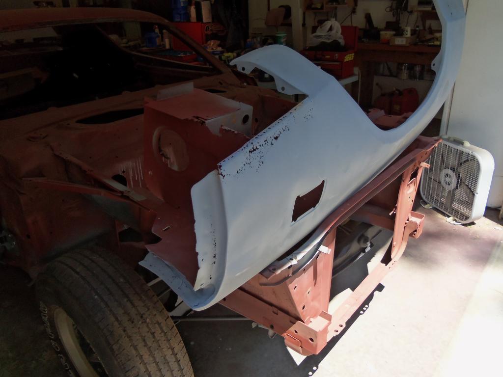

Third installment fender restoration!
Get a friend to help!
Take pictures!

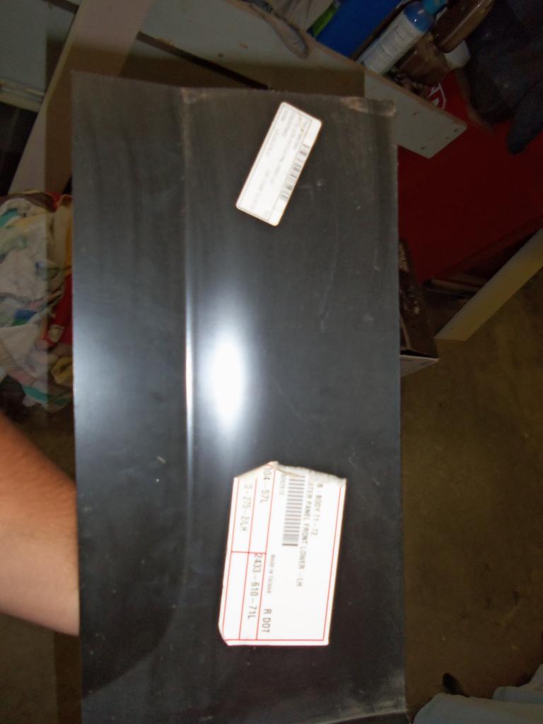

I love getting parts delivered! Its like Christmas, or my birthday!

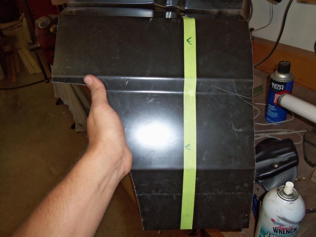

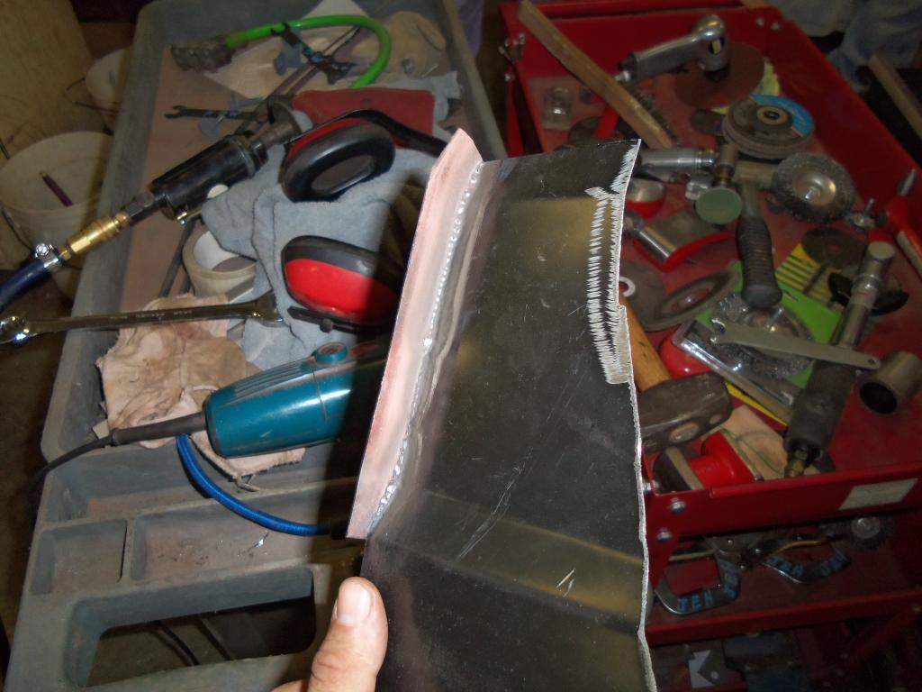

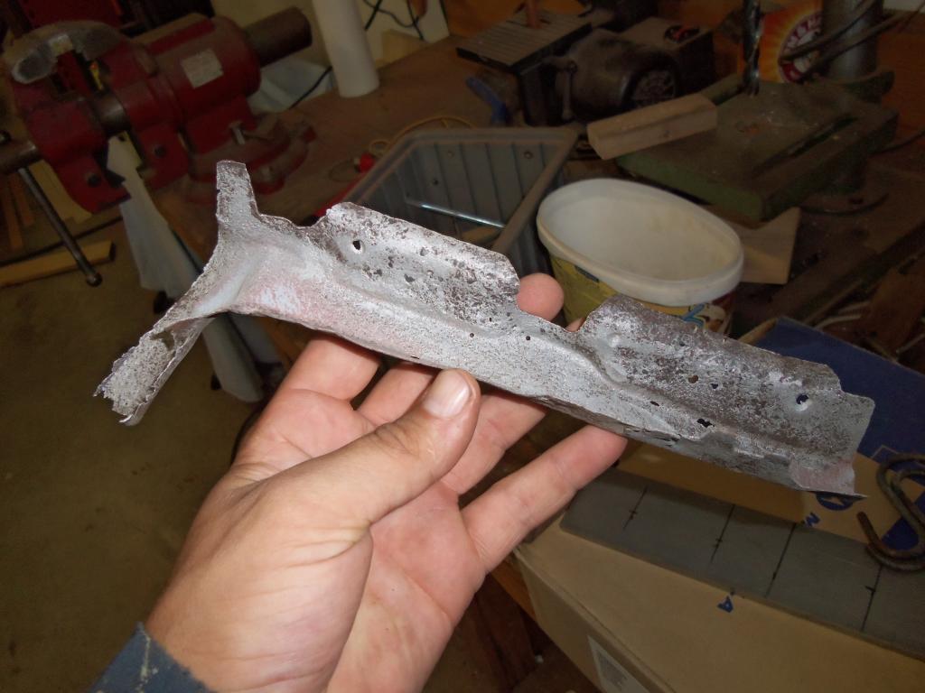

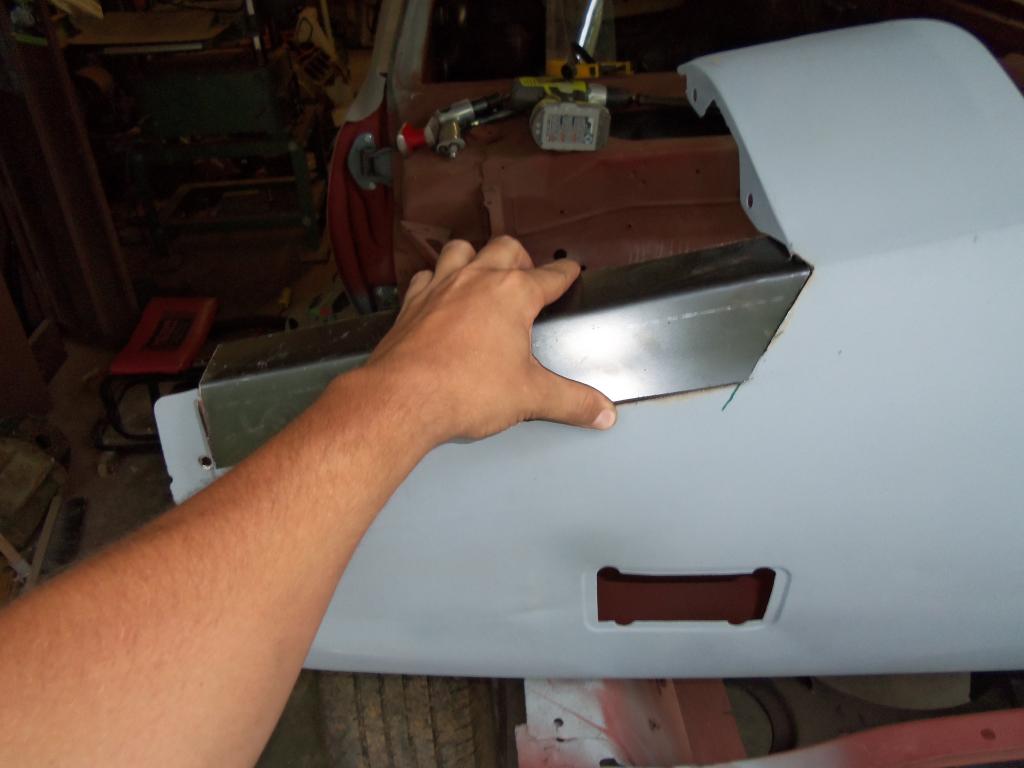

My friend Matt working on a patch piece.
He is not as fast as me, but two hands are faster than one.

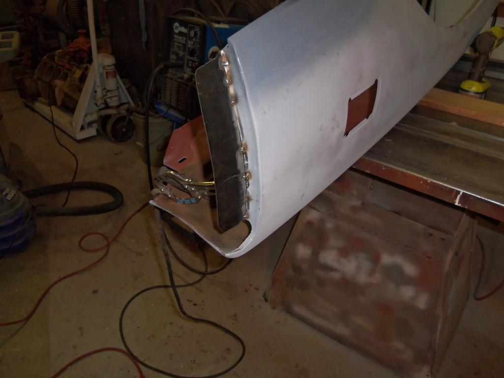

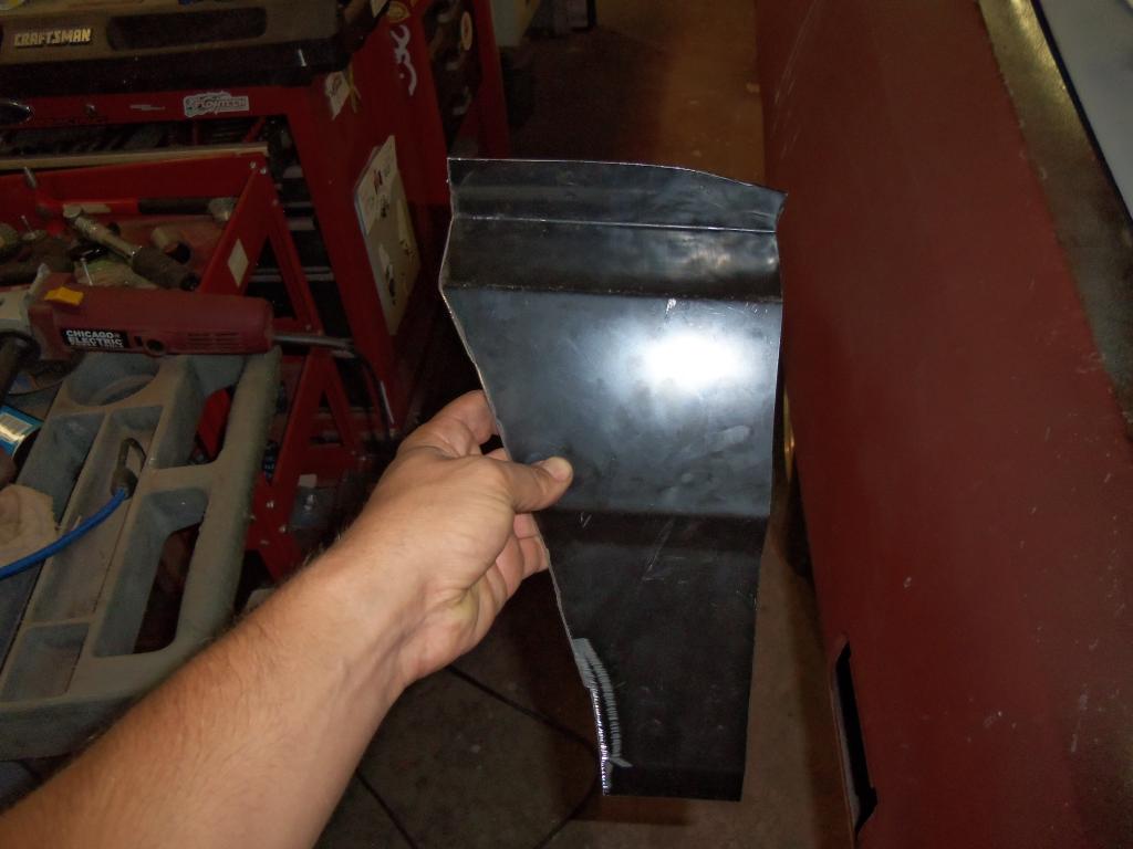

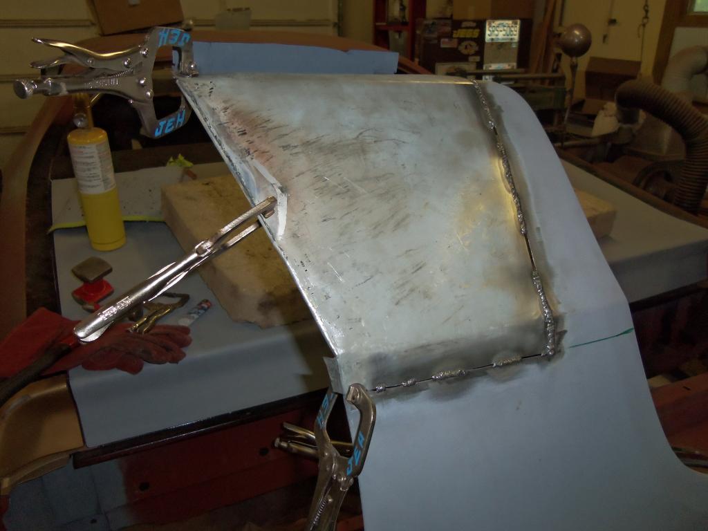

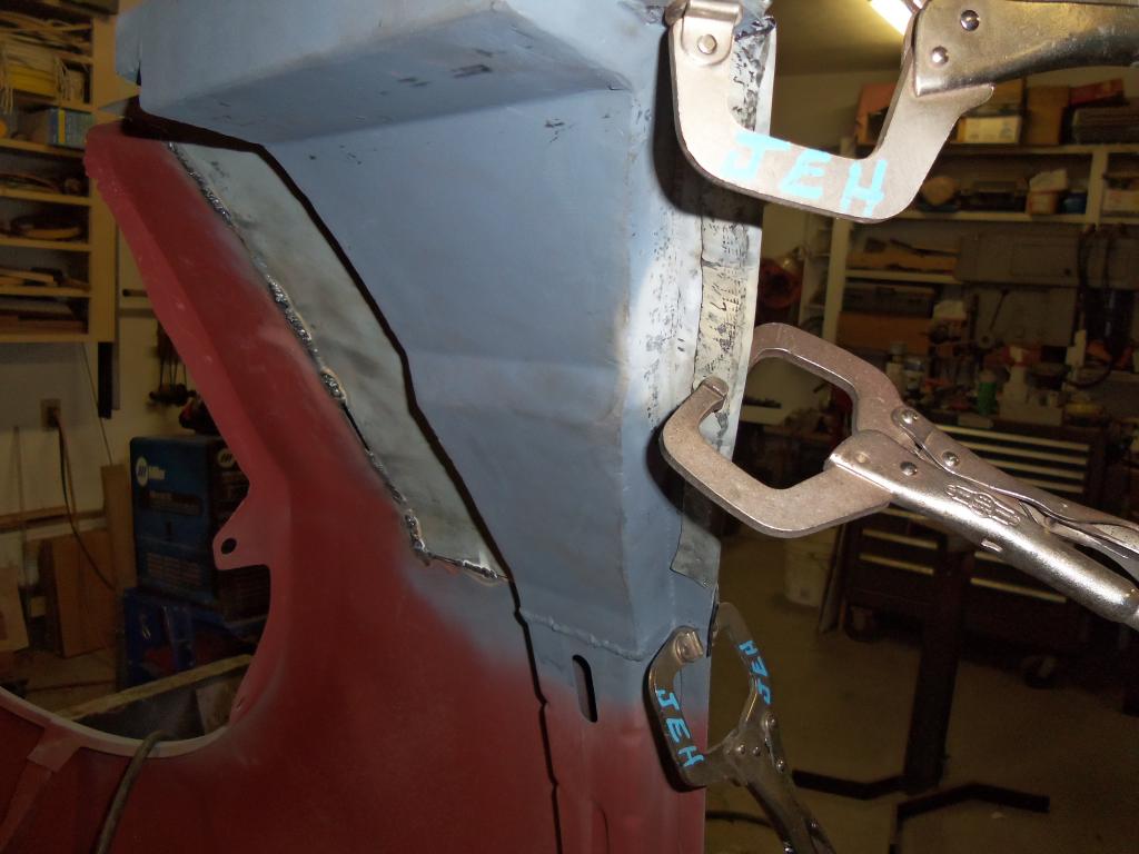

Ill handle the welding, you can make another patch!

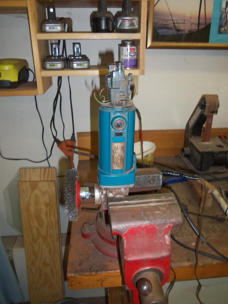

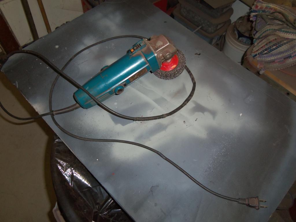

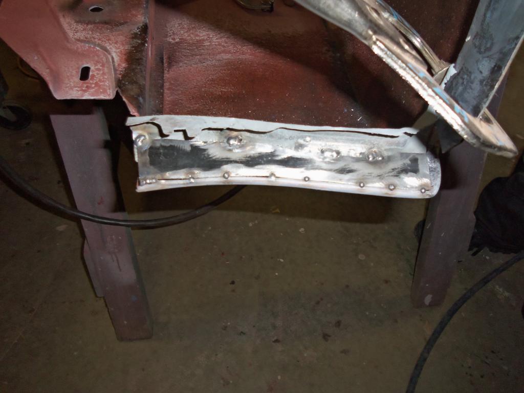

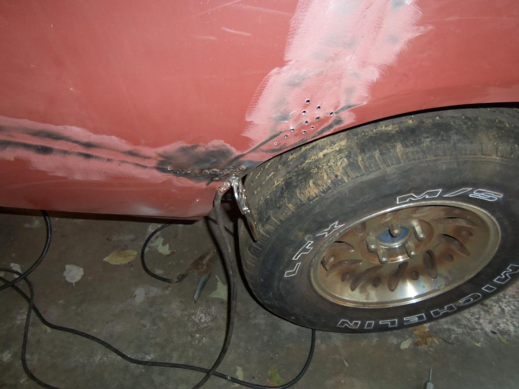

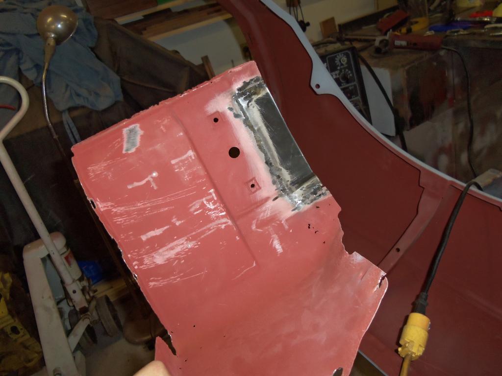

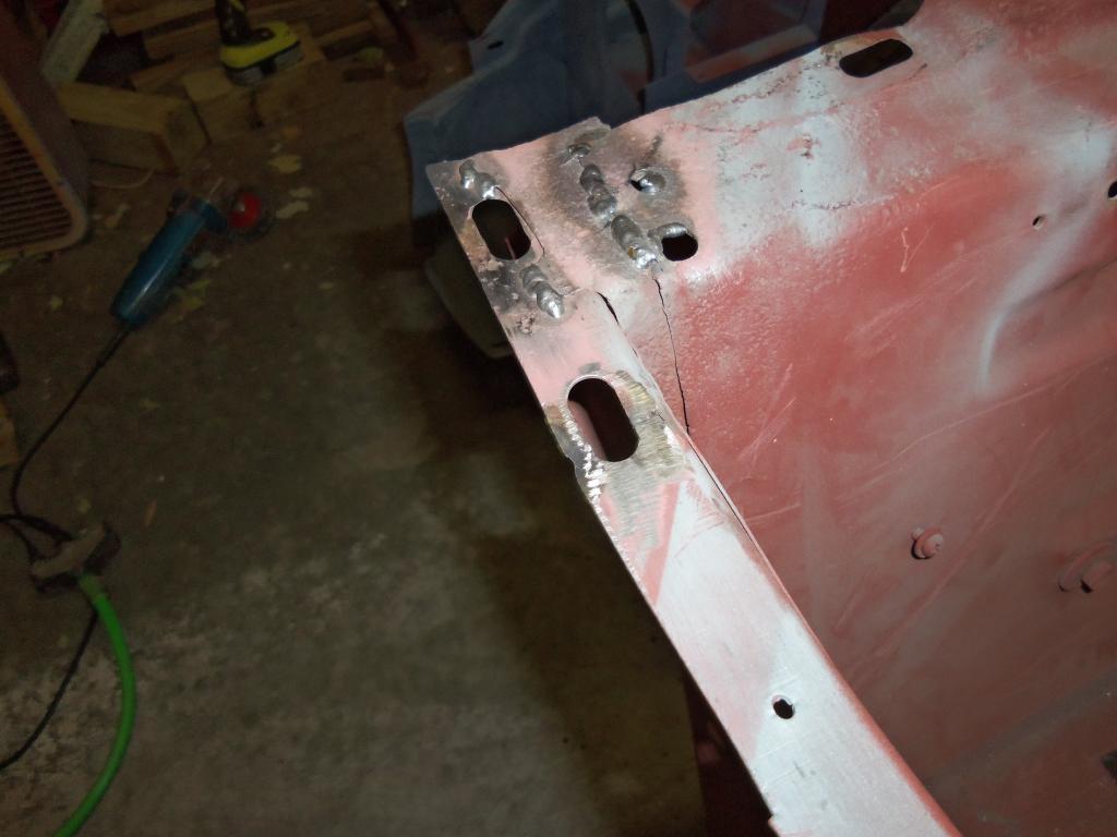

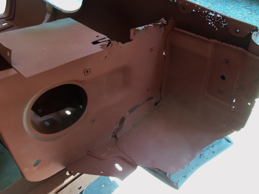

As I was welding my friend was wire brushing another section. I look up to see that the grinder has stopped working. This is a serious problem because the grinder is my DAD'S oldest and favorite grinder!

Ok so its Friday and the fender is not close to finished! God this takes a lot of time!
here is where I'm at.
So I messed up on this one the other day. Nice thing about metal, cut it and re weld it.
I got called into court Thursday so all of this happened Wednesday. I'm hoping I can get this wrapped up this weekend before Work starts back Monday night.

End of a week.
Primed up the finished pieces.
Fit it and clamp it into place.
Got some use out of my spot welder.
A lot of use out of it.

The front of the car had to be hammered back into place for the fender to fit.

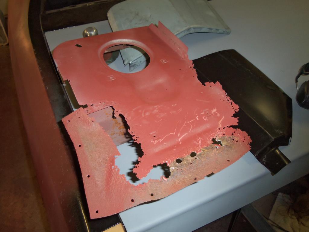

On to the other fender.

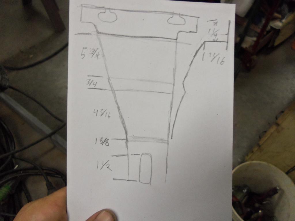

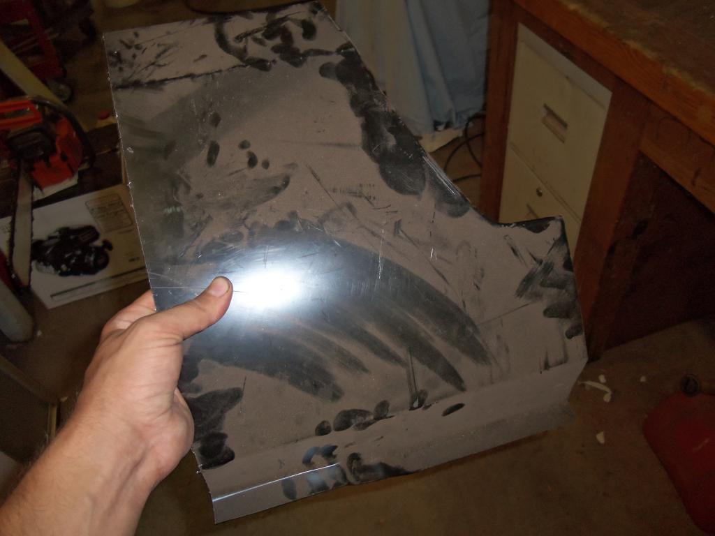

Had to knock up a sketch and measurements for the brace.
This should work for a replacement brace.
Got the bends!
Cut lines.

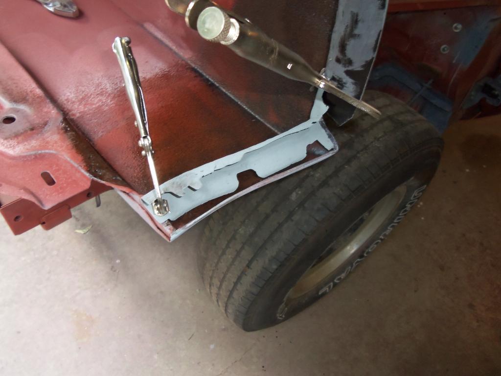

Start bringing out the sides.
And that's where I stopped I will get back on it next weekend.

Some work on fenders.
I hope to have this one done tomorrow!

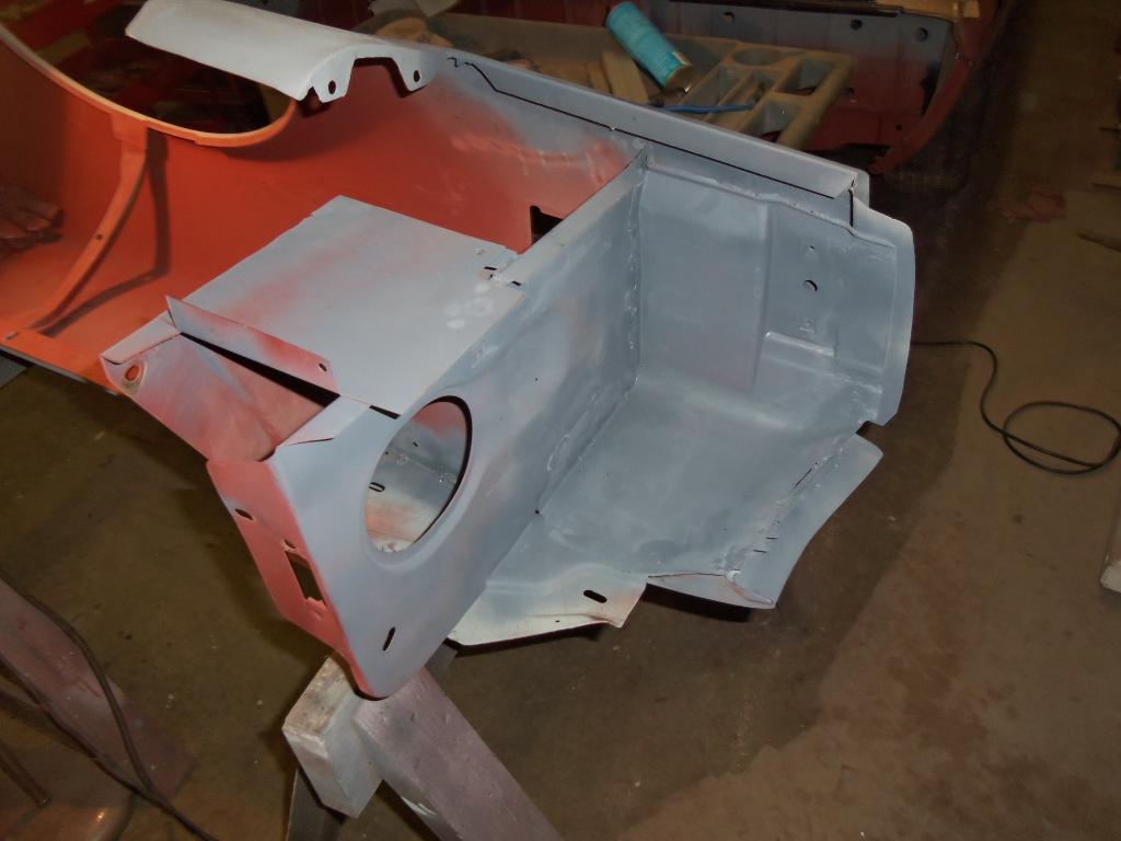

Finishing up the left fender.
Just a loose fit on the car.
