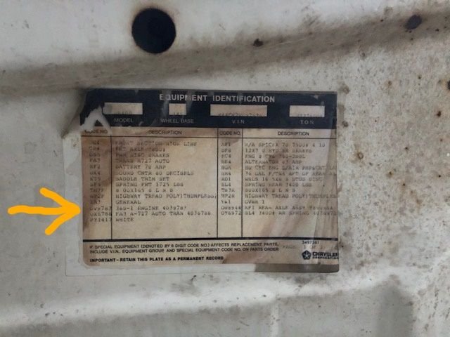

I am rebuilding my MOTORHOME and would like more information on CAM (specifications), CYLINDER HEAD CC, INTAKE & EXHAUST VALVE SIZES for the "360-1"
I pulled out my 360 Dodge engine ( Engine code from underneath hood of motorhome - OV9783 360-1 4039783 shown in picture).
Shows the code number for the build, Engine Code, then the casting number of the original motor.
