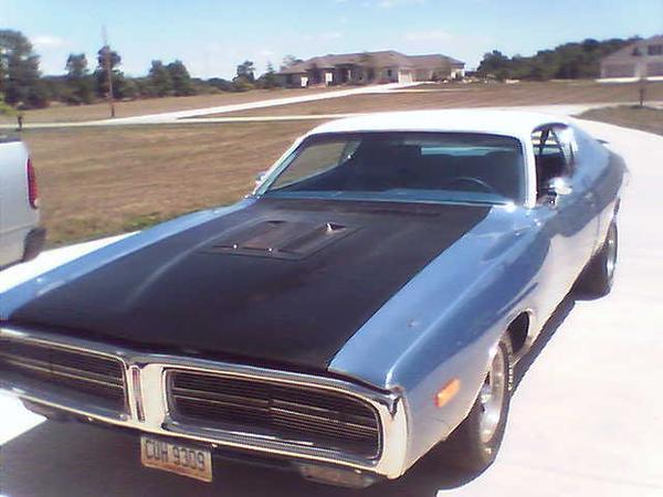

i have air shocks in the back of my car and the more i raise it up, the worse the front will drag.
Originally Posted by 64polara
my headers hit the ground to. Ive only got 4 in. from the ground.
the sucky thing is i wanted to lower the front a little and raise the back, but not sure how that is going to happen.

My guess the problem is a combination of your ride height and wheel/tire setup. I went with 15" all the way around and even with the chunky BFG's the header ground clearance is a little low for my taste on stock ride height specs.

i cranked the torsion bars up and havent hit the ground yet. and i havent had the steering get stuck either. so i gess that did the trick! the stance is higher but still looks good i think.
thanks for your help guys!!!!

Cool - the stance looks fine. IMHO. The wheels "look" a little small both front and rear, so a larger wheel / tire diameter may be something you might want to consider in the future - no rush, she's looking good.
The more I think about it, I did have the same problem when I was running a small block, and that was the fix!

after messing with your torsion bars you might want to get your alignment checked adjusting them up or down can throw it off
very nice lookin charger

yea i noticed the steering is different, im going to get it alignment asap.

Whoa... whoa... you just can't go *****-nilly & crank up the torsion bars. They are an alignment specification = ride height. With the proper size wheels & tires, tires properly inflated, the height must be then measured. From a level ground to the lowest point of the steering-arm vs. the lowest point of the adjusting pivot. There will be a difference. It must be what the specs are for your car. Somewhere around 1 7/8 , but the specs must be checked for the specific year & model. Then, caster/camber/toe-in are adjusted. If your headers hit the ground after the alignment, you have bad shocks or bad headers.

Sorry to break this to you but a lot of the cars we're discussing are no wear near stock. The torsion bars can and in a lot of cases should be adjusted to the specific situation. Also, given the age (and history) of a lot of our cars, the frames are less than perfectly straight. So, while what you're saying may be correct, it has to be taken with a grain of salt - and frankly, adjusting ride height via torsion bar adjustment has been done successfully too many times to debate.

Install a good set of front shocks. Your stance looks fine. Then after the shocks are on, if it still bottoms some and steering locks then crank up the torsion bars a little. I believe you will be amazed at the difference a good set of shocks will make.
