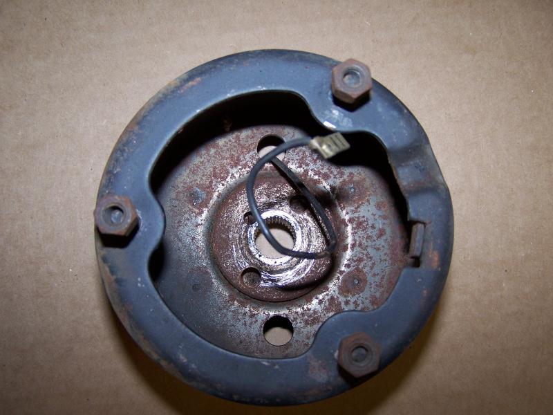

I scored a rusty Tuff wheel adapter off of eggbay for 85 bucks. I stuck it in the rust bucket last night and we will see how well the Evaporust takes care of it. This is how it was before it went in the bucket.

I took my visor off last night and took it to the PPG paint store near me. I got a half of pint of DBI interior paint for 33 bucks. I want the steering adapter to match the steering column color. It came out of the rust bucket nice and rust free. I used paint stripper to get the rest of the paint off then wiped it down with laquer thinner. It has some flash rust on it which will be sanded off with some 600 grit before primer.

I broke the Tuff wheel adapter rules and painted it to match the steering column color.

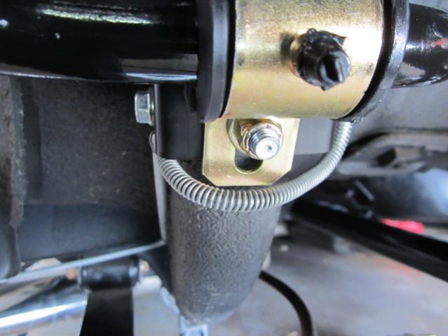

I got it installed but won't do it shame with anymore nightime photos. I had to shim the bottom of the Firm Feel brackets with one inside washer on the outer bottom and two inside washers on the inside bottom. I did it by myself and scratched it a little. No harm cause you can only see some of the gray powder coating underneath. So hear goes some moring pics and will drive it on Saturday in 72 degree weather.

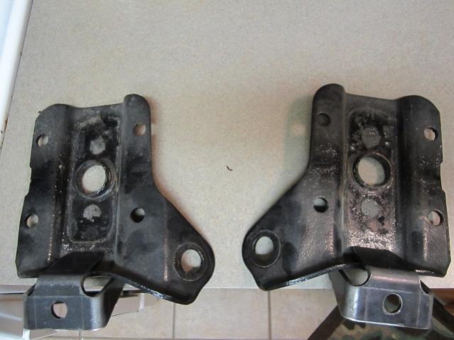

The cop car bar and upper shock/leaf spring mounts cost me 200.00 used but gray powder coated. The sway bar endlinks were from Energy Suspension and the sway bar frame brackets came from Firm Feel. I think they were 100.00 bucks. I have my old upper brackets and weld on sway bar brackets for 40.00 bucks plus shipping.
