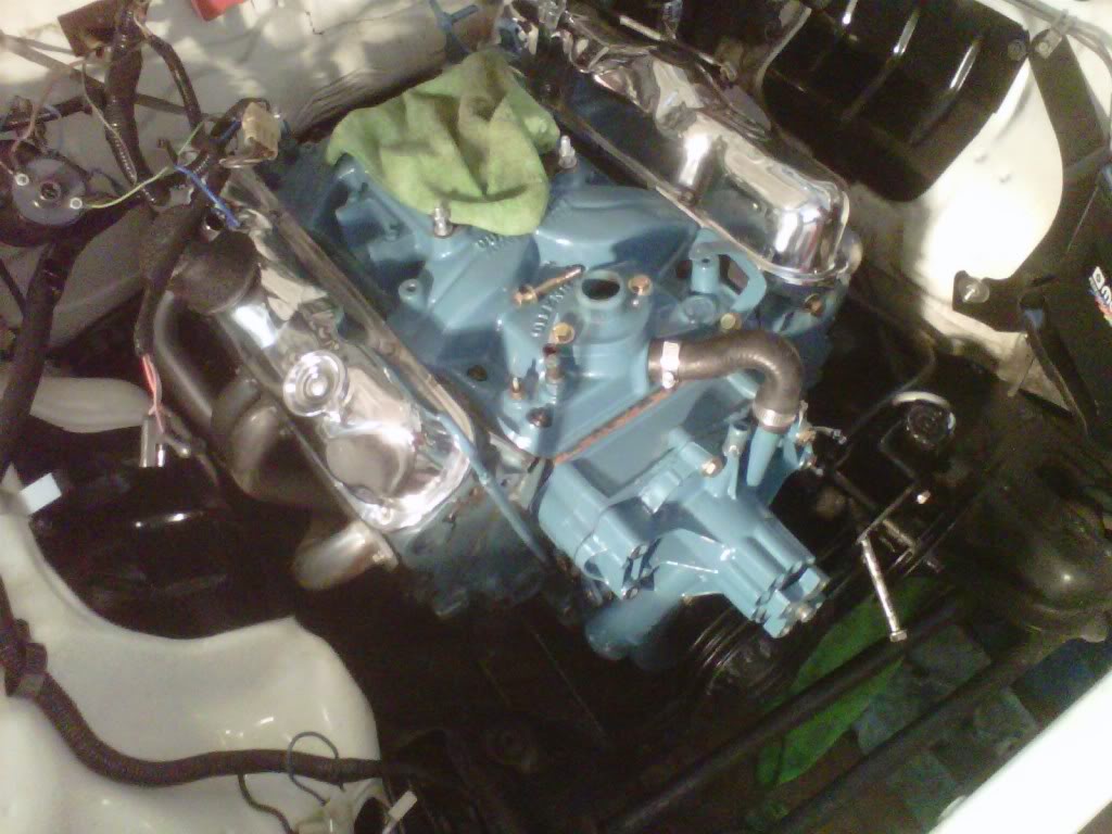

Got to use those special clamp pliers tonight
I wanted to get more parts out of my bedroom...so I got one exhaust manifold lightly tightened on to find out what bolts I would need...I am going to paint them with the same high temp...por 15 when I snug them down...
I got to use the new clamp pliers...I found out lubing the hose with some dishwashing soap works wonders when trying to slide the clamp over the hose and into final position..
and last but not least I got the harmonic balancer installed tonight...
POR 15 the manifolds? I didn't think POR 15 could handle that high of a temperature.
The motor looks great!
Sure it does Tim you gotta get the right Por 15...

I got busy tonight...for an hour that is...
My little battery powered Rigid impact makes for fast work on little bolts and screws...I got busy on the passenger side and made it my way over to the driver's side...I will concentrate on that side tomorrow night..already sprayed down the brake line connections with some Blaster penetrent..
Anyone want a charcoal cannister....
Here is the z-bar in question...I took some measurements and a call to Mancini tomorrow...I am 99% sure that the B body repair kit is the one I need...it will go in the Evaporust bucket tomorrow...
Wiring harness is all the way out...when the booster is out of the way I am going to take the rubber grommet out and feed the wires inside the car..
I bagged up several of the firewall things with their fastners...
