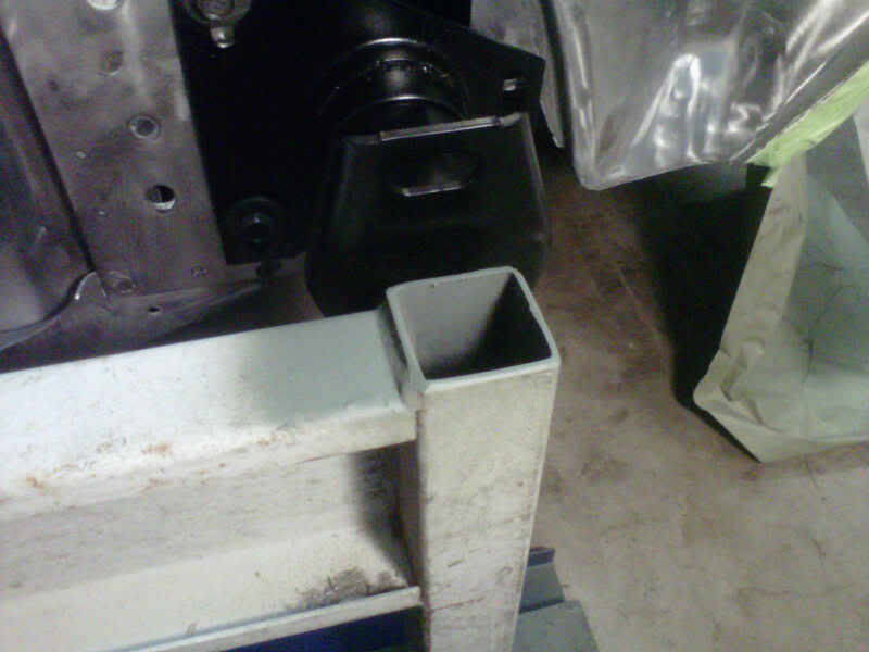

Front end roll around
Got this left over piece of structure at work...cut off and grinded off some extra..now imagine it with rolling casters and bolted to the front of the 5 MPH shocks...this will allow me to roll the car around when the K Member is removed for painting..I have to buy some casters and mount them tomorrow before I take it home..

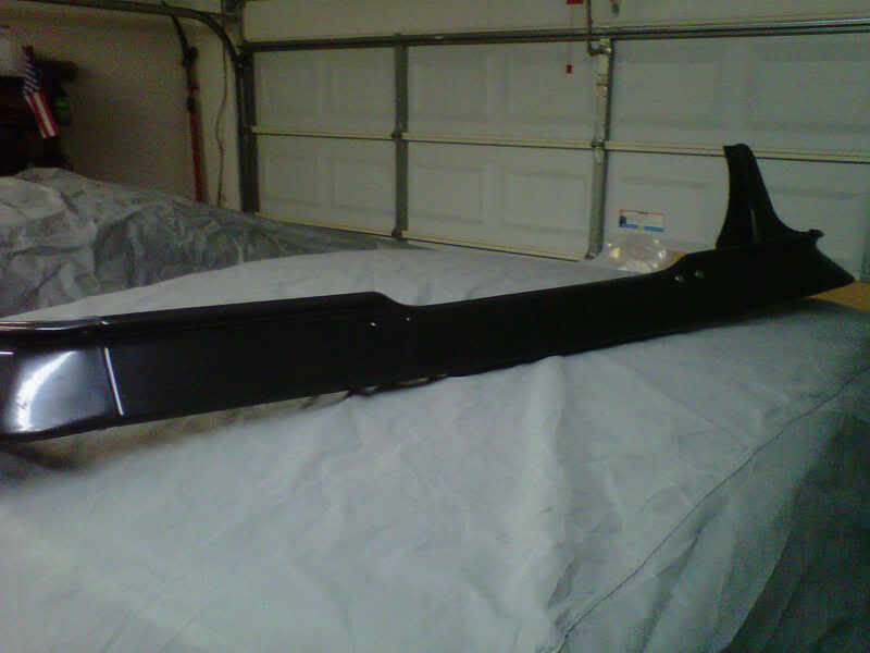

I got my new front spoiler today....$214.00 dollars to the door....going to wet sand it and prime it then paint it.....this one will go on my car and the other in the attic as a spare...as expalined to others..if something happens to this car I like to have spare parts...never know when a board on the road would hit the spoiler and destroy it......sorry but that's the way I think...

Not a whole lot done last night
I brought home my roll-about contraption...I did not want to buy casters until I knew it was going to work...I lightly bolted up the front bumper shocks and then saw I would have to through bolt it to them going through the square tubing...that will only make it a stronger attachment...yesterday I added the blue piece of metal at the bottom to serve as a footing to attach the casters....

Those bumper mounts are not that tough. I would find someplace else to mount that. Also put something inside the square tubing or else when you tighten it, it will crush. Or, when it gets a lateral load it will crush and fold under. Why do you have to move it while the Kframe is out? Just use jack stands. And why is the Kframe coming out anyway? Detailing? Nah.
Old Jan 26, 2011 | 07:39 PM
  #282
Do you remember the slots in the bumper?..My jack in the trunk fits in the slot to jack up the car...the bumper and bumper back up plate both bolt to those...I have round sleeves to put around the bolts...it's coming out for blasting and rebuild..I want to be able to move the car around when painting and such...remember this is a two car garage not a shop.

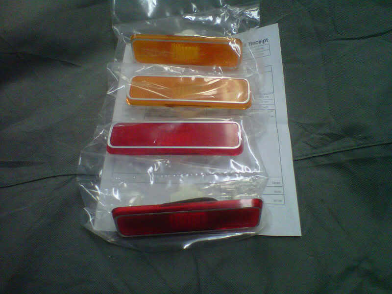

Opened some presents when I got home....first a set of parking light lenses..40 bucks off of e-bay and made in Taiwon...I will not put these on unless paint is done or one gets damaged..

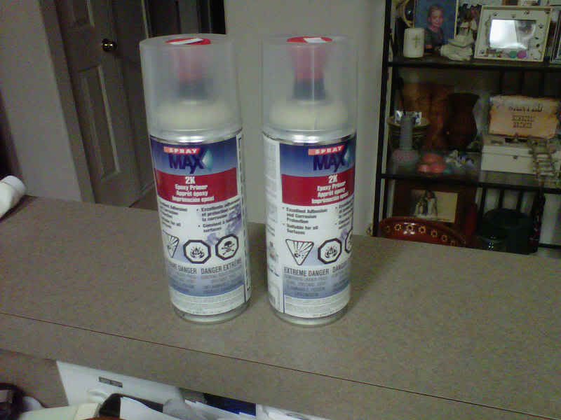

Got my epoxy primer today....2 cans 40.00 plus bucks to get them to the door...67 tomorrow and 68 on Saturday with rain chance starting at 6:00 PM...I will be done before then and I am bringing home a halon lite set from work to put some heat on it..
You take that red plug out of the cap...shake the can for 2 minutes...flip it upside down...stick the plug in the bottom of the can and shake for another two minutes...the spray pattern is adjustable also...leave it up to the Germans...

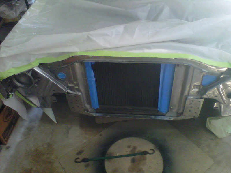

Taped, sanded and boxed up..
I sanded some spots....taped up a little more areas and then cardboarded up some areas..when completed I wiped it down with some lacquer thinner...tomorrow is primer day...Sunday is back to the paint booth for some more painting..it will be rainy and cold..

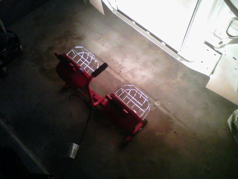

Back in white....sort of
Backed out the 440 Dart....layed down two passes of primer and that stuff is great...it does spray like a detail gravity feed gun and dries fast...Eastwood said it was grey...Auto Body Toolmart is where I got it from and they were right...biege....or off white...anyways I have four more things to prime today before the rain..
lights baking it....

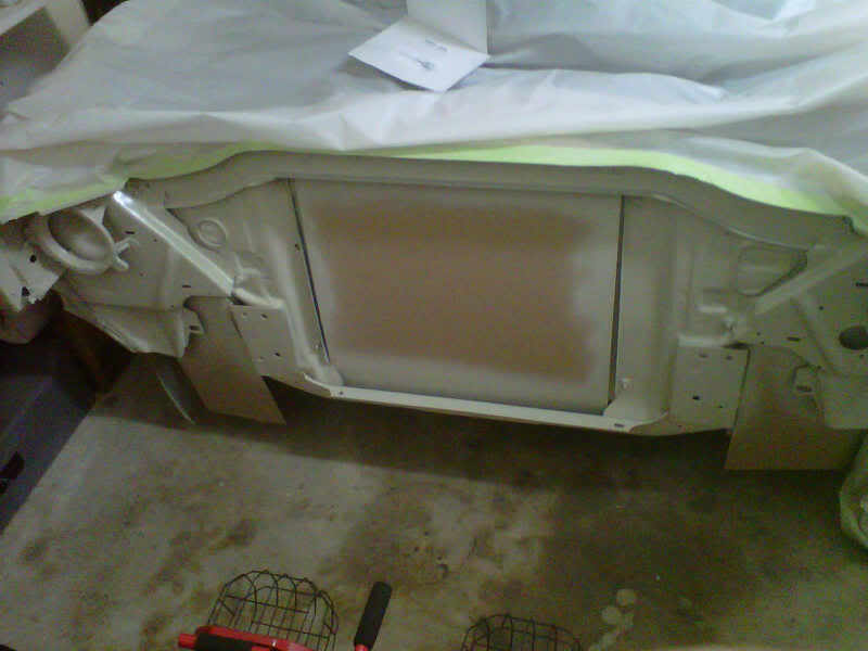

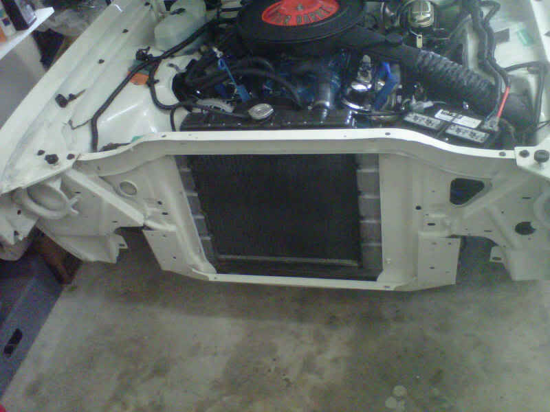

Only had enough of the epoxy primer left in the first can to spray the engine compartment braces...I then took the tape off the front end...looks nice again...I took a pic of the driver's side R/T symbol and they put it on slanted at an angle..I opened the truck and found peeled off paint where the other decal use to run accross the trunk lid...

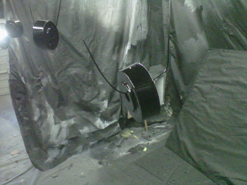

Rainy this morning and warm...this afternoon is partly cloudy and breezy...I used the bed liner srpay booth at work to spray some more parts...inside the bay I shot two coats of 500 degree blue followed by two coats of 500 degree clear...they are still drying when I took the picture..

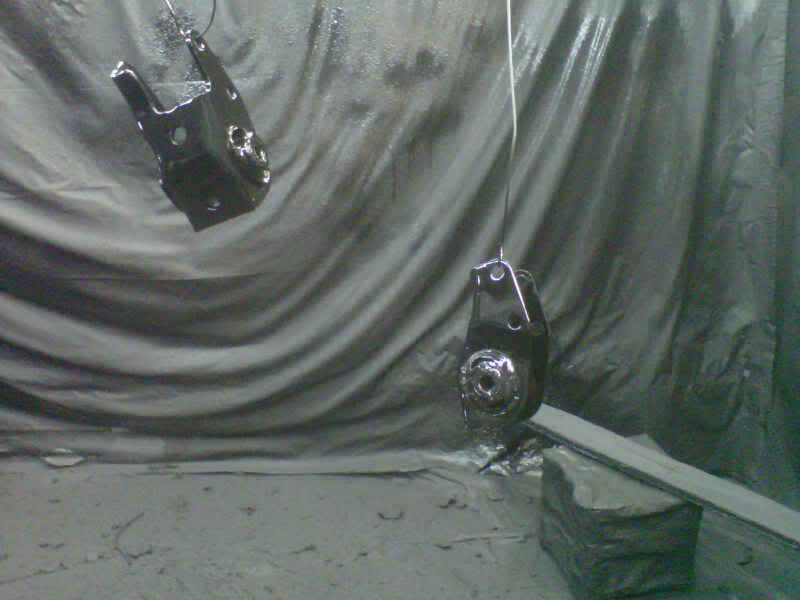

motor mounts chassis black...
Idler and Pitman arms chassis black...

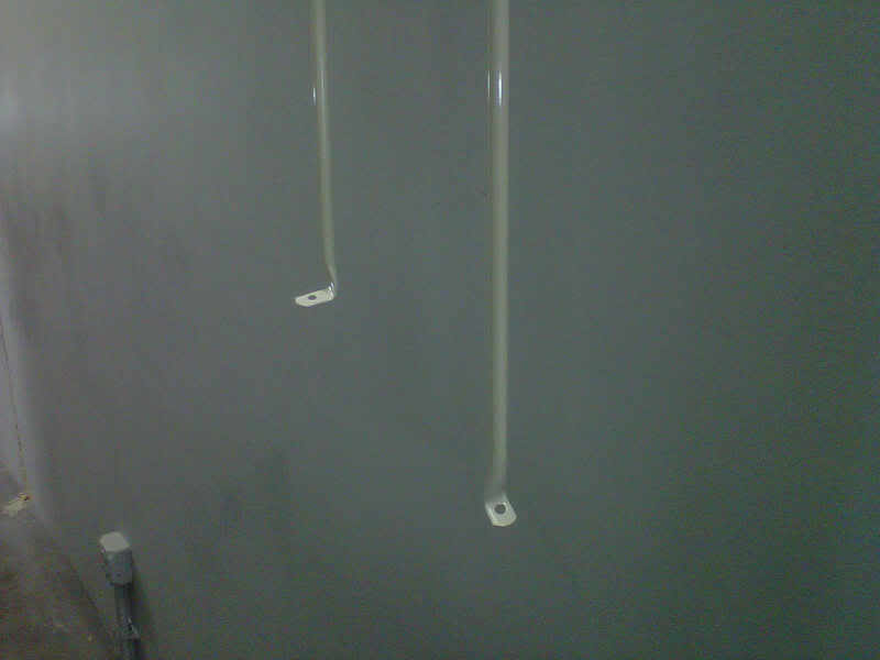

Engine compartment brace bars...Spinaker white...

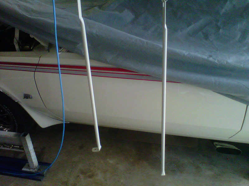

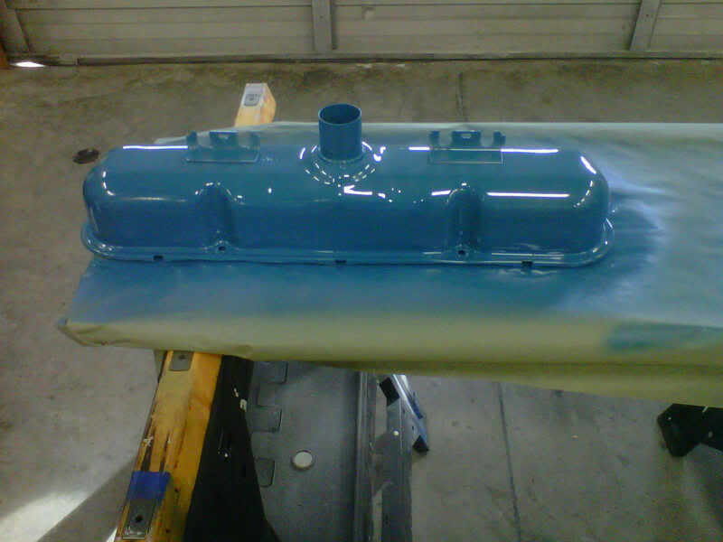

Here's kinda what the valve covers will look like with the white wire separators on them...I am going to wrinkle coat the breather to match the air cleaner...I call it a little old school mixed in with a little new school..

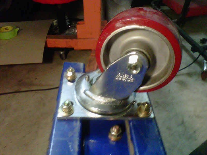

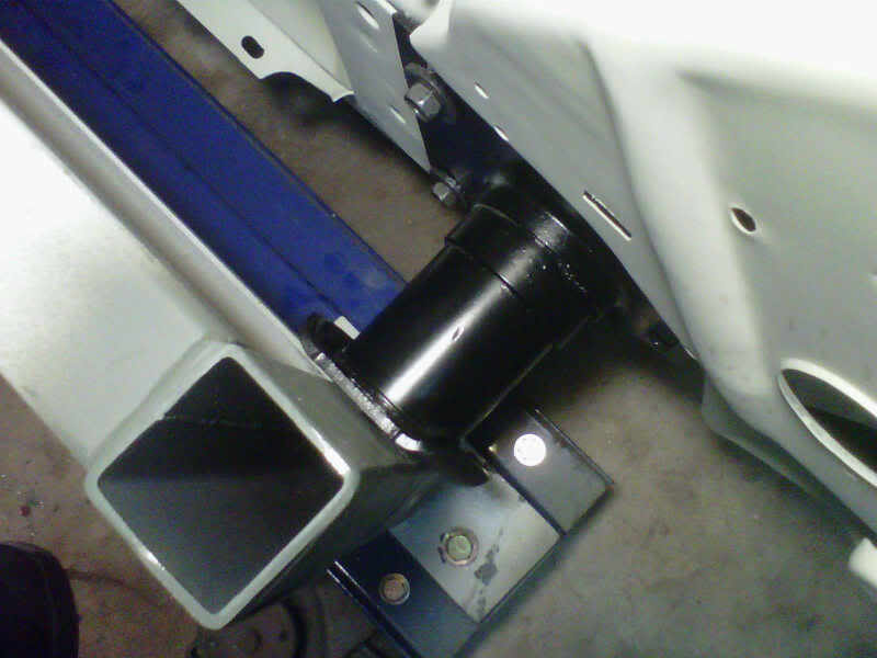

Got my heavy duty casters in the mail today and they are heavy duty....ball bearing swivels and wheels with grease fittings...a breeze to attach....two holes on each one already matched up to holes on the base plate....bolted them down and then drilled four holes and was done....
bolted the bumper shocks back on and lined up my roller unit to them..I marked the holes to drill through but will do that tomorrow..I have to cut about 1/4" off each of the hollow tube spacers I got to fit into the square tubing to keep it from crushing when I tighten the bolts..

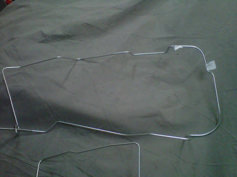

Drilled the holes and got it lightly mounted on there tonight...used a piece of coat hanger to lower the round spacers down to the holes..then stabbed the bolts through..not much more until this weekend...

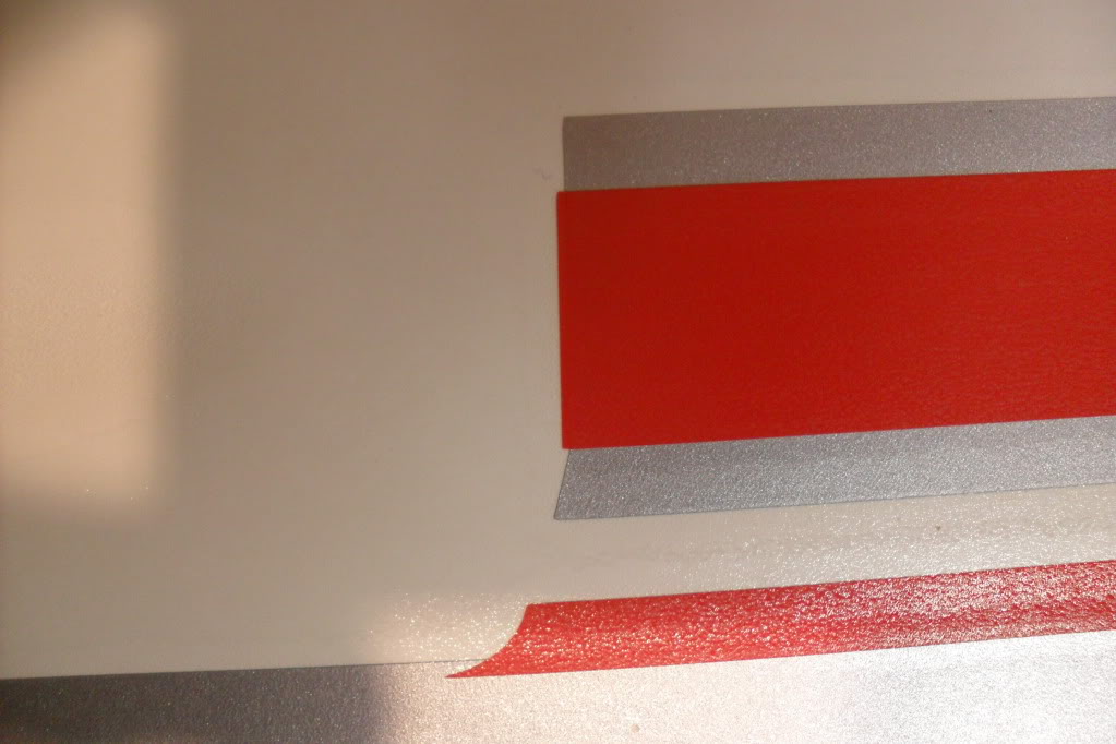

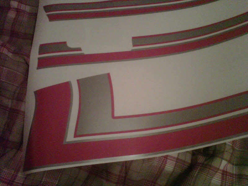

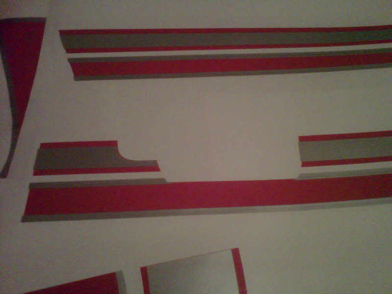

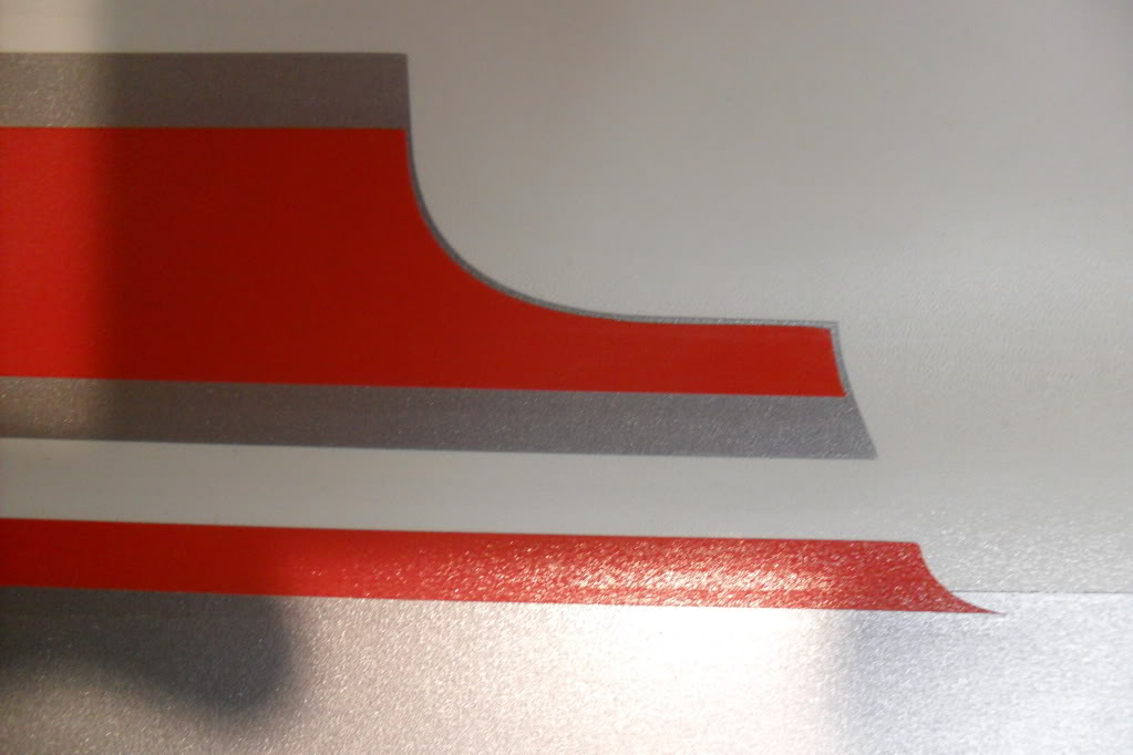

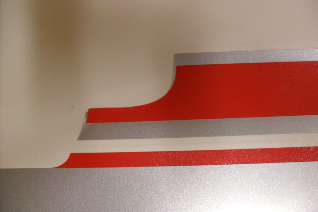

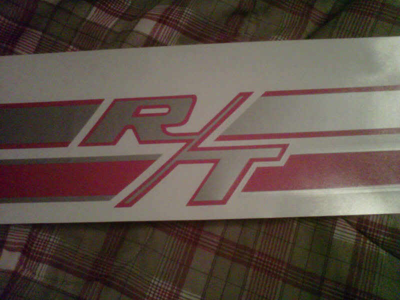

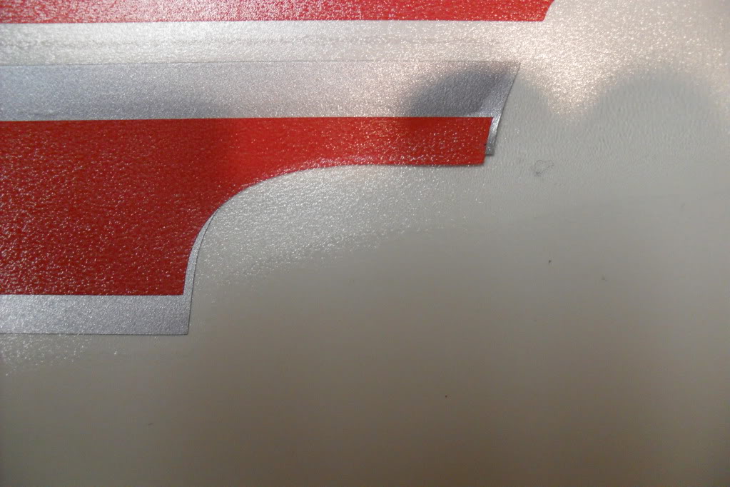

I got the other set of decals last night and am posting some pictures
This decal is messed up...it is one of the rear quarter panel ones...

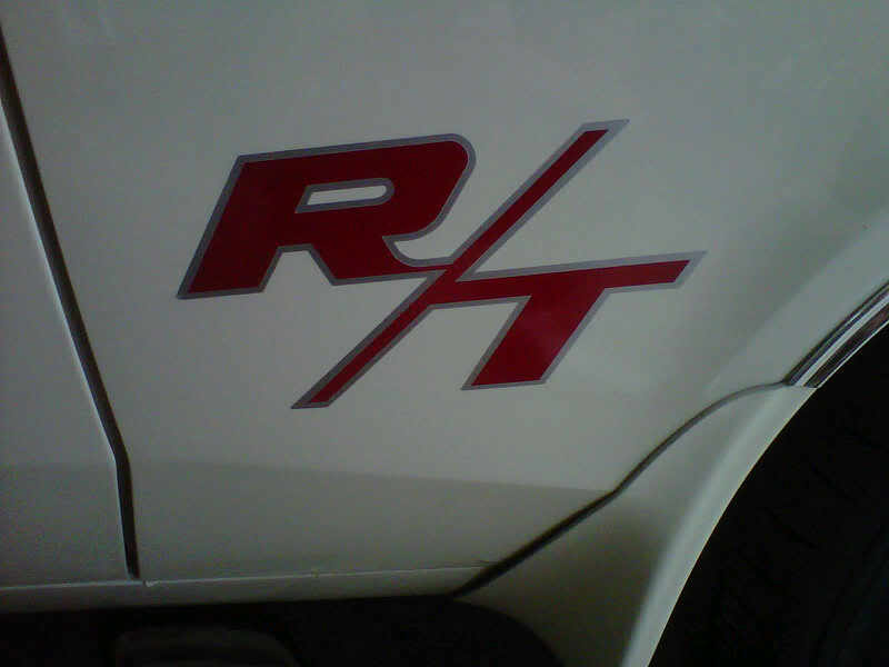

This is what the door ones look like on my car.....

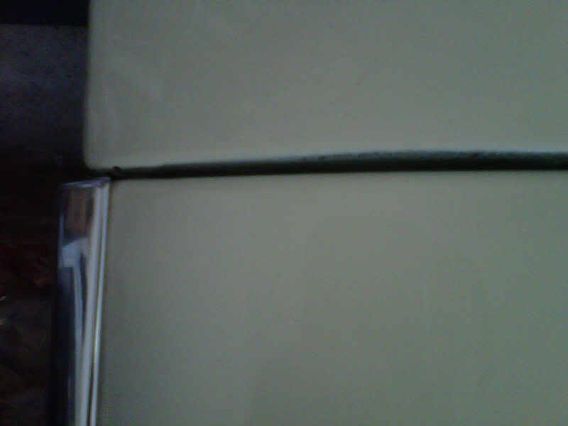

Here's several shots of their's around the door handles...kinda real disappointed...have to send them pictures again and request some new ones..I don't think you would put them on your car..
