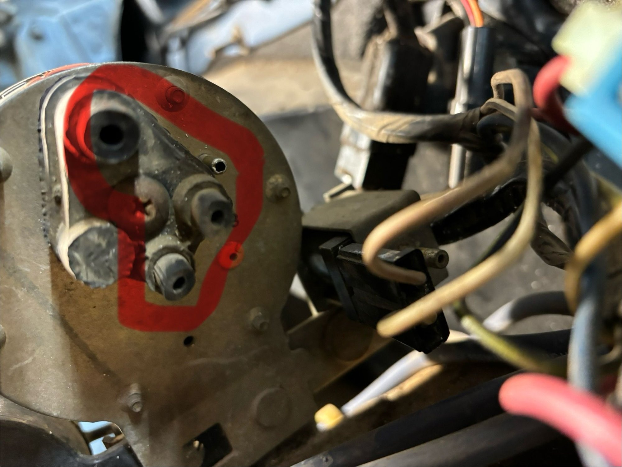

Please excuse my ignorance, if I were to disconnect “all” of the vacuum lines, which ones do I leave connected? (What are the essential lines) Do I plug all of the ones I leave, or do I just let them be without any type of plug? Thanks
Old Jan 2, 2024 | 07:37 AM
Take a Photo and post it up...
But if like you say none of them are hooked up.... Then just cap all the ports... only 3 hoses? correct?

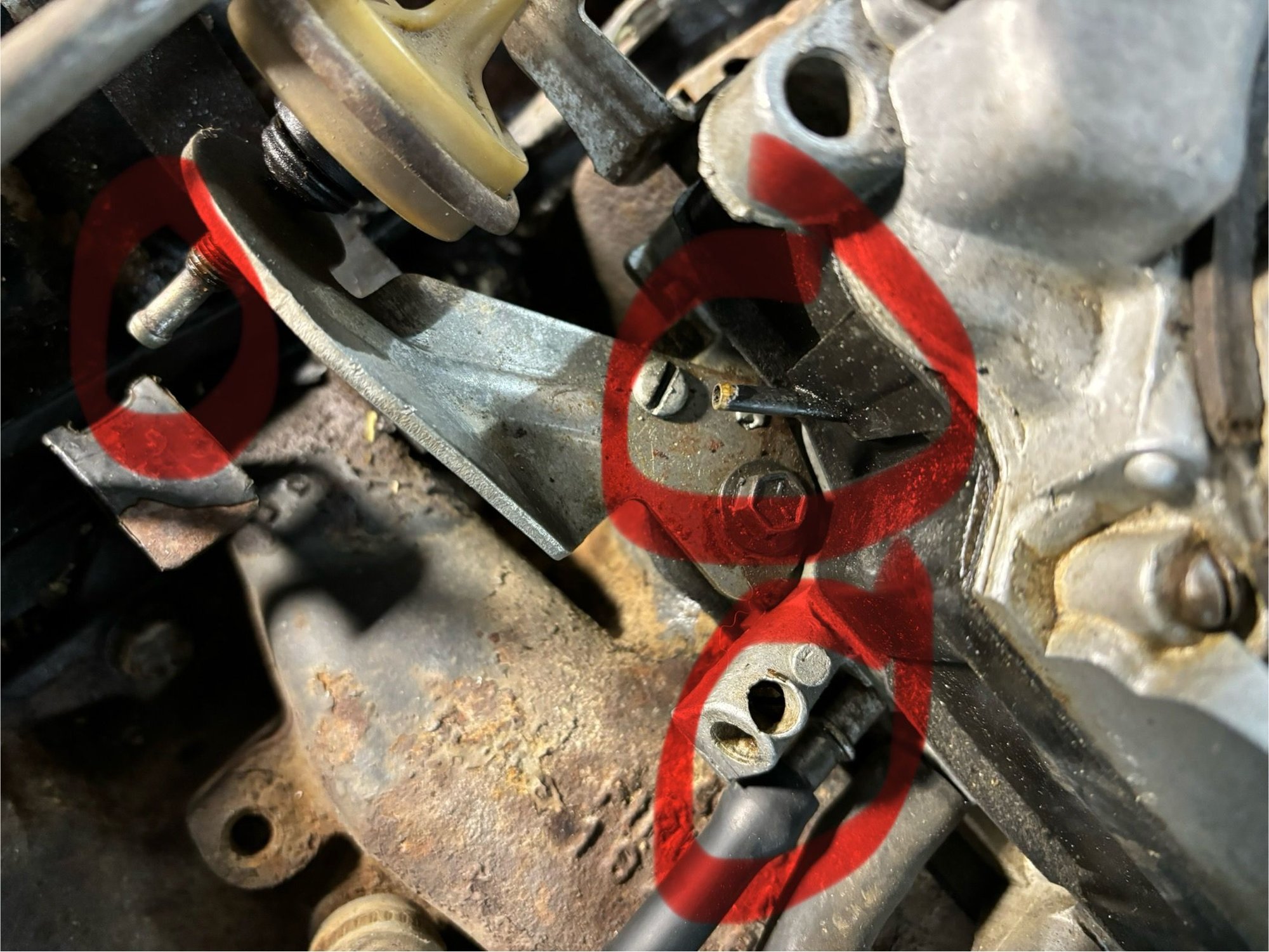

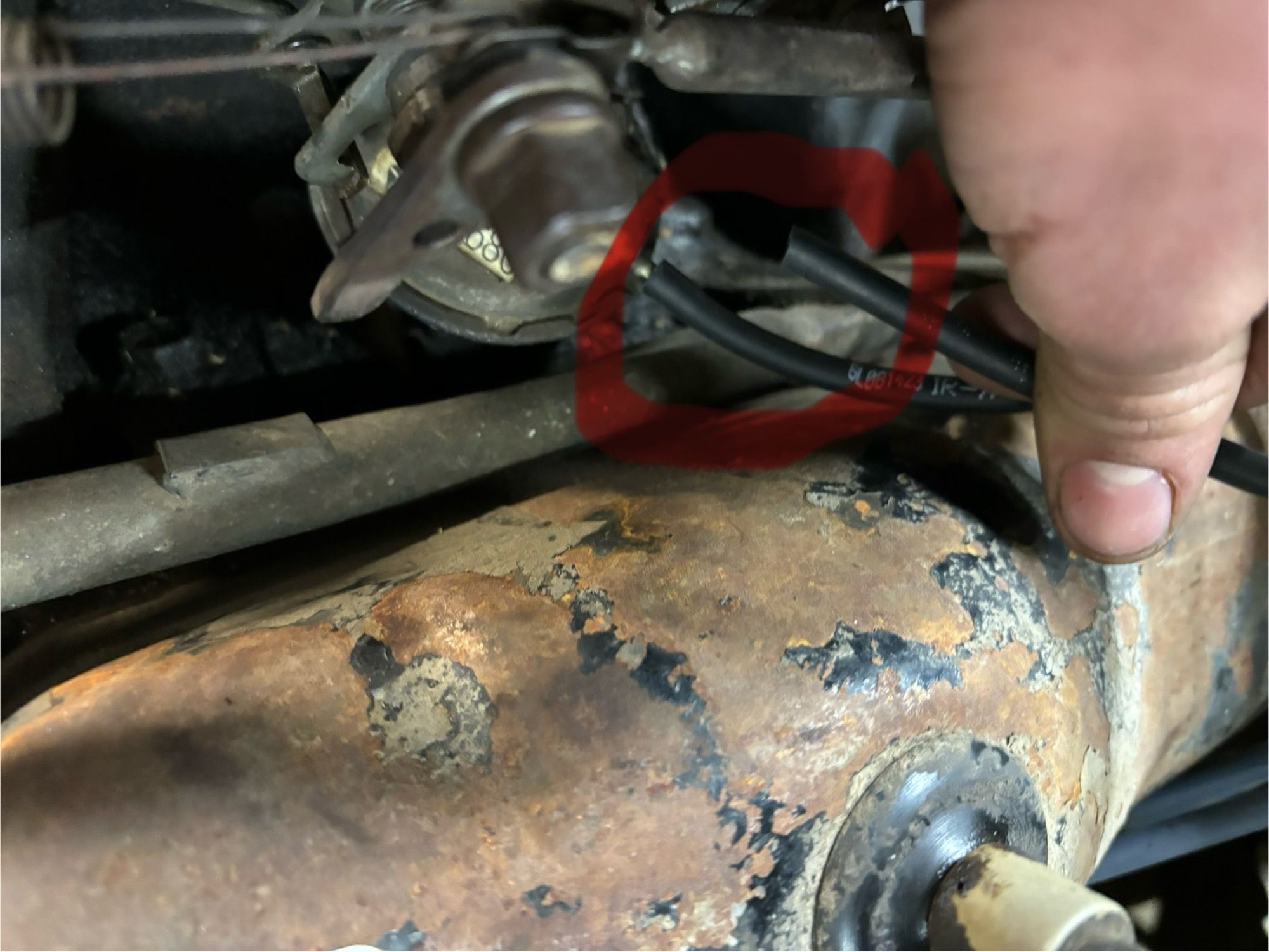

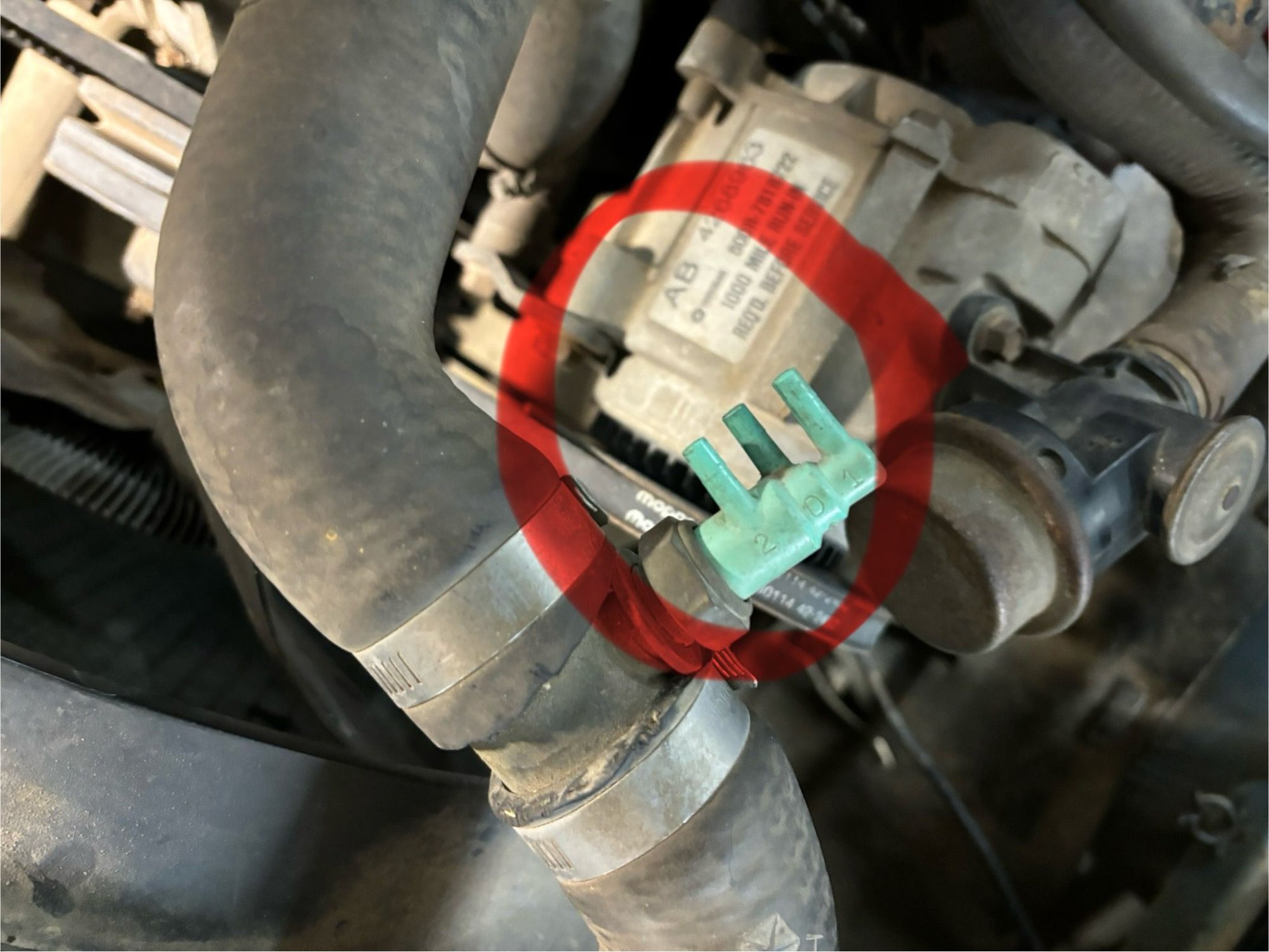

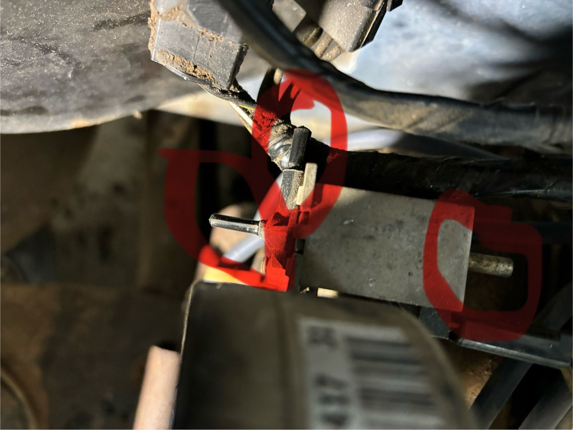

Old Jan 2, 2024 | 03:32 PM
Oliver Hutchens's Avatar
Joined: Dec 2023
Old Jan 2, 2024 | 04:29 PM
Only one i see that needs attention, is the one small port coming out of the carb... I would cap that small one... Its in the next to the last photo, The one coming out of the black float bowl body at an angle... The rest are all good to go...

So cap that one and let all the rest stay uncovered? (Minus the ones that are already plugged)
and where should I be running my vacuum advance line to; the manifold vacuum source or the carb?
Old Jan 3, 2024 | 08:54 AM
1. Yes
2. Find a Ported Vacuum Source in / at the base of the carb. to plug your vacuum advance hose into.....
"Note" I would have assumed that you have already found that, with the hose you have hooked up next to the Idle air mixture screw pictured"?????
If that is not so, you will need a vacuum gauge to test the ports to find a ported vacuum source for the vacuum advance hose for the distributor.
Note: no vacuum when at idle..... And Vacuum when off idle....
At the moment, i don't remember exactly what port controls that.
