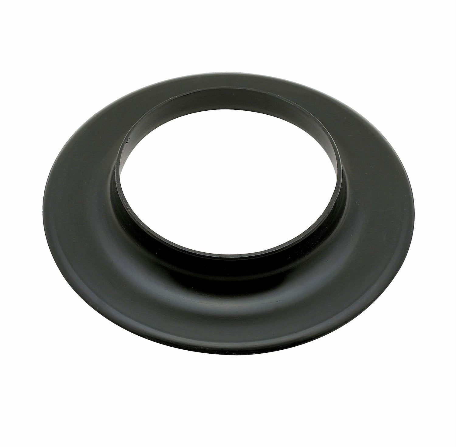

Welcome to the site.....
Get on of these from Mr. Gasket at your local Speed Shop.. Or From Jegs.

C -
Yes, you will need an adapter like Bob said, but that might not solve the hood clearance issue (might make it worse).
In addition to the adapter, you will need a 14" Moroso type air cleaner that drops lower around the carb and you may have to find a 2" tall element.

Thank you for your feedback and welcoming. Iv tried the adaptor. It created a clearance issue with the hood and the wing nut stud is too short when you add the adaptor. Iv given up on this air cleaner modification and most likely going to put on a 4bbl, etc.
