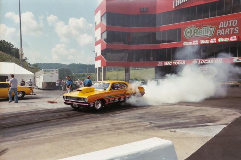

Ok from the racing point of view... I've had both engines but in different cars.. First was the R3 in a 70 Duster... Stroked it to 396" had steel w-2 heads, alum rods, BM pistons, roller comp cam, Offy intake(Modified) and 4500 holly.... Car weighed in at 2800lbs. Had a lot of fiberglass on it... Fenders, doors, hood, deck lid bumpers.... 904 tranny with a dana rear.... This car ran a best time of 9.86 at 133 miles per hour.
The second car was a tube chassis Barracuda... Stroked a 400 to 451". Eagle steel rods and crank. JE pistons, Indy 440-1 heads and intake, Quick Fuel 4500 carb. Ran thru a 727 to a dana rear. This car weighed in at 2500 lbs... Best time here was 9.78 at 140mph....
Considering the weight difference I would say the engines were about equal.... Know this doesn't point you in either direction but it does say that given the right build you can't go wrong either way...
JMO........
Attached Thumbnails RB block or R3-smokey-2.jpg   RB block or R3-racing-sgmp2.jpg
