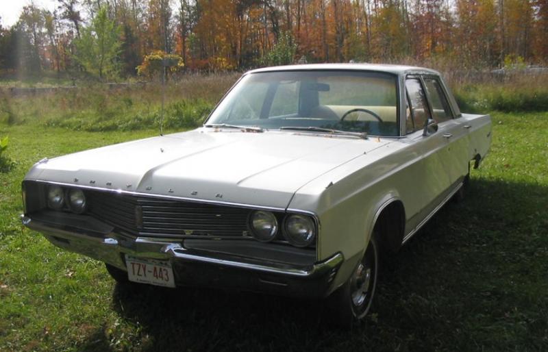

Thanx for the info. I am pretty sure the bolt pattern on the flex plates are the same on the converter side. I have flex plates for all engine sizes. I was wondering about "application" more than fit, with the /6 converter being up to the big block. I think it is a smaller diamiter unit wich seems to be the way the heavy duty units are. Was just wondering if I can use what I have or if I need a specific big block converter. Don't need high stall but the car is kinda heavy (68 Chrysler New Port 4 door) and thought heavy duty would be best.
bboogie
