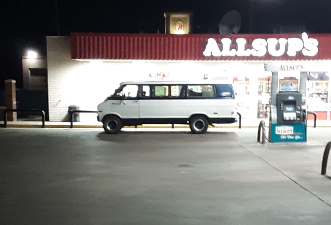

Been road tripping with it. Not much get up and go
off the line -still needs some adjustments -but flies like the wind on the highway -lots of acceleration for passing. Was smooth as butta until I threw a couple stick- on wheel weights -now just a bit noticeable -I can tell where they went, so will have to get some -and spares. I originally wanted no windows, but I love having so many now. Pups love it, too -as well as the fact that I turned the passenger seat around and laid it back.
