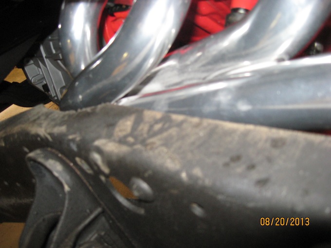

S&P (www.hodrodlane) will build you custom set of headers. I used them for the Hemi build and found them to be pretty reasonable all things considered.
