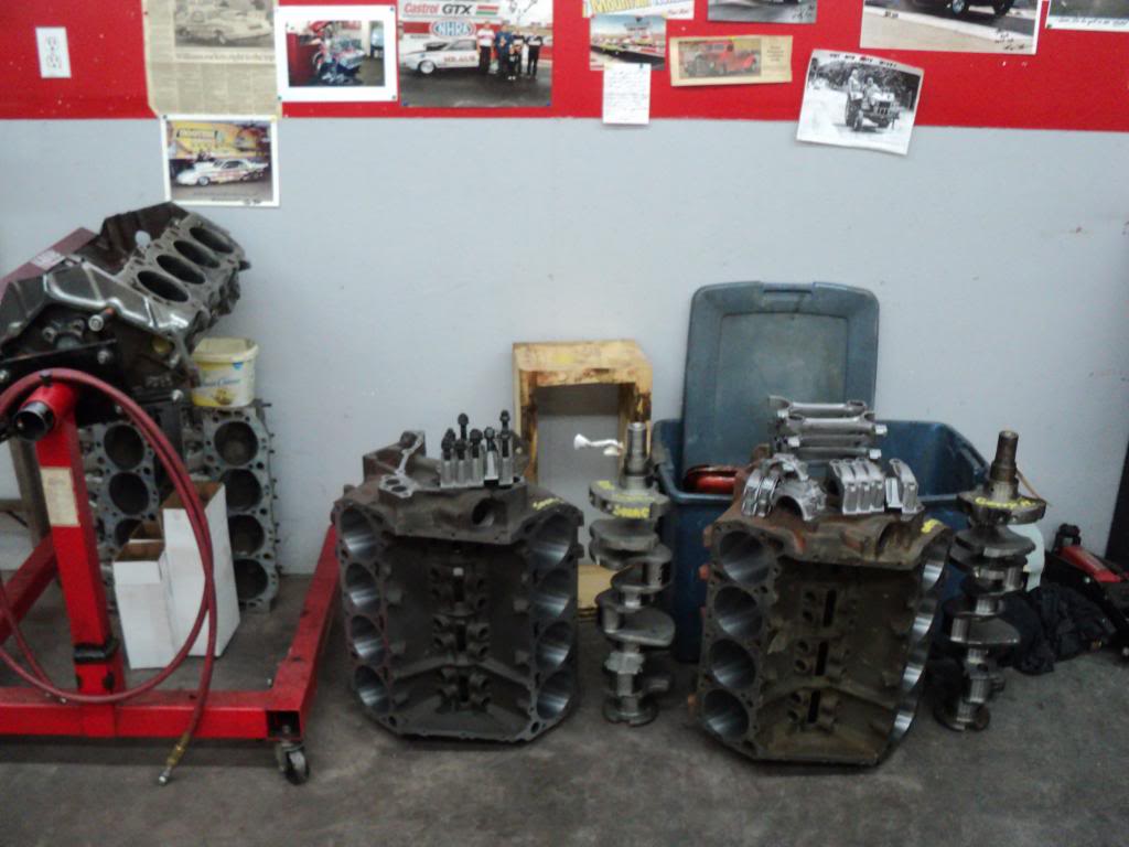

A couple of real easy, Non Stroker, Keep It Simple Stupid, Pump Gas, 500hp "street" 440 Engines for a change !
Just "out of the blue" I get not 1, But TWO requests for std Inch 440's ! GO FIGURE ?
Easy peazy.... and far more time friendly on the old, supposed to be "retired" Guy thing !
One of them is even using stock "LY" Connecting Rods, requiring just a Beam & Harden with ARP Bolts......I can't remember the last time I beamed a set of stock Rods ?? Gotta be well over 15 years ?
YIPEE ! "Nostalgia" Engine Building !
Anybody wants to follow along, I'll post Pics as we go ?

Cool Beans BOB..... I got my Eyes on this one....

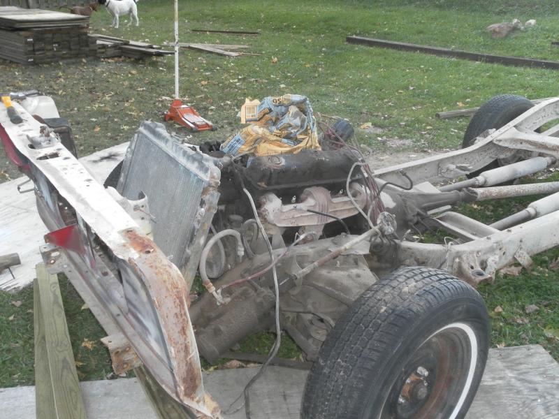

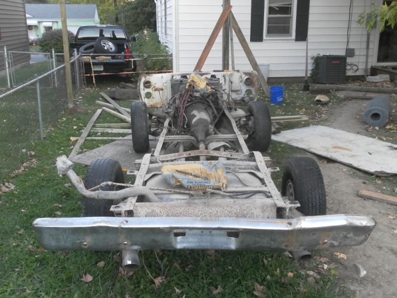

I had this a couple days before it fell to pieces
Attached Thumbnails What project are you working on?-sam_0357.jpg   What project are you working on?-sam_0358.jpg   What project are you working on?-sam_0359.jpg   What project are you working on?-sam_0360.jpg   What project are you working on?-sam_0361.jpg

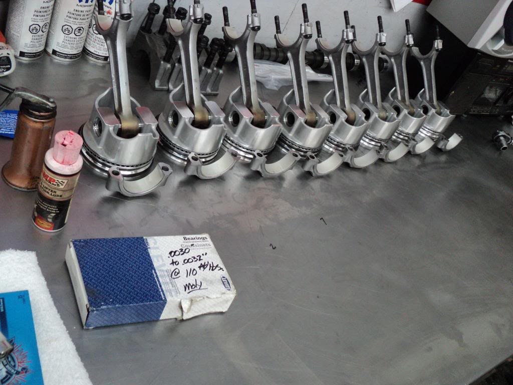

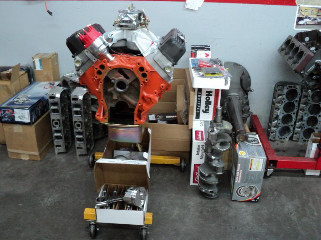

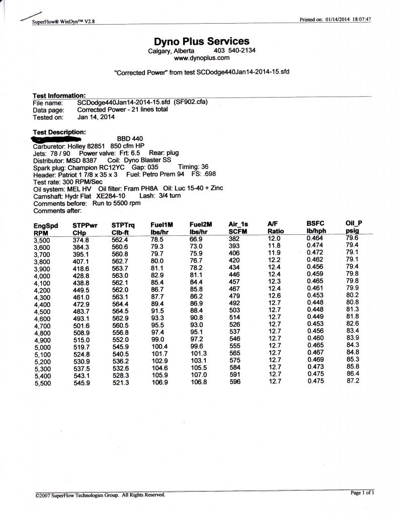

One 440 is a stock LY Rod, Forged Piston deal @ 500hp....the other 440 is using Eagle H-Beams, Forged Piston around 530hp...both are mushy Hydraulic Flat Tappet Cam Street Engines....
Very easy doing 2 basically the same....at the same time...saves machine setups ! and so nice to work with easy stock stroke stuff !
The "stock" ly Rod deal is first up to assemble
* Bored & Honed with a Torque Plate in my old Sunnen CK10(if my T/Plate looks a little BIG on the 440 Bore it is because it is for 4.500" Bore Mega-Mopars, but it still works on the small bore 440)
Old Nov 17, 2013 | 05:51 PM
  #200
Moparbob's Avatar
Joined: Mar 2013
Posts: 83
Likes: 11
From: Canada

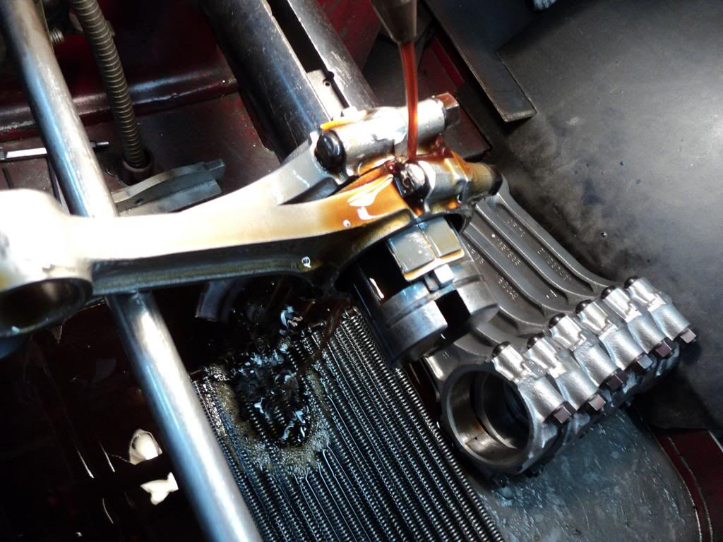

Resize the Rods and "set" Vertical Bearing Clrc.....0027" @ 50 Ft/lbs with the ARP Bolts
Old Nov 17, 2013 | 06:05 PM
  #201
Moparbob's Avatar
Joined: Mar 2013
Posts: 83
Likes: 11
From: Canada
Forged Pistons On the Rods...note these are stock LY rods, so we "pin-fit" both the Pistons...and the interference in the Rod...so we only have to heat them "straw" colored for the pin to slide in nice, then come back round when cool.
Rod "Heaters" are for butchers ! So are "purple" Rods half way down !
We also Align Honed the Mains for the ARP Studs(no photo), but those are the Main Bearings & Clrc in this Pic.
Old Nov 17, 2013 | 06:11 PM
  #202
Moparbob's Avatar
Joined: Mar 2013
Posts: 83
Likes: 11
From: Canada
Feed the Block a Crank & Slugs.
Cam in at 106*
Rings .018" & .019"
Crank endplay @ .007"
Rod Clrc. .0027" on the P bearing, 50 ft/lbs ARP Bolts.
Mains .0032" W/ARP Studs
Piston to Deck @ .005"....should be good quench.
Old Nov 17, 2013 | 06:23 PM
  #203
Moparbob's Avatar
Joined: Mar 2013
Posts: 83
Likes: 11
From: Canada

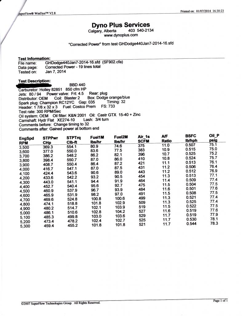

Here's the 2nd 440 Mopar for next week waiting it's turn for short assembly... it looks a little "forlorn" sandwiched between 2 BB Chevy projects(1 is a KB Aluminum Chevy Block W/EPD Heads)
This 440 is using H-Beam Rods... a little more power....but BOTH Engines are using the Él Cheapo 440 "Stealth" Heads.....which we still have to Port & Flow.
If ya want...I will post the Porting Pics & Data....because we Dyno every Engine before it leaves, and these will be as well....so a nice proven power package for future reference ??

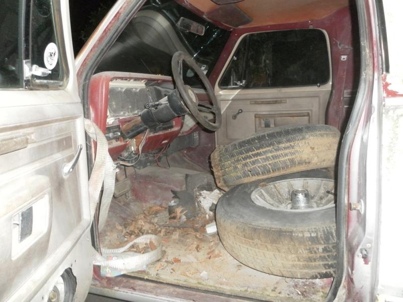

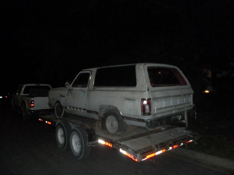

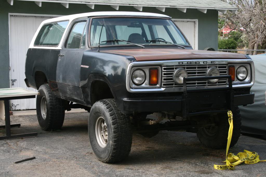

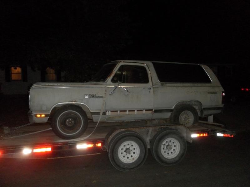

these are my projects. my 81 d150 and 93 ramcharger. my 81 has been a great low maintenance truck. i think i might need some new connecting rod bearing and maybe some new main bearing and the engine would be happy once more. i also got a used cam and heads for it that will hopefully be going on this summer.
now my ramcharger is a fun little vehicle but it has been a huge drain on my wallet. currently needs a new fuel pump. i am actually hoping i can save up a bit more money and just get a ramcharger that is in better shape to put the 93's engine and transmission into.

Final Dyno results
OK, apologies here.... been busier than a one-legged man at an *** kicking contest !
anyways, here are the results.
Engine #1 486 H.P. / 554 Ft/lbs Torque
Engine #2 546 H.P. / 563 Ft/Lbs Torque
Quick recap;
* 2- .060" over 440 builds, both stock forged steel cranks 3.75" stroke
* same ICON forged pistons
* same Edelbrock performer rpm Intake Manifolds
* same 850 cfm Holley Carbs.
* Both using 440 source Stealth Heads
- #1 Engine OOTB Stealths
- #2 Engine Ported Stealths
* Both using Flat Tappet Hydraulic Cams.
- #1 Engine with the XE274
- #2 Engine with the XE284
440 Engine #1 using OOTB Stealths, XE274, Edelbrock RPM Intake & 850 Carb, this version of the 2 Engines is a "one up" from a stock type resto rebuild, good idle, lotsa vacuum for brakes, all done right around 5,000 rpm just like a stock 440 magnum, great for 3.23 gears and 2200-2400 stall convertor.
This is a "leave it in D" and just drive it Engine
486 hp @ 5,000 rpm with 554 Ft/Lbs Torque at 3,500 rpm.
Torque is higher even lower.
440 Engine #2 here
is a more modified version of the same parts package, using PORTED Stealths and Port matched Edelbrock Performer rpm Intake, and a slightly bigger Camshaft being the CompCams XE284 Hydraulic Flat Tappet. It has a more noticeable "lump" to the idle, but still decent, and still enough vacuum for power brakes. 3.55 to 3.91 gears best, 3,000-3,5000 stall best, 2,800-3,000 would work.
More of a manual Shift Auto/4-spd weekend warrior type engine, capable of 11's in a 3,800 Lb B-Body.
546 H.P. @ 5,500 rpm / 563 Ft/Lbs Torque @ 3,500 rpm.
Old Feb 19, 2014 | 10:37 AM
  #210
Posts: 11,104
Nice Job....Made some good Torque down low....
