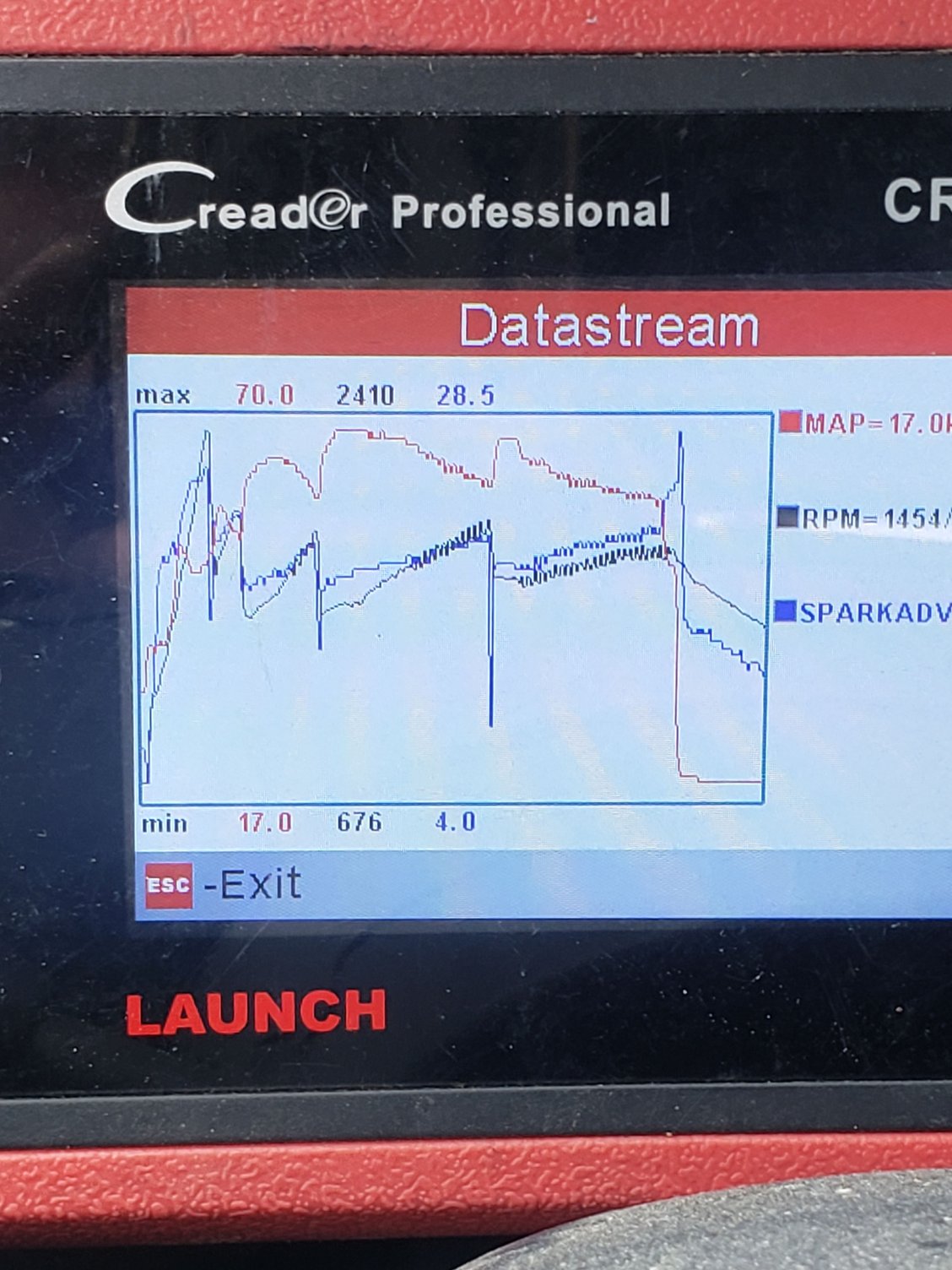

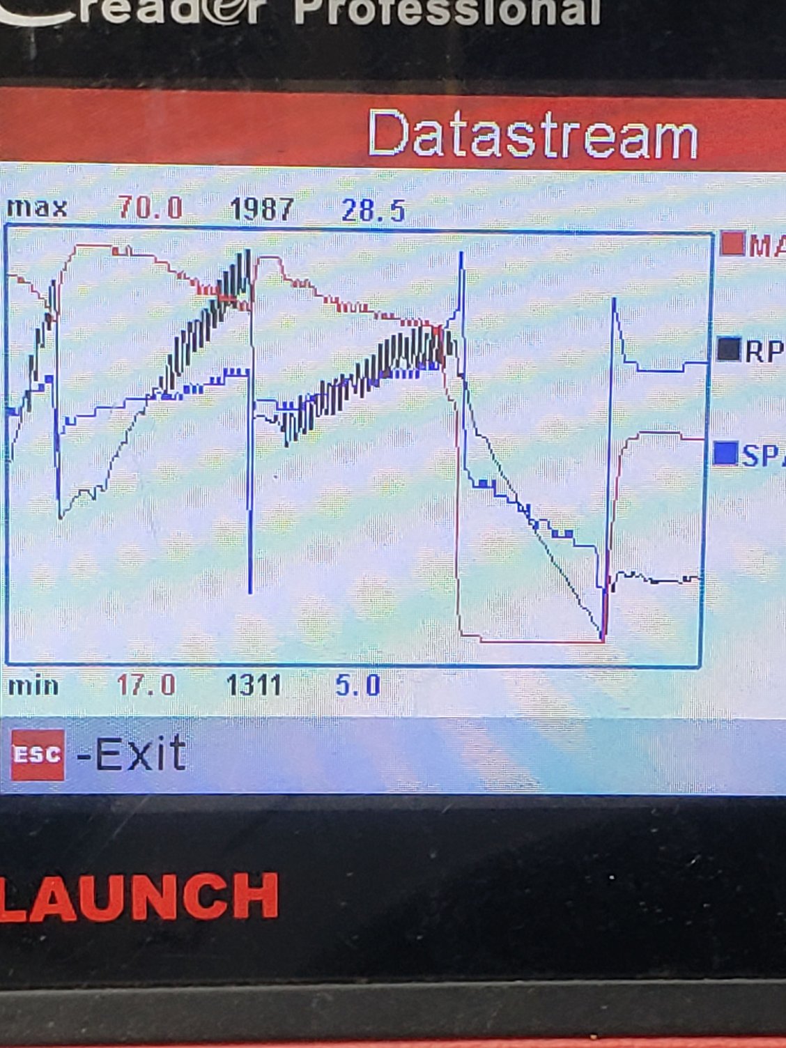

I have had this issue for about 4 years now. The car will accelerate in steps, so from let's say 60kph to 100kph, the car RPM increases as intervals, and as its doing this the rpm will then start to rise and drop, making the rpm needle rise and drop about 100rpm and I can hear it in my exhaust, RRrrrRRrrrRRrrrRRrrr. My rpm needle also twitches up and down about 50-100 rpm at all speeds (not the tach motor itself, tried different cluster)

I have a photo of my rpm jumping. I haven't a damn clue as to whats happening.

As you can see the RPM jumps up and down a lot before changing gear. In all gears.while accelerating.

Hey, thanks for the reply.changed out the conductor plate and they contain the n2/n3 spd sensors, the tranny uses the wheel abs speed sensors for the "output". Seems the wheel sensors are consistent and the speed sensors are consistent until of course the entire car surges, then everything follows the surge, rpm, map, spark timing, etc.
