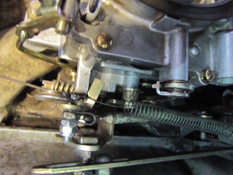

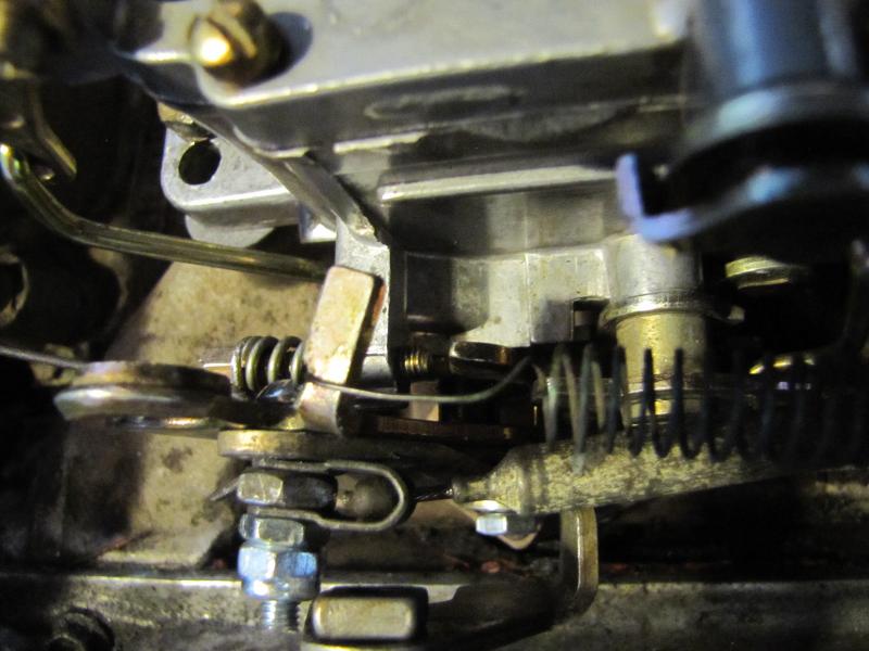

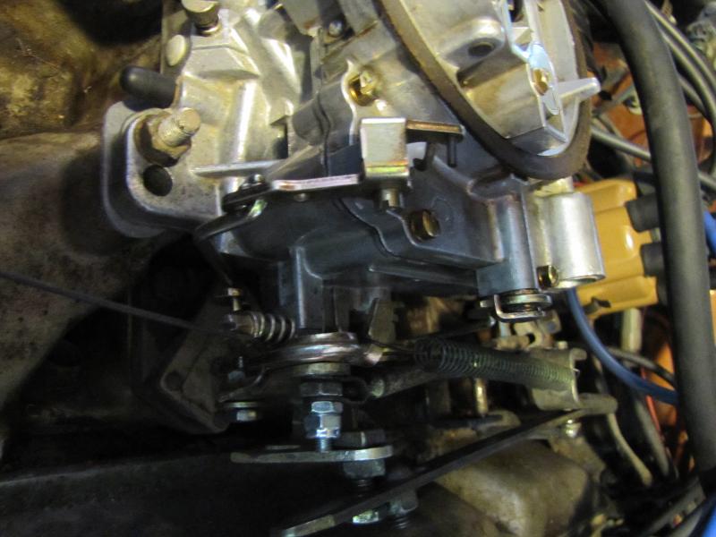

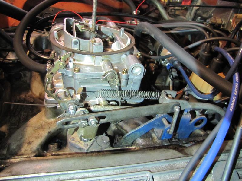

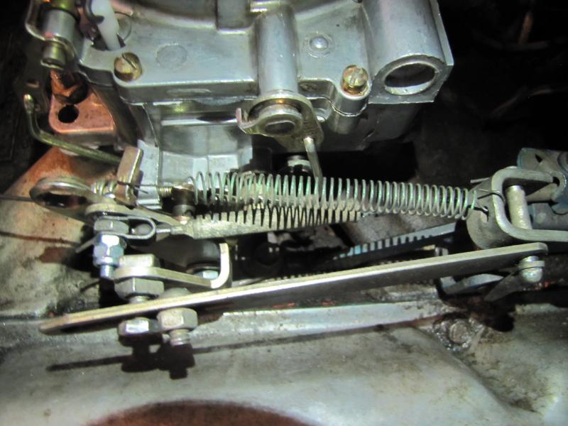

Hmm, i was playing with it today and noticed that nothing is hitting the idle speed screw. I can pull it back and make it hit but there is some rubbing or something going on. Can anyone see something wrong with these pictures?

The linkage pulls at an angle-- Not good Are you still using the linkage from the two bbl. I would bet you are NOT getting full throdle You need the 4bbl linkage like used on a thermoquad as it locates the linkage further out. The green spring should hook up to the kick down The lever with the slot.. You have two springs operating in different directions, probably your idle problem. Before Edelbrock to over Carter made a carb specifically for Mopar

lynn is right the cable is pulling at an angle. cause it has the 2 bbl bracket, and some times the 2 bbl cable is to short. that will stop the plates from opening. all so it looks like you have some nuts in there that is NOT stock. all you have to do to get it to work right is make it STOCK. find some STOCK non modified engines and check them out. get a 2 bbl and 4 bbl with the stud for pulling. set the 2 bbl on top of the 4 bbl centered. then youll see the difference. STOCK, STOCK, STOCK, STOCK

FOR YOUR MOPAR YOU NEED AN ADAPTER FOR THE LINKAGE !!!!!! Edelbrock #8021
http://www.edelbrock.com/automotive_.../general.shtml
also the 4 bbl linkage
This gets you the correct relationship between the throttle opening and the trans kickdown

I figured out the problem, the linkage for the secondaries was locked up. I freed it up and now she runs great. And for the non stock nuts. The ones that were previously on there were rusted on and stripped so I had to cut them off and get new ones. It works great now.
Old Jul 9, 2013 | 11:26 PM
Glad that you got it working. but it is still not 100% right.. Pulling the throttle at an angle will cause premature wear in the carb
