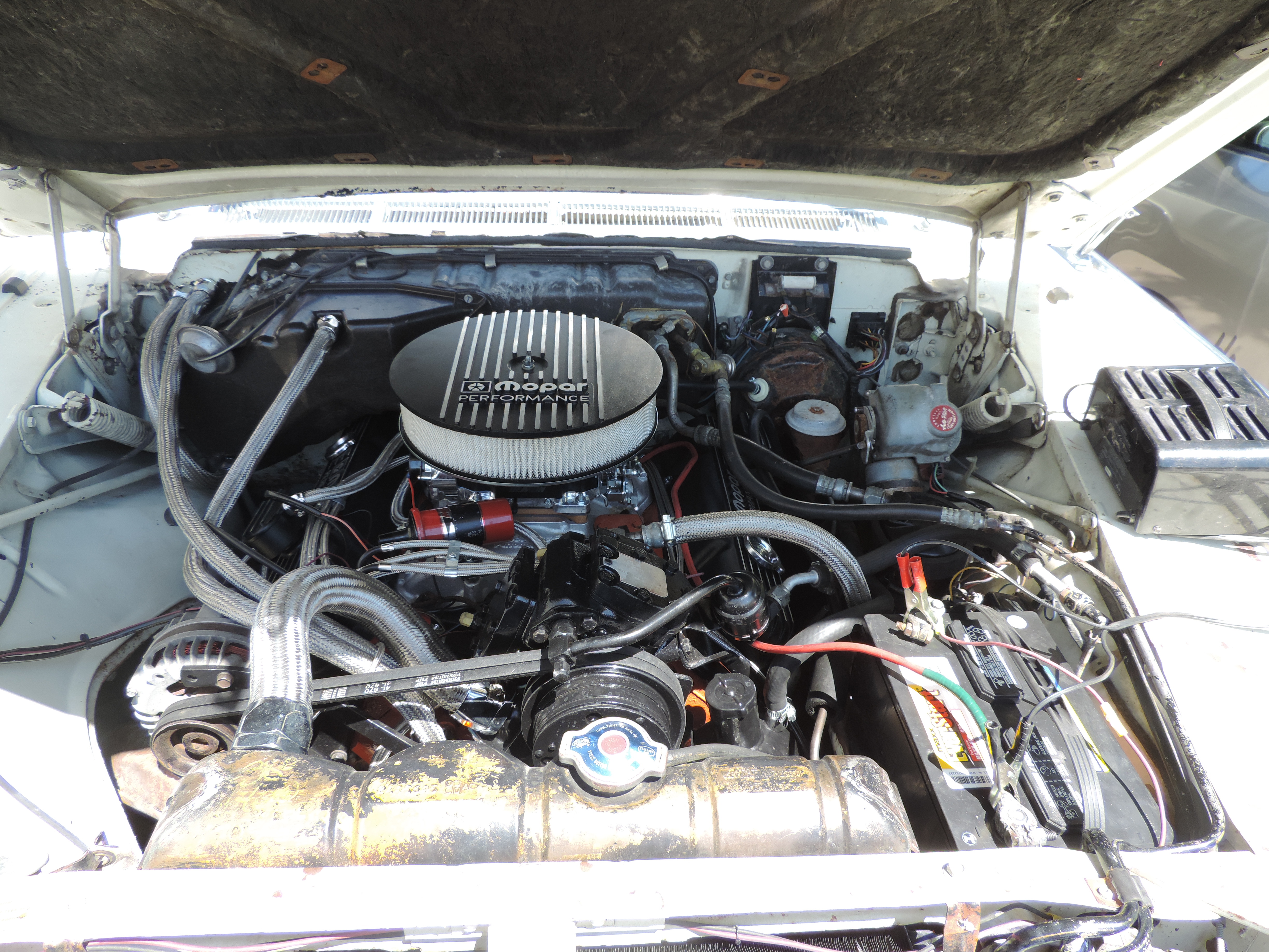

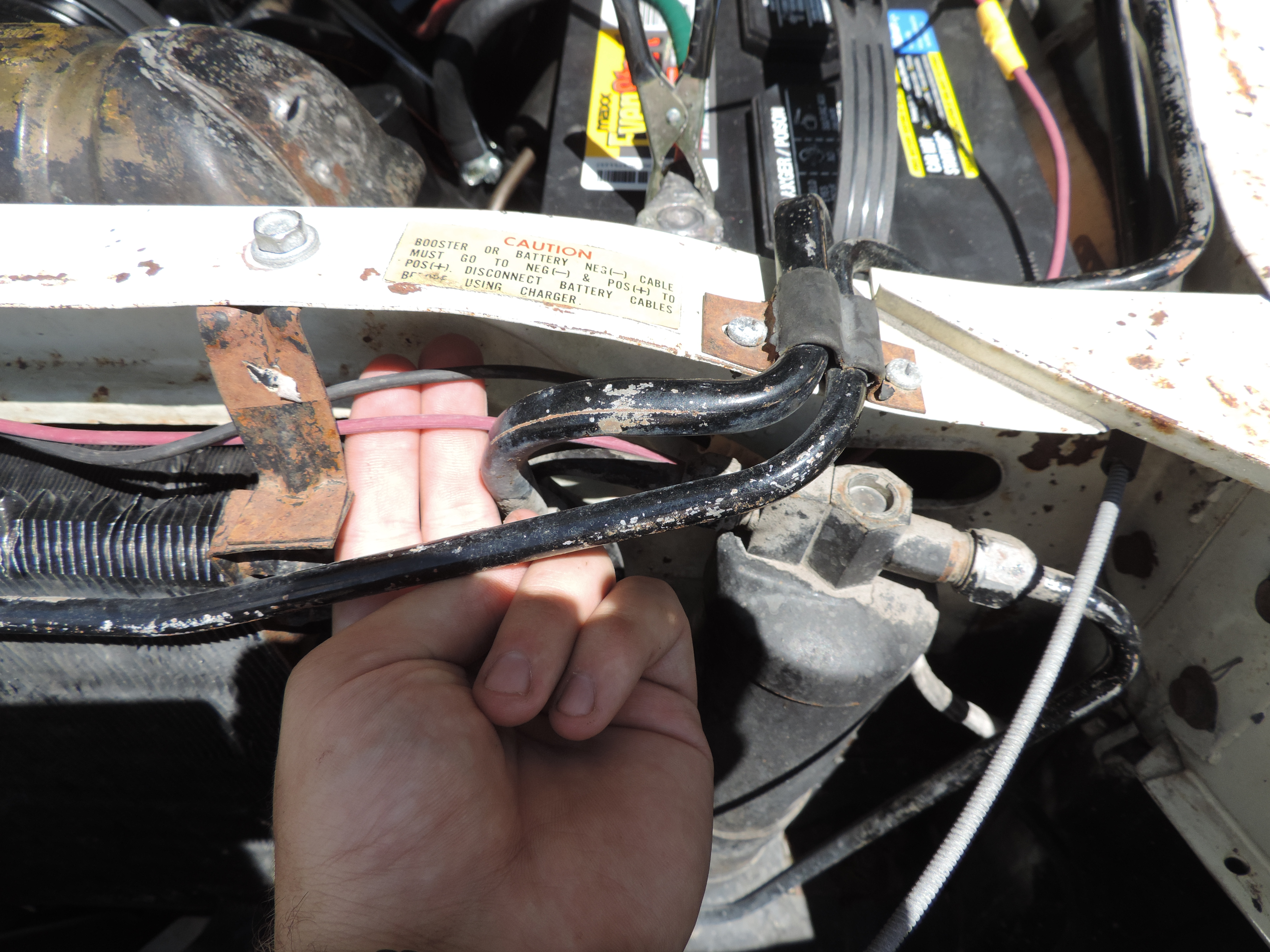

Attached pics of all my connections, that red wire on my battery is a negative it came with the car as red idk why people do that lmfao i dont have the money to change it i have like $2 to my name with no job. the cars stock positive was black, idk if that's original i assume it is. so that gets them questions out of the way in advanced
I described what your looking at in the photos title located bottom left of the photos when you click on them. on the ballast resisters pick there is a white tube thing on the fire wall like 4 inches long what is that some kind of fuse? btw i checked the fuses under my dash all were good
