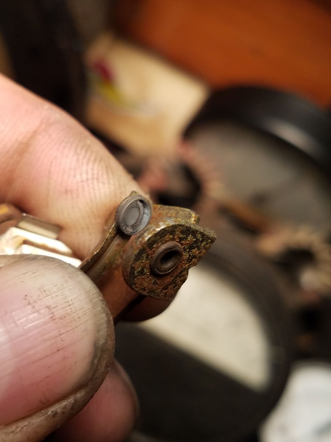

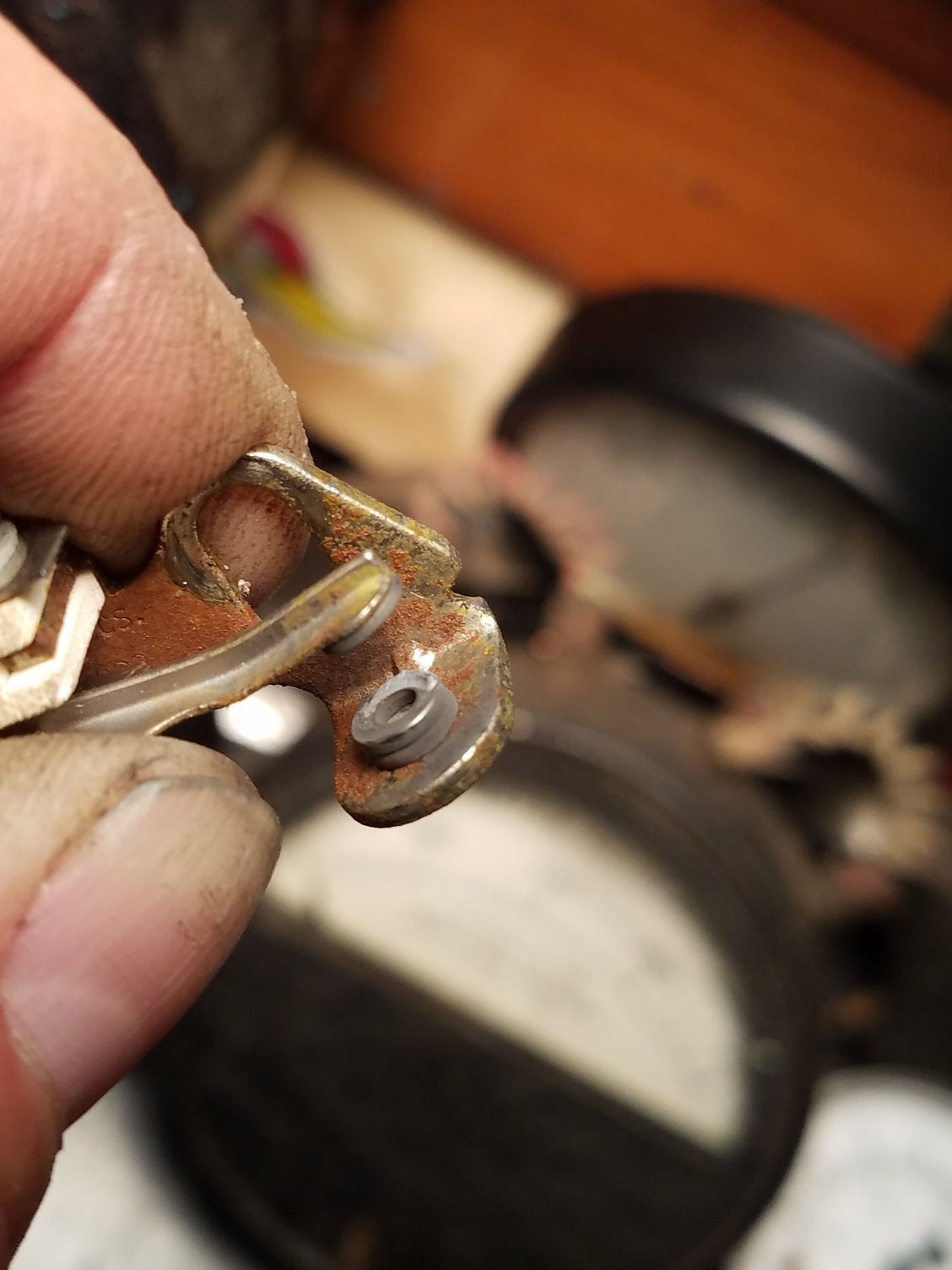

My Mopar guru buddy and I gave "The Ghost" a long overdue tune up on Saturday. Cranked in about 12° of timing and the 383 is running like a Swiss watch. I can hear all 8 pistons popping and my gas mileage has improved. I couldn't believe how burned my points were. It's a wonder the motor ran at all...

The old plugs looked pretty good, light grey but old Champions. I installed Autolite #86's. Old plugs had been in there so many years they had rust on them!
