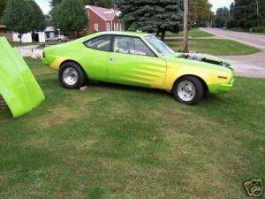

my dad and me are big amc fans got a 77 hornet hatchback and amx hortnet hatchback and a gremlin
Attached Thumbnails 74 hornet 440 727-30066_113238215386650_100001014155429_81299_2220670_n.jpg
