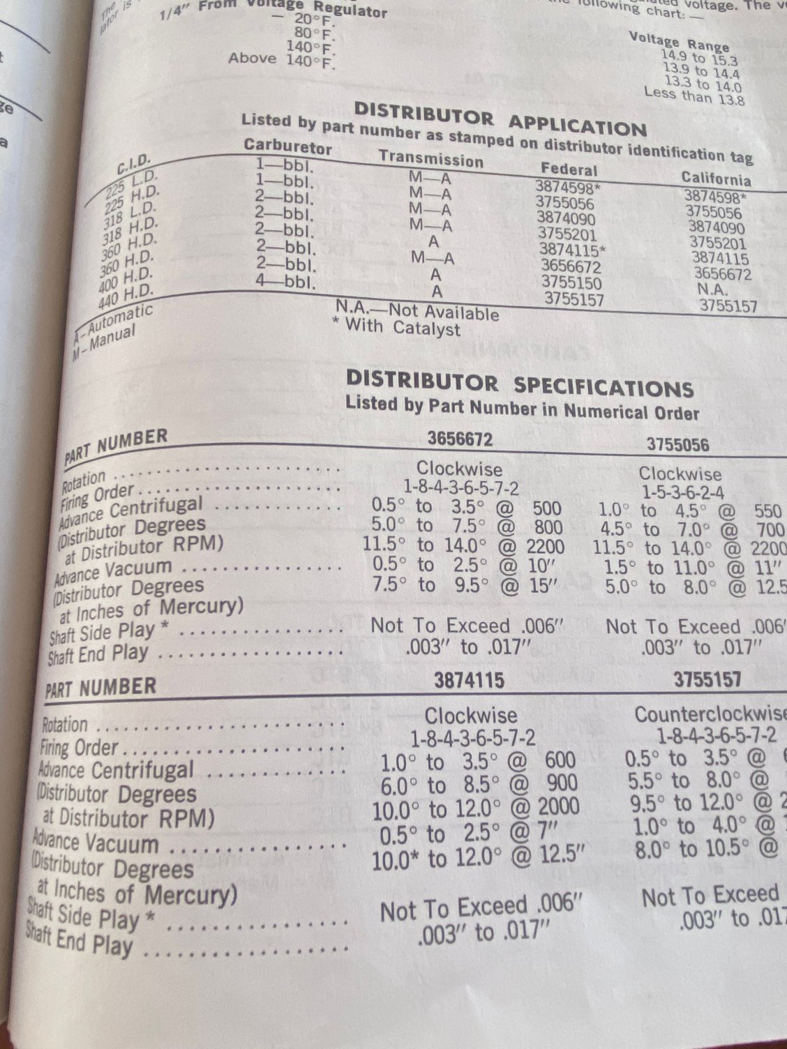

I stopped by the van briefly today with my timing light and determined the initial timing is -8deg at idle and +25 at around 1500ish rpm (I don't have an tach). When I disable the vacuum advance it didn't advance any at the same rpm that the vacuum advance was +25 deg at. Does this indicate a problem with the mechanical advance?

Your problem is off idle in gear which isn't operating under distributor advance. -8 degrees....... A quick reference check says *5 degrees at idle. I wold bump it up to +5
degrees. While at high idle check if the vacuum line going to the distributor has vacuum. If so, connect the hose to the advance and check to see if the engine speeds up and or if the timing jumps ahead with your light.
The change in timing is pointing towards a jumped timing chain. Electronic ignition shouldn't change timing on it's own without some underlying issue, unless the distributor was loose, excessive play in the distributor, or mistake made while setting the timing.

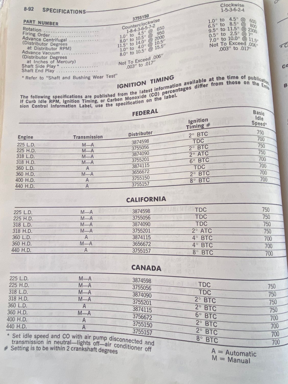

Went back today and determined the timing chain did not seem stretched, timing cover gasket looks new from the outside so I moved to ignition timing. As you said, it should be closer to 5 degrees advanced. I moved it up to 6 degrees as referenced from the workshop manual for this application and the problem went away.
The question became why did it go from driving okay with this timing to driving terrible? The aha moment came when test driving around the block, the first service I did on this van was getting the charging system working. It started having these symptoms afterwards. That should have been a clue, but I wasn’t quite experienced enough to know. I also should have mentioned it in the first post.
The last person to do the ignition timing must have set it when the charging system wasn’t operating. The extra load on the engine was causing the vacuum advance to be too retarded relative to the timing that was set when there was no charging bogging it down. Since higher load=lower vacuum=lower vacuum advance.
