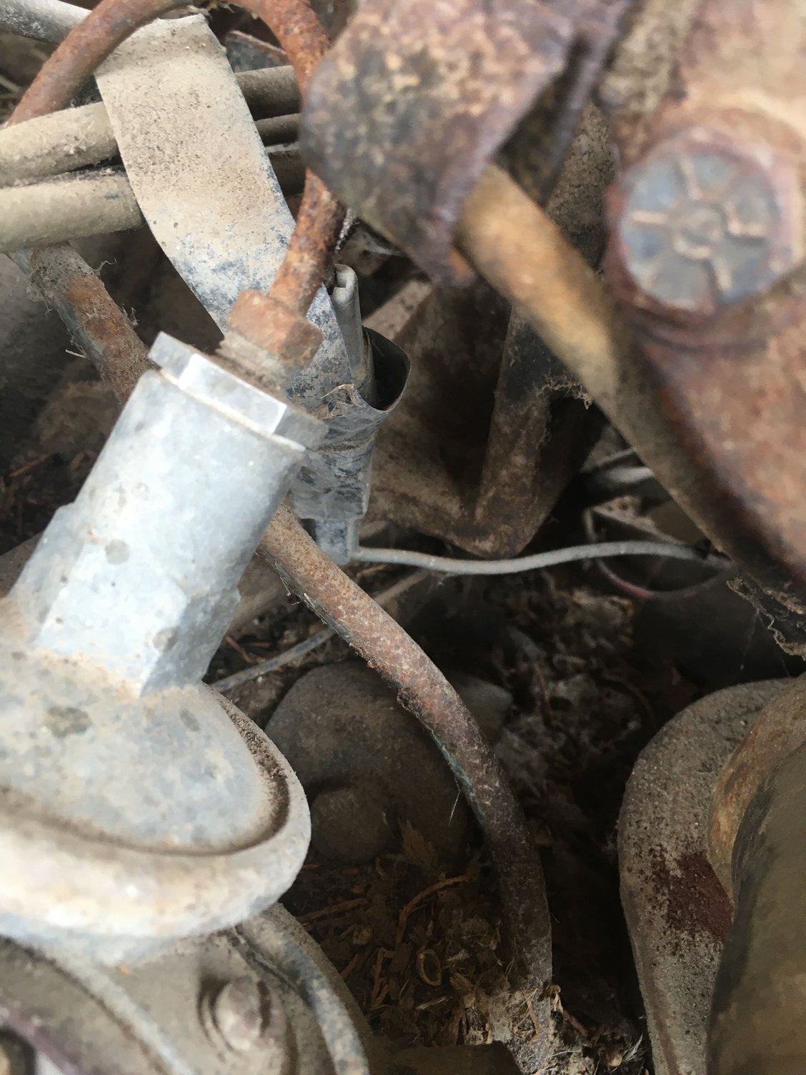

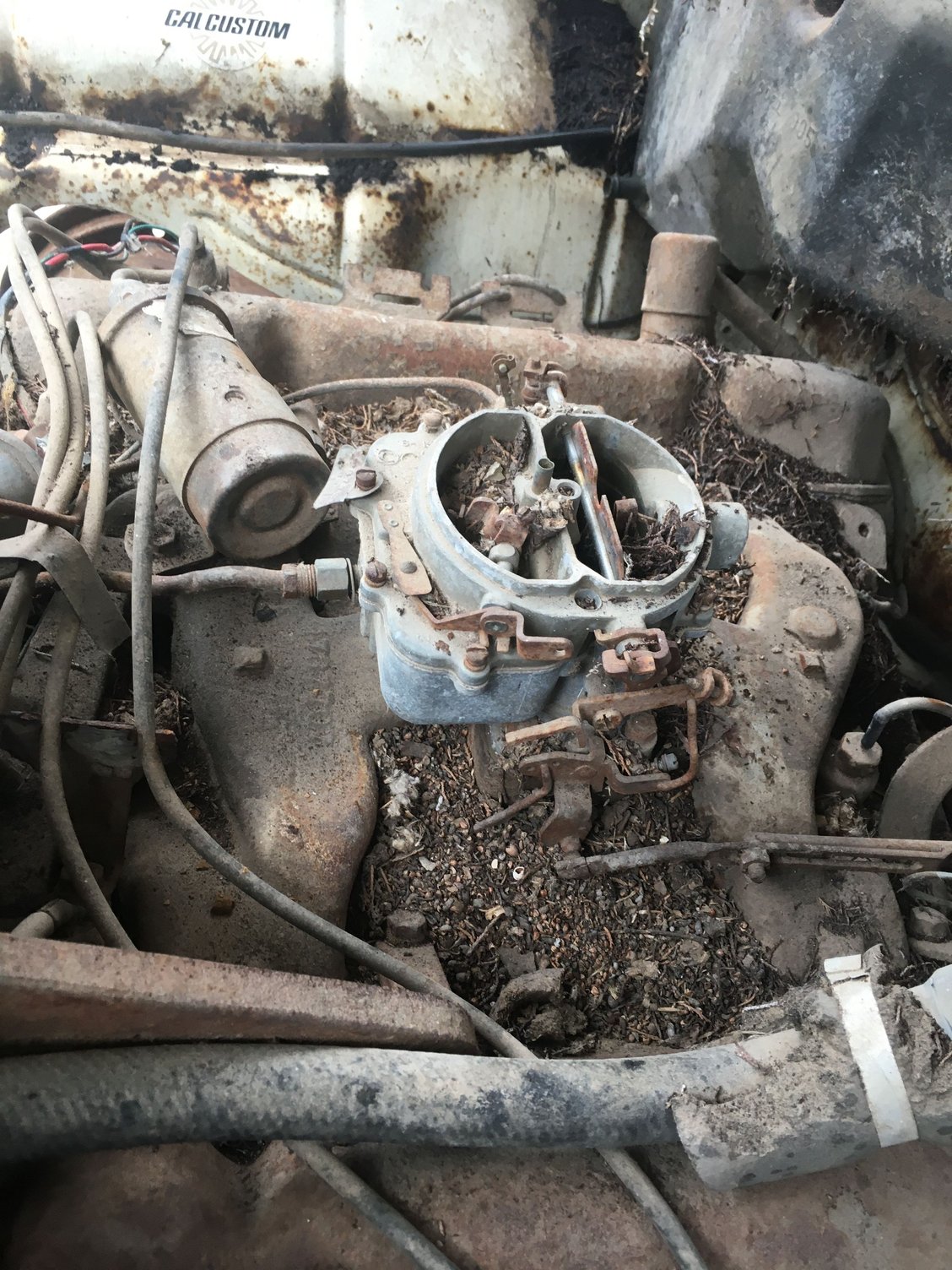

OK folks this is where I need some help. I got the hood up and had a look. Nowhere in the paperwork did it say he ordered the optional 4 barrel, Yet it has a 4 barrel Carter on it. I lost a discussion on a forum where they showed pictures of the difference between the B and RB block. What do you guys make of it? Did Chrysler offer the 4 barrel 383 RB when they ran out of the B block 383‘s as a free upgrade?
I know for a 100% certainty that is the original motor that came in the car when it was built. The original owner was elderly and the previous owner thought it just had a 2 barrel LOL
update: I was told this is a carter 2 barrel. I was freezing and didn't look close enough. Its the same size as the rochester 4gc found on nailheads so I thought it was a 4. Is this still the B block 383?
Old Nov 21, 2019 | 04:13 PM

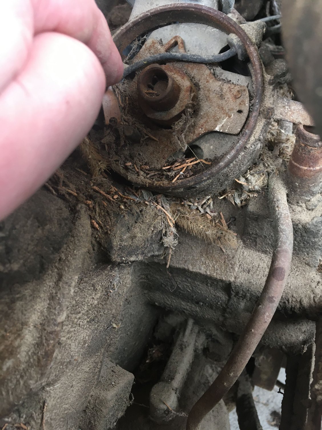

I can't tell from the pictures you have, get a picture of the distributor base and just to the rt of it.
Old Nov 21, 2019 | 04:52 PM
jayzee's Avatar
Joined: Nov 2019
Posts: 23
this is the best picture I could get. The AC compressor is in the way

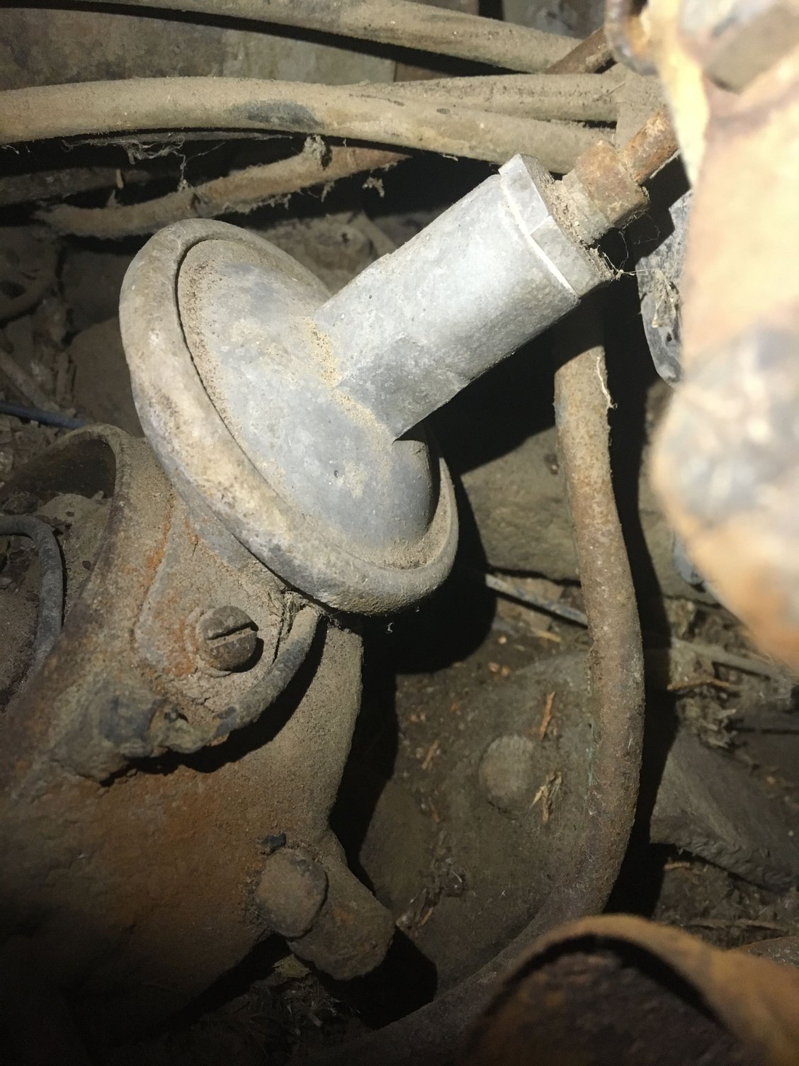

Old Nov 21, 2019 | 08:37 PM
Ok, can you get a picture of the water pump housing at the block?
Old Nov 22, 2019 | 09:15 AM
I cannot tell from those photos ether.....
The Carb is a 2 Barrel Carter / Ball & Ball....
AS for the engine... I think it might be easier to get the casting numbers off the sides of the engine block from under the car. when you get a chance. Just my 2 cents...

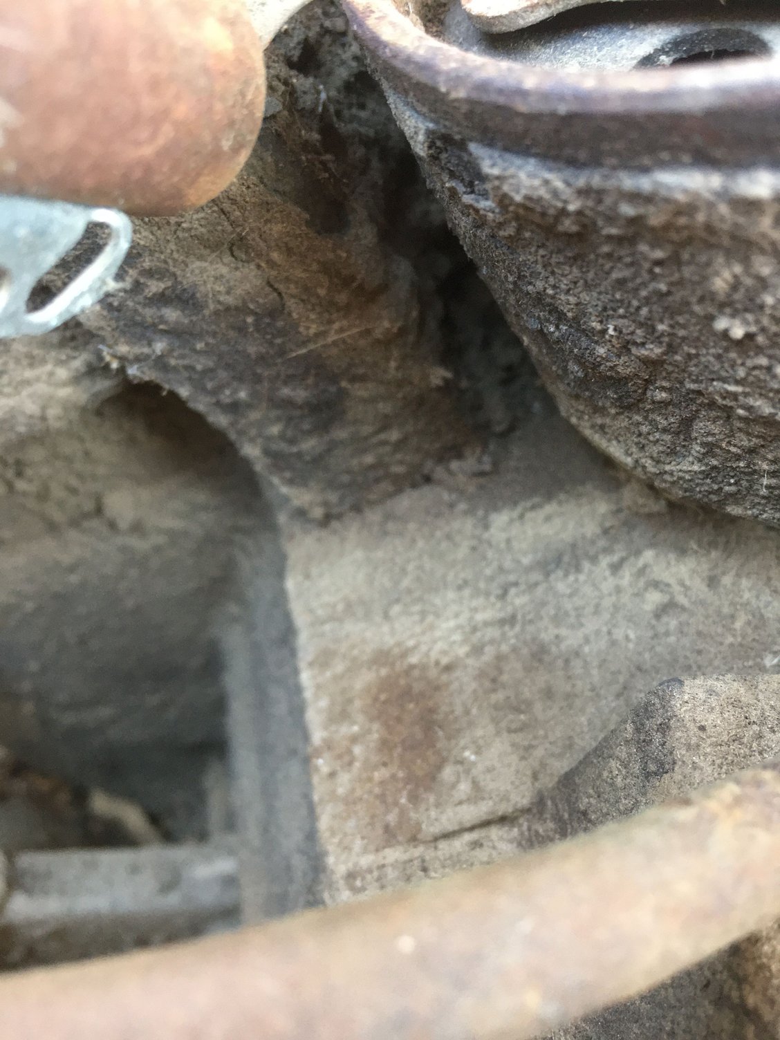

Old Nov 23, 2019 | 12:28 PM
jayzee's Avatar
Joined: Nov 2019
Posts: 23
Hopefully this picture can help. The pad to the left of the distributor is flush with the top of the block and appears to be machined
