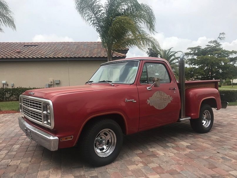

1979 lil red express 360 is having issues with timing
I bought a lil red express with a 360, that the previous owner had "modified" and I am trying to even it out a very rough idle. The last owner put in a purple shaft 284lift/484dur, a Wieand Stealth intake, Edelbrock 750 (which I just replaced with an electric choke 600), long tube headers ,and a set of used J heads.
Now the only way I can start the truck is if the timing is set advanced to 34-36 at idle with a total advance of 44. The idle is very "loopie" and it is hard to start when hot. If the truck is running I can bring the timming back down to 19-20 at idle but no lower and it will run fine at that, however I can not restart it there. I have to bring it back to 34-36 advanced.
Sounds like something is not aligned right (cam, timing chain, ???) when he reassembled the motor. I am not a motor builder but would like to know what I would be getting into to have this fixed.
Any advice?
