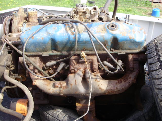

I don't believe they were reverse cooled but the water pump DID mount up on the front of the heads, some people call these a "high mount" pump. Also some of the big truck / heavy motorhome setups had coolant flowing through what is normally the heat crossover ports.
Here is one, probably a 413. Notice the coolant temp sender in the middle of the exhaust
This water pump mounts to the front of the heads making it a "high mount"
