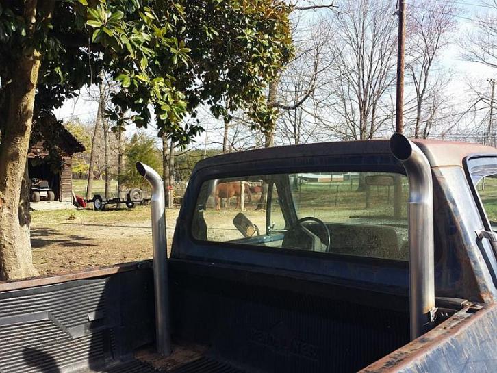

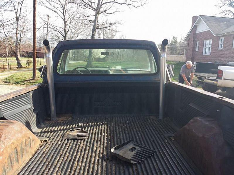

Oh ok... it has to filter the additional sparks going to the plug, I get it. Cool. Well anyway I believe ear/make my own timing mark it will be for the old W250. By the way with the Magnum 5.9 and a 650 carb she is a BEAST! Not to mention I did custom 3" stacks up through the bed with glass packs.

Old Apr 2, 2014 | 01:14 PM
That should "talk" pretty good....
You Do know I'm a truck guy.. I like it alot
