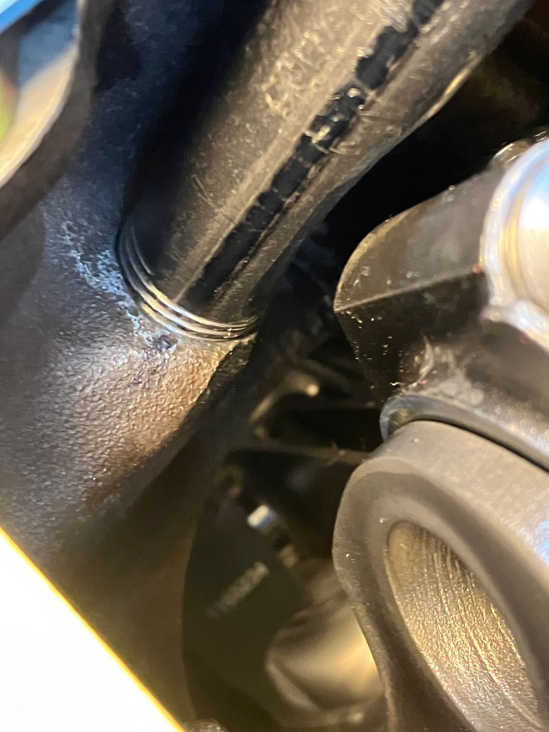

I'm in the process of building a 505 inch stroker motor. I'm using a Callies Compstar crank and rods. Bottom end has a Hughes girdle (1/4" th), a windage tray, and a 7" deep pan. My oil pickup is a 1/2" inlet, but it's about 25 yrs old and I don't know the specific make (I would guess it is an old Milidon piece). I have two problems:
1. The #1 rod is hitting the pickup tube just above the threaded portion. The threaded end of the tube has a bigger OD than the tube itself and is welded to the tube so possibly a newer version might have a smaller OD in that area.
2. With the girdle in place, the pickup tube can't be screwed the whole way in. It hits the windage tray two turns before being completely seated preventing it from being fully screwed in.
So, I need a pickup tube with a smaller OD just above the threads and the bend occurring further down the tube to allow it to clear the windage tray when being installed.

I think I've figured out what I'm going to do. I'm going to get a long 1/2' sch 40 pipe nipple and screw it into the block and check for clearance with the #1 rod (should clear but if not there is enough wall thickness to grind it down where the interference occurs), Then with some careful measuring, I'll cut the threaded end off the exiting pickup tube, cut the nipple to the correct length, be sure they are indexed properly and weld the two together. Should cost about $6 for the nipple (a lot cheaper than a new pickup tube that might not fit right anyhow).

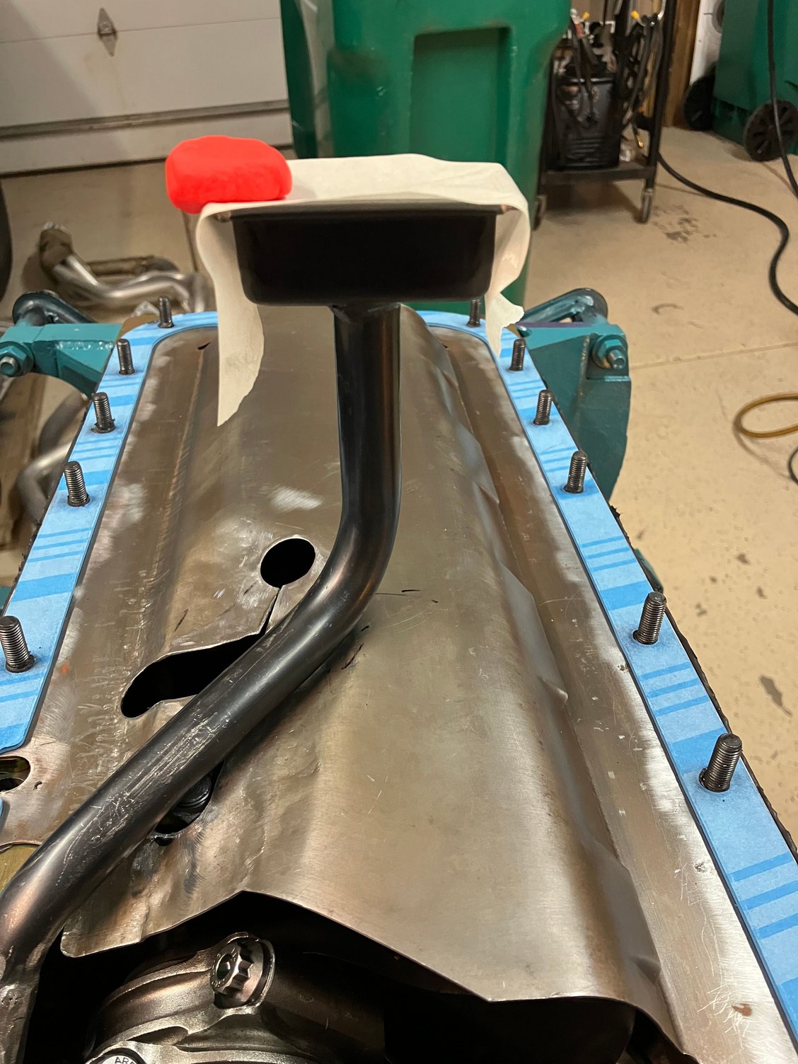

Update
Finally got it fixed.

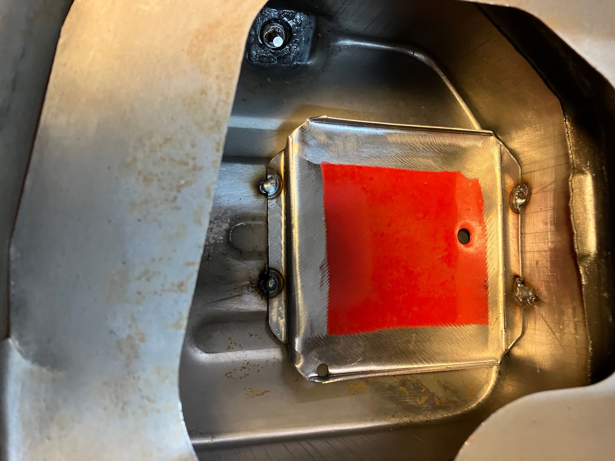

Cut the bottom off the pickup tube and welded on a piece of schedule 40 pipe (has more wall thickness to work with). Ground away and have plenty of clearance now. During fit up I discovered through my careful measurements and the magic of trigonometry that I screwed up and made it a little too short (had 5/8" clearance from pickup to bottom of pan). I didn't want to hack anymore on the pickup tube so I fabed up a little false bottom to put inside the pan to bring the clearance down to 3/8". All is well. Note how I had to beat the snot out of the windage tray to allow install of the pickup tube and to clear #3 rod.
