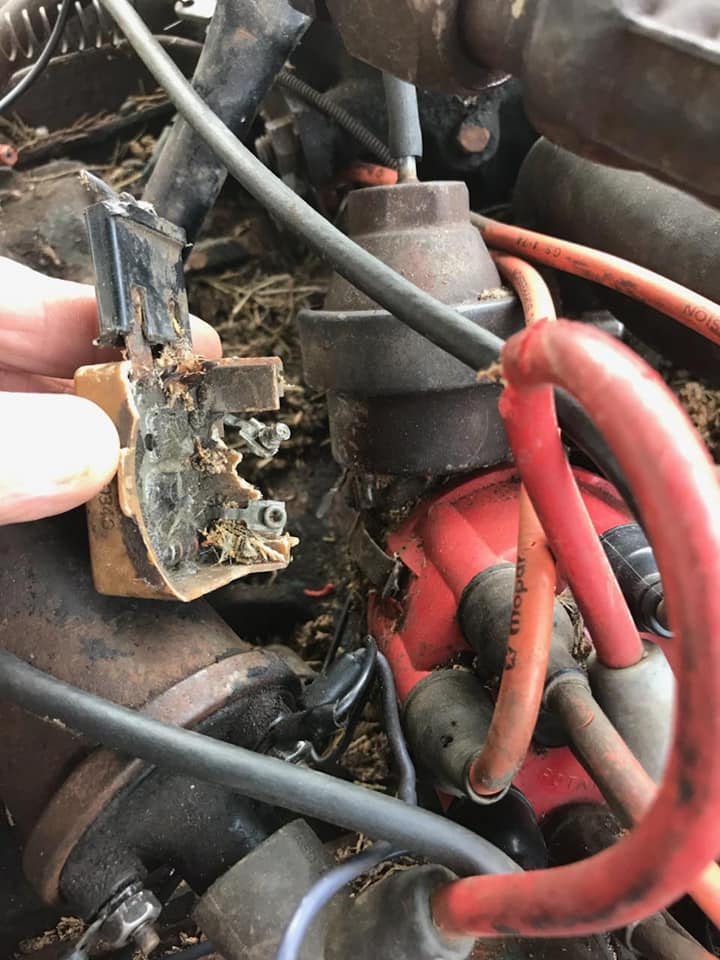

Can someone tell me what this is? Some type of module?
Old Jul 27, 2018 | 12:23 PM
Jake Smith's Avatar
Joined: Jul 2018
Working to get this 1970 Chrysler 383 running. We have fire to the points, but it still won't hit. Found this random module/regulator that was all chewed up, but we can't figure out what it is. Any ideas?
Attached Thumbnails Can someone tell me what this is? Some type of module?-37841859_10212408215030680_2315644386576171008_n.jpg   Can someone tell me what this is? Some type of module?-37909519_10212408214470666_3483821653673115648_n.jpg
Old Jul 27, 2018 | 09:11 PM
That is an electronic distributor vacuum advance delay.... Its for emission control.... You can replace it with another one... Just hide the connector way....
