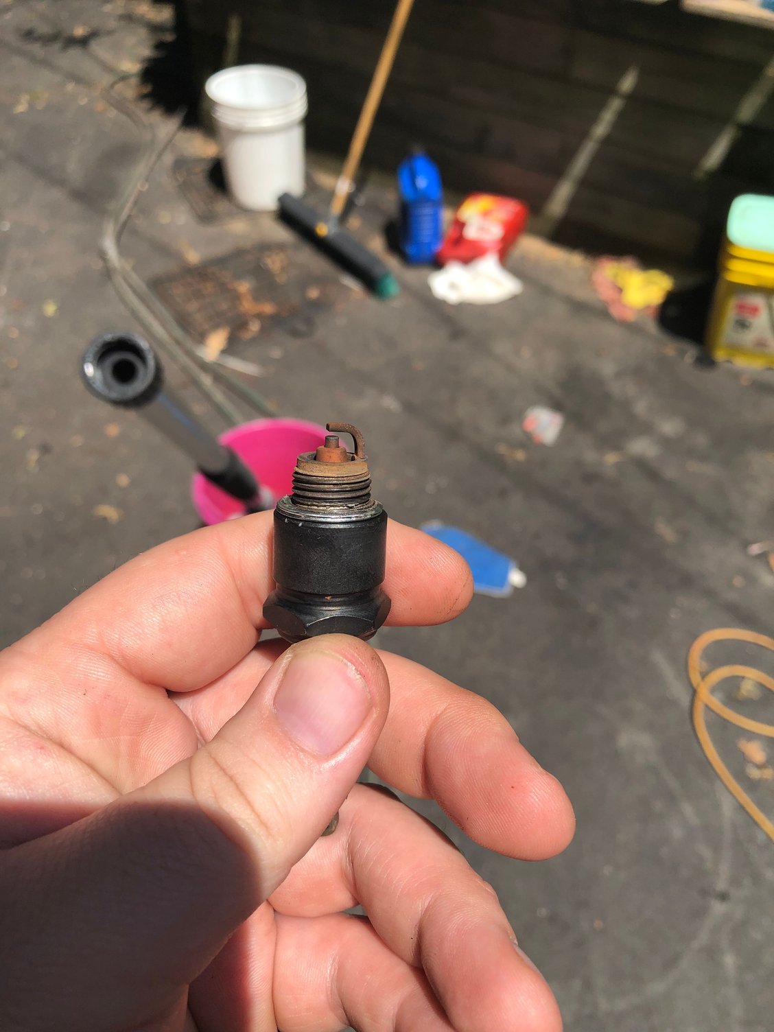

I don稚 know John I知 fairly new to this forum I feel like it may be a little rich the spark plug looks good it痴 not black or wet also the motor is .30 over and what not I want to put a fi tech fuel injection on it over the winter but I知 just trying to get it ok for the rest of the summer also have a hard time getting a timing light on it as the alternator is right in the way

This is the plug it痴 maybe a week old

You're right the plug looks good.
