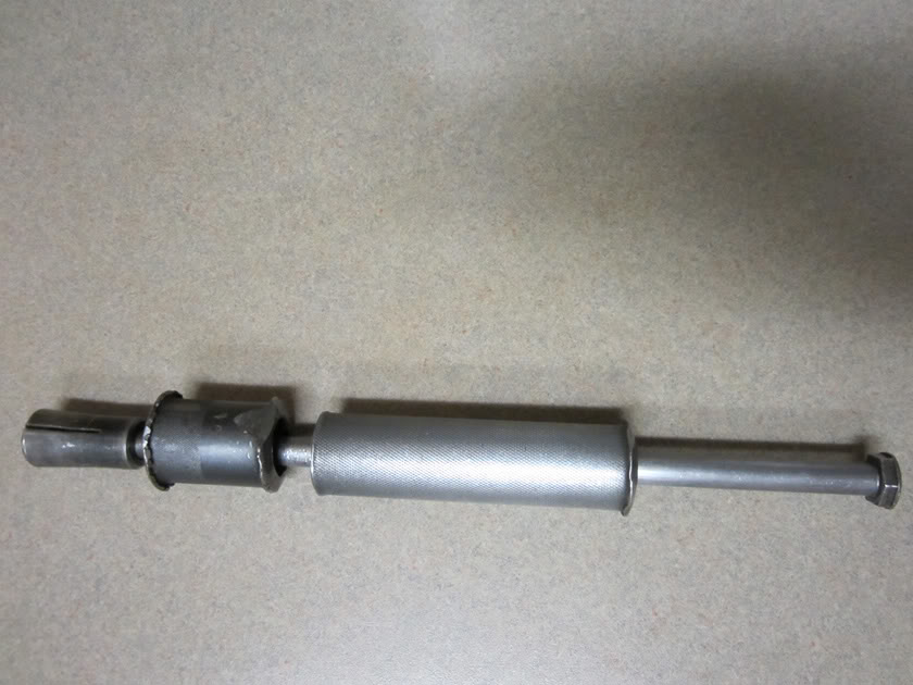

What is this used for?

cam bearing remover or installer

collet/dowel pin remover?

Dowel pin remover it is. Put the right size end on it. Put it over the dowel pin and pound the collar over the end. The one quick move of the handle the other way and up and out comes the dowel pin.
