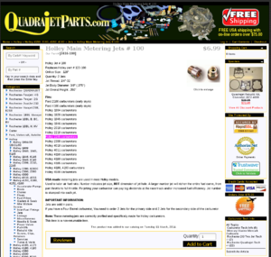

If not, I came a cross a site that list replacement jets for the 2245 but, only in one size which is #100. Assume the numbering system is the same thats quite a step up (Also assuming the larger the number the richer the mixture, I know nothing about this level of tuning). Would that richen the carb or is it's lean nature engineered into the whole thing?

Only true way find out is to measure it.... Tail Pipe sniffer or a wide band 02..
The other ways are just a crap shoot.
