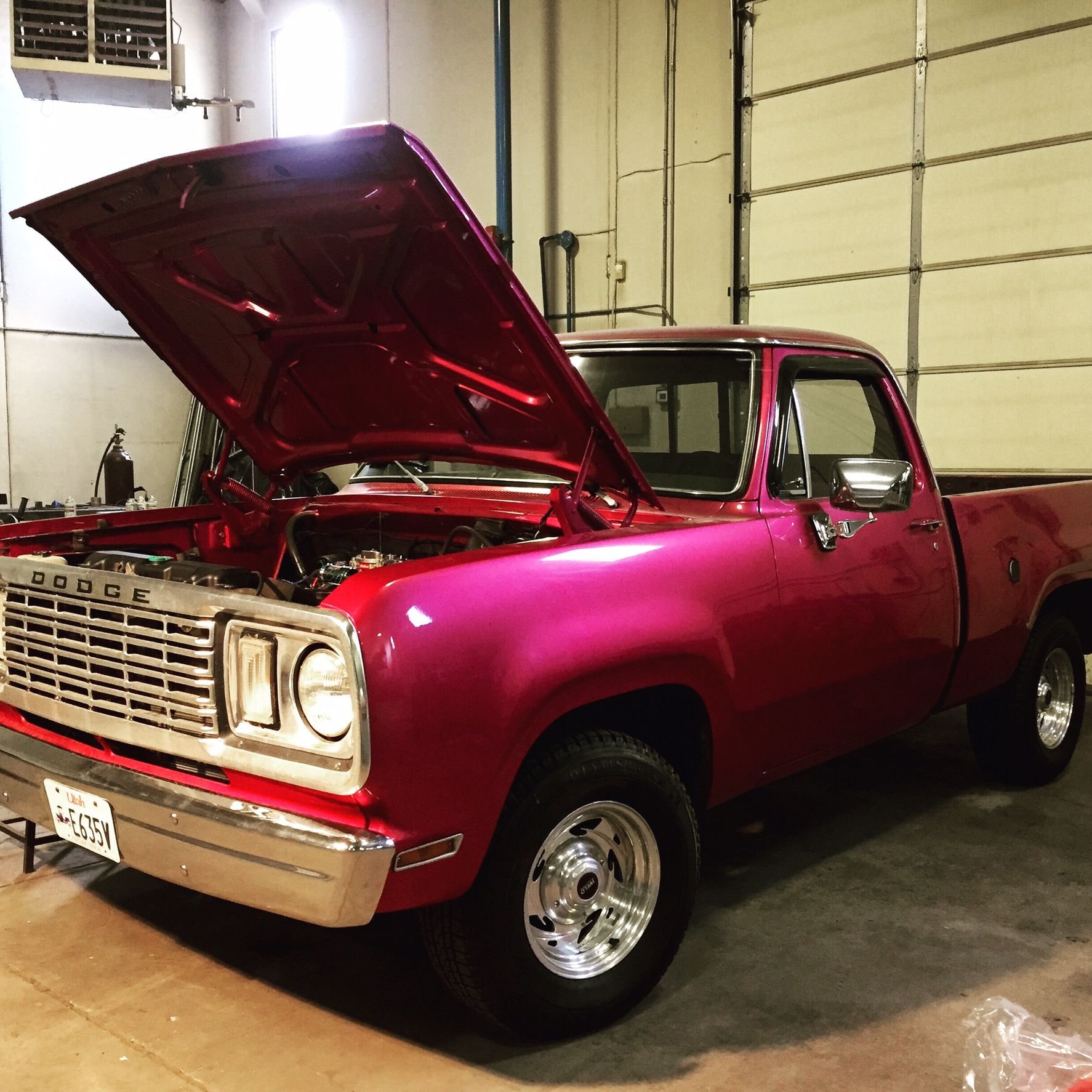

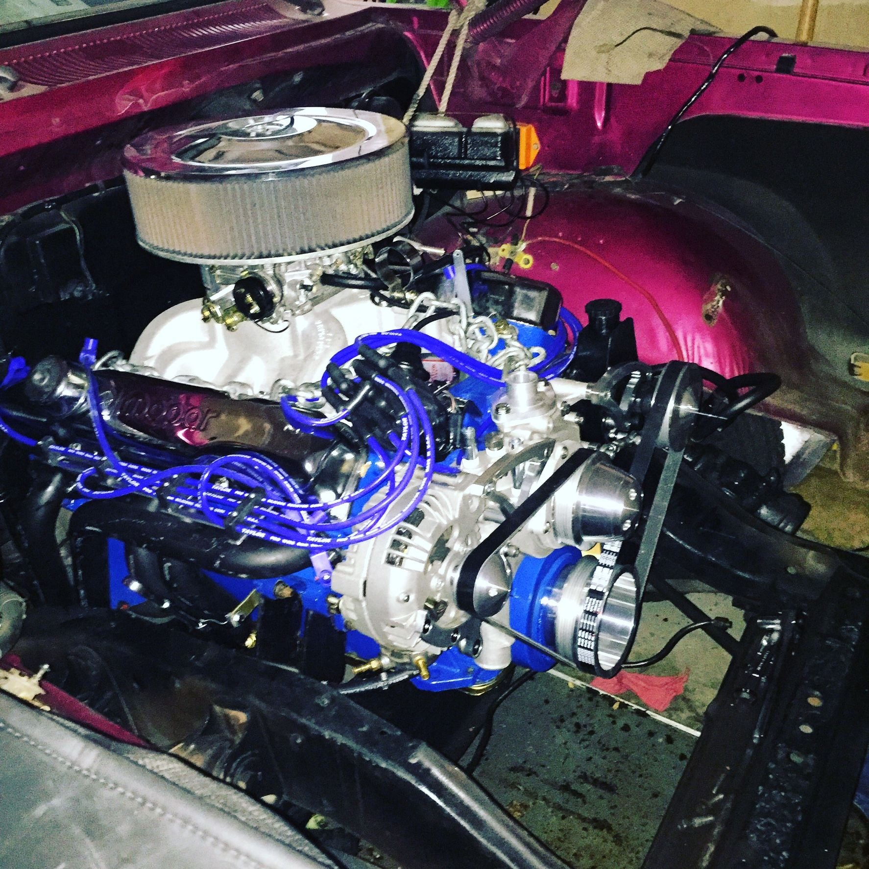

Get the right converter in it and it should be a ripper, haven't seen any pictures in a while how about putting a few up for us?

I want to do something else with the wheels and tires but I’m still not sure what I want to do.
This is when I just dropped it in
Old Sep 18, 2019 | 09:39 PM
Looks great!👍

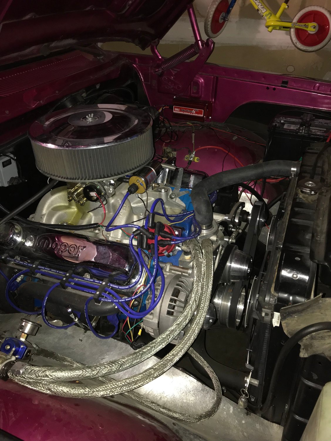

This was just this morning, I still need to do the exhaust and I’m going to drop it 2”
